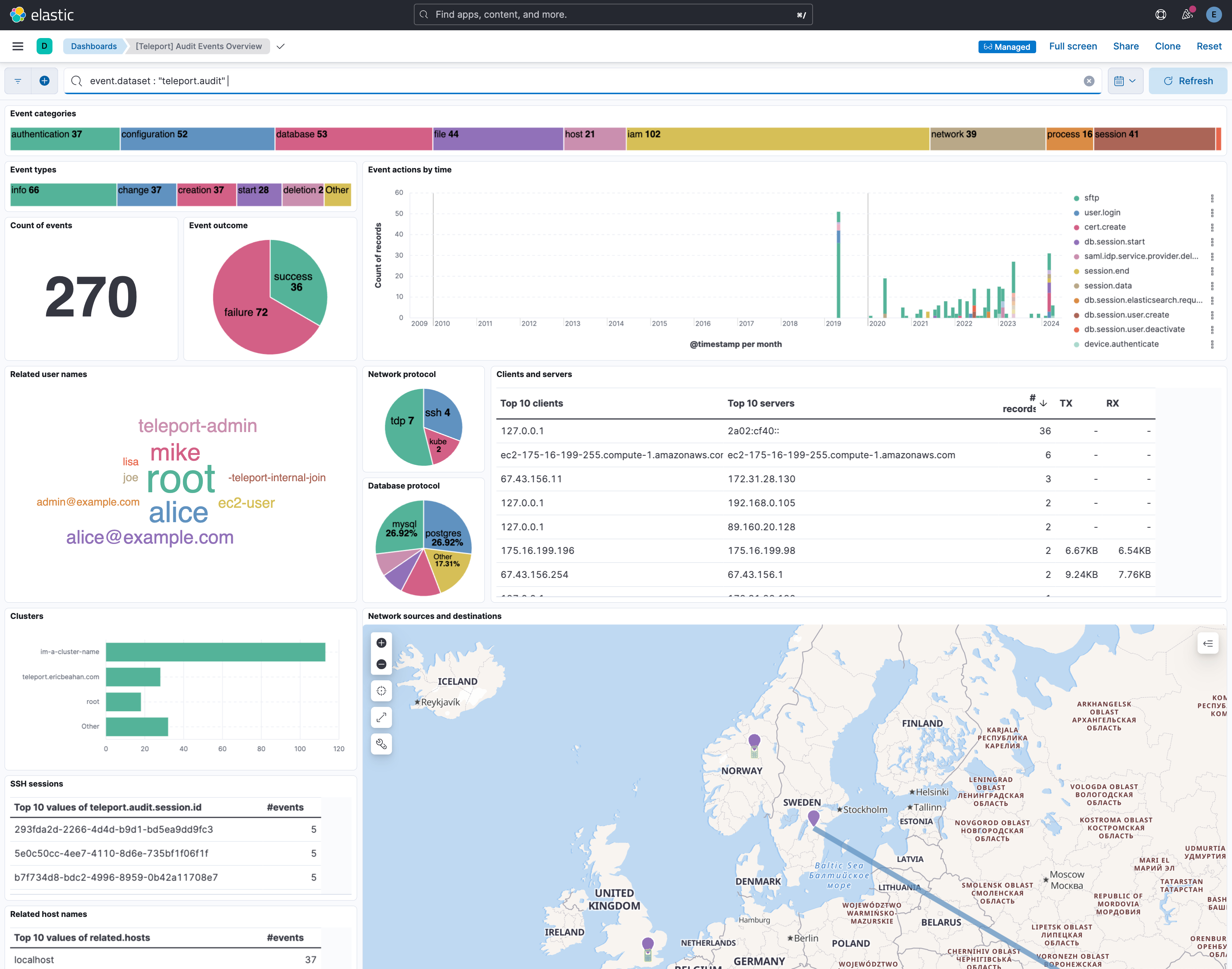

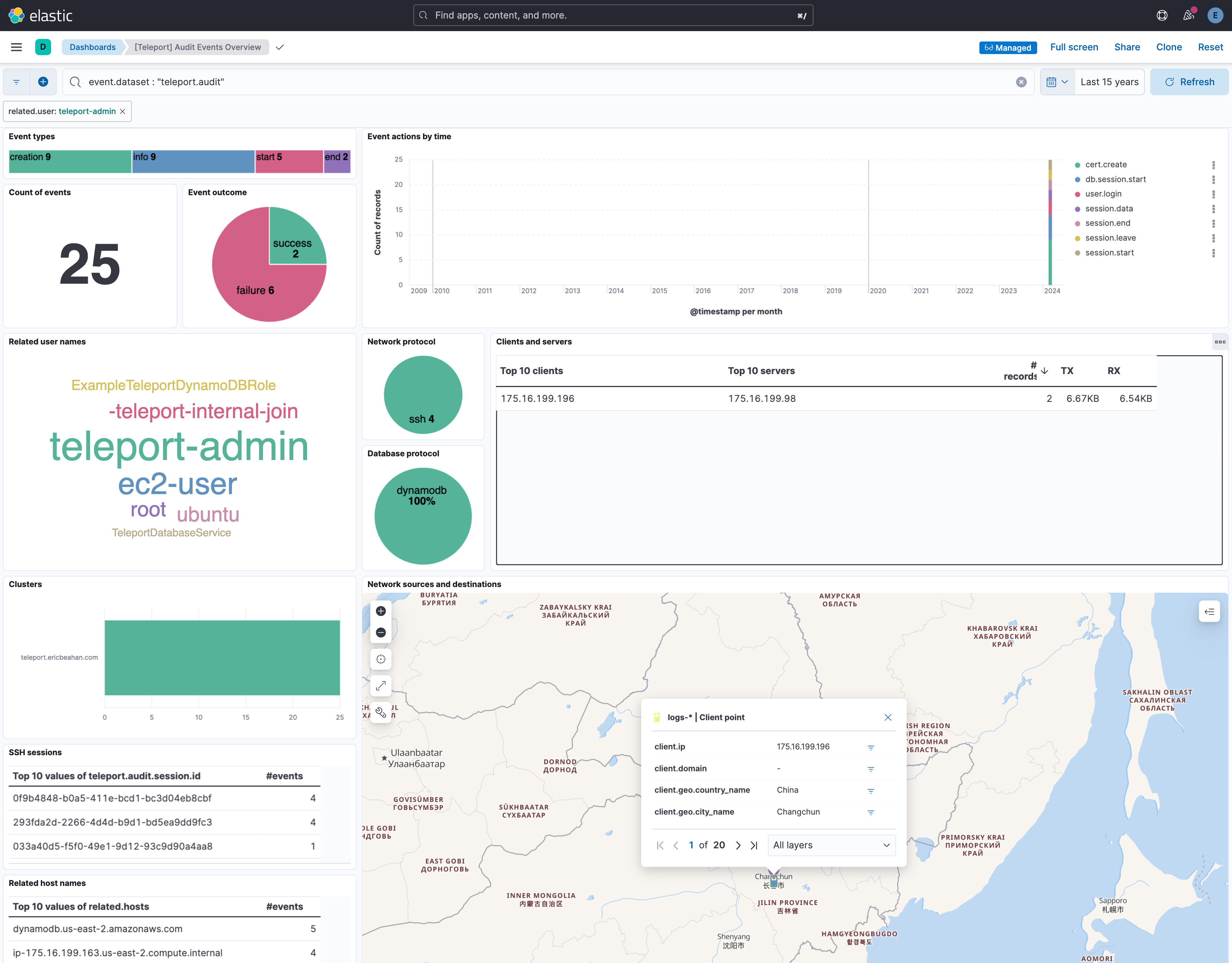

This integration ingests audit events from Teleport. You can use it to perform historical analysis, detect unusual behavior, and form a better understanding of how users interact with your Teleport cluster.
Use this integration to collect and parse audit event logs from various events supported by Teleport. Then visualize that data in Kibana using the included dashboard, create alerts to notify you if something goes wrong, and reference logs when troubleshooting an issue.
For example, you can filter for failed authorization events and examine the graph of the number of these attempts by time, as well as such data points as the geographical location of clients and related user names.
