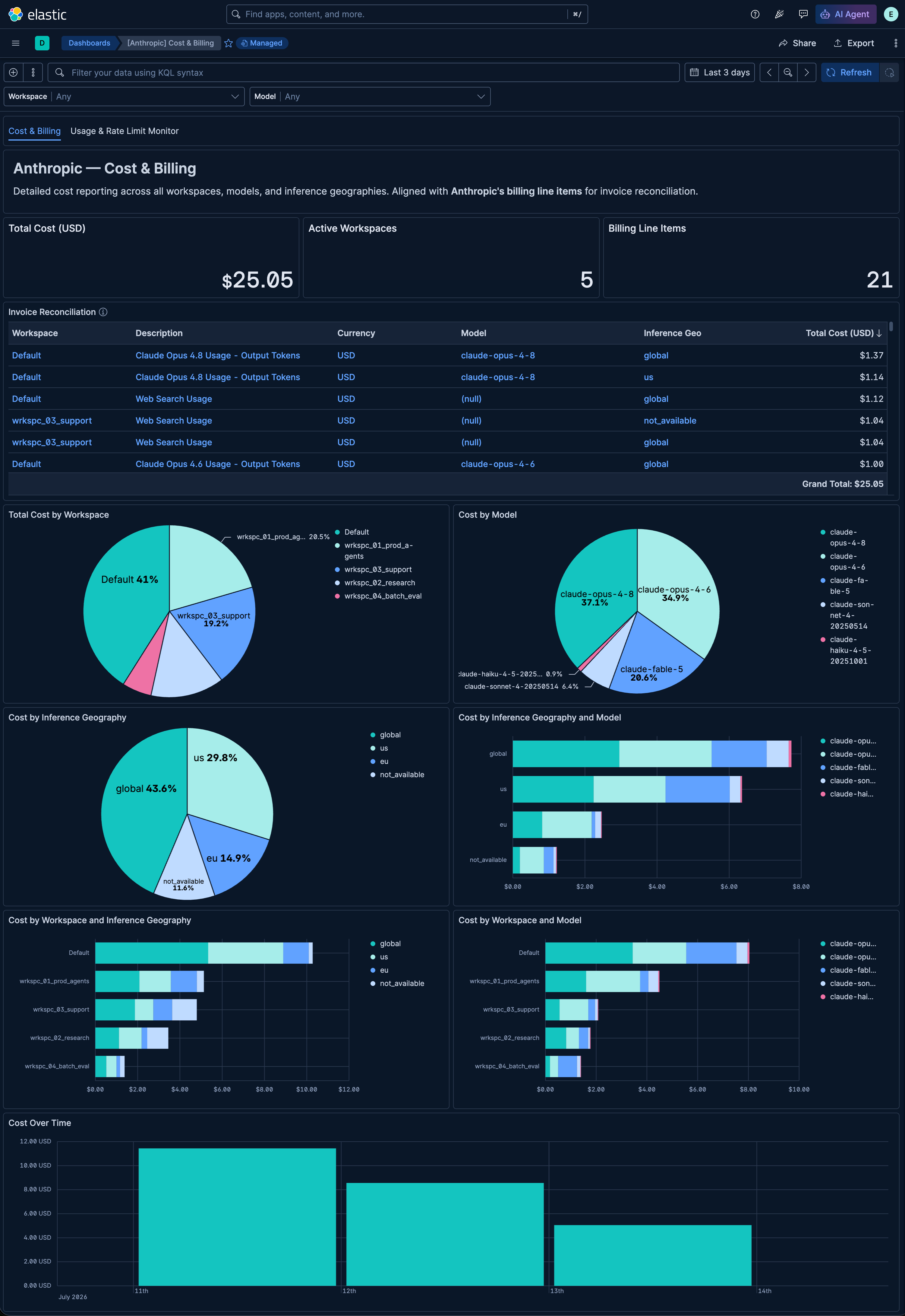

Daily cost data (amounts reported by the API in lowest units (eg cents)):
- Token usage costs, web search costs, and code execution costs
- Breakdowns by workspace and description (includes model and inference geography)

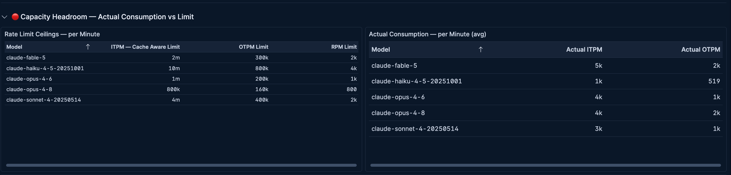

- Requests per minute (RPM), input tokens per minute (ITPM), output tokens per minute (OTPM)
- Model group membership and batch request limits
- Token usage monitoring: Track consumption trends across models and workspaces
- Cost management: Monitor daily spend and allocate costs by workspace
- Capacity planning: Compare rate limits against actual consumption to prevent throttling
- Finance reporting: Export usage and cost data for billing reconciliation

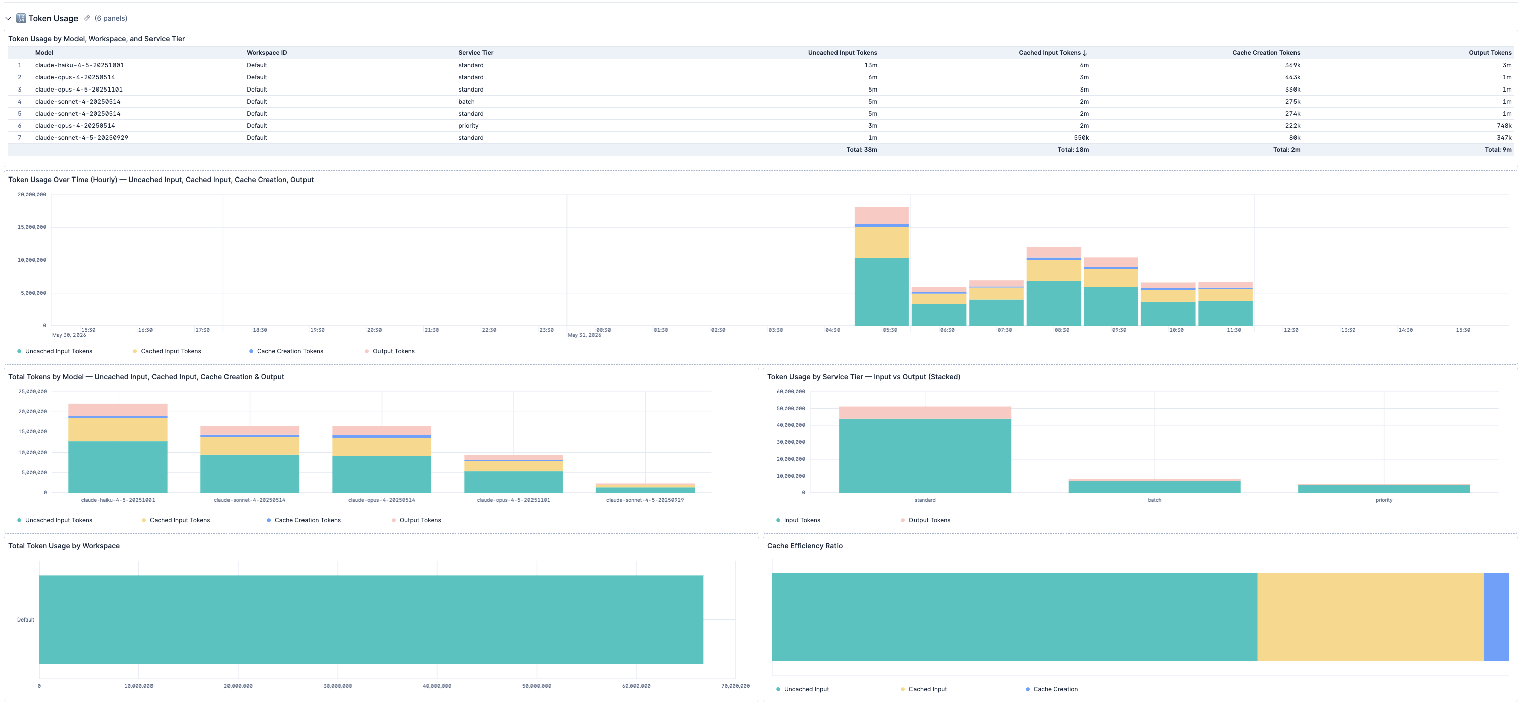

The usage data stream collects token usage metrics from the Anthropic Usage API.
Exported fields
| @timestamp | Date/time when the event originated. This is the date/time extracted from the event, typically representing when the event was generated by the source. If the event source has no original timestamp, this value is typically populated by the first time the event was received by the pipeline. Required field for all events. | date |
| anthropic.usage.api_key_id | API key identifier when grouped by api_key_id. | keyword |
| anthropic.usage.bucket_end_time | End time of the usage bucket. | date |
| anthropic.usage.bucket_start_time | Start time of the usage bucket. | date |
| anthropic.usage.cache_creation_input_tokens | Cache creation input tokens consumed in the bucket. | long |
| anthropic.usage.cached_input_tokens | Cached input tokens consumed in the bucket. | long |
| anthropic.usage.context_window | Context window size when grouped by context_window. | keyword |
| anthropic.usage.inference_geo | Inference geography when grouped by inference_geo. | keyword |
| anthropic.usage.model | Claude model name for the bucket. | keyword |
| anthropic.usage.output_tokens | Output tokens generated in the bucket. | long |
| anthropic.usage.service_tier | Service tier for the bucket (e.g. standard). | keyword |
| anthropic.usage.speed | Speed tier when grouped by speed. | keyword |
| anthropic.usage.uncached_input_tokens | Uncached input tokens consumed in the bucket. | long |
| anthropic.usage.workspace_id | Workspace identifier for the bucket. | keyword |
| data_stream.dataset | The field can contain anything that makes sense to signify the source of the data. Examples include nginx.access, prometheus, endpoint etc. For data streams that otherwise fit, but that do not have dataset set we use the value "generic" for the dataset value. event.dataset should have the same value as data_stream.dataset. Beyond the Elasticsearch data stream naming criteria noted above, the dataset value has additional restrictions: * Must not contain - * No longer than 100 characters |
constant_keyword |
| data_stream.namespace | A user defined namespace. Namespaces are useful to allow grouping of data. Many users already organize their indices this way, and the data stream naming scheme now provides this best practice as a default. Many users will populate this field with default. If no value is used, it falls back to default. Beyond the Elasticsearch index naming criteria noted above, namespace value has the additional restrictions: * Must not contain - * No longer than 100 characters |
constant_keyword |
| data_stream.type | An overarching type for the data stream. Currently allowed values are "logs" and "metrics". We expect to also add "traces" and "synthetics" in the near future. | constant_keyword |
| event.dataset | Name of the dataset. If an event source publishes more than one type of log or events (e.g. access log, error log), the dataset is used to specify which one the event comes from. It's recommended but not required to start the dataset name with the module name, followed by a dot, then the dataset name. | constant_keyword |
| event.module | Name of the module this data is coming from. If your monitoring agent supports the concept of modules or plugins to process events of a given source (e.g. Apache logs), event.module should contain the name of this module. |
constant_keyword |
| input.type | Type of input that generated the event. | keyword |

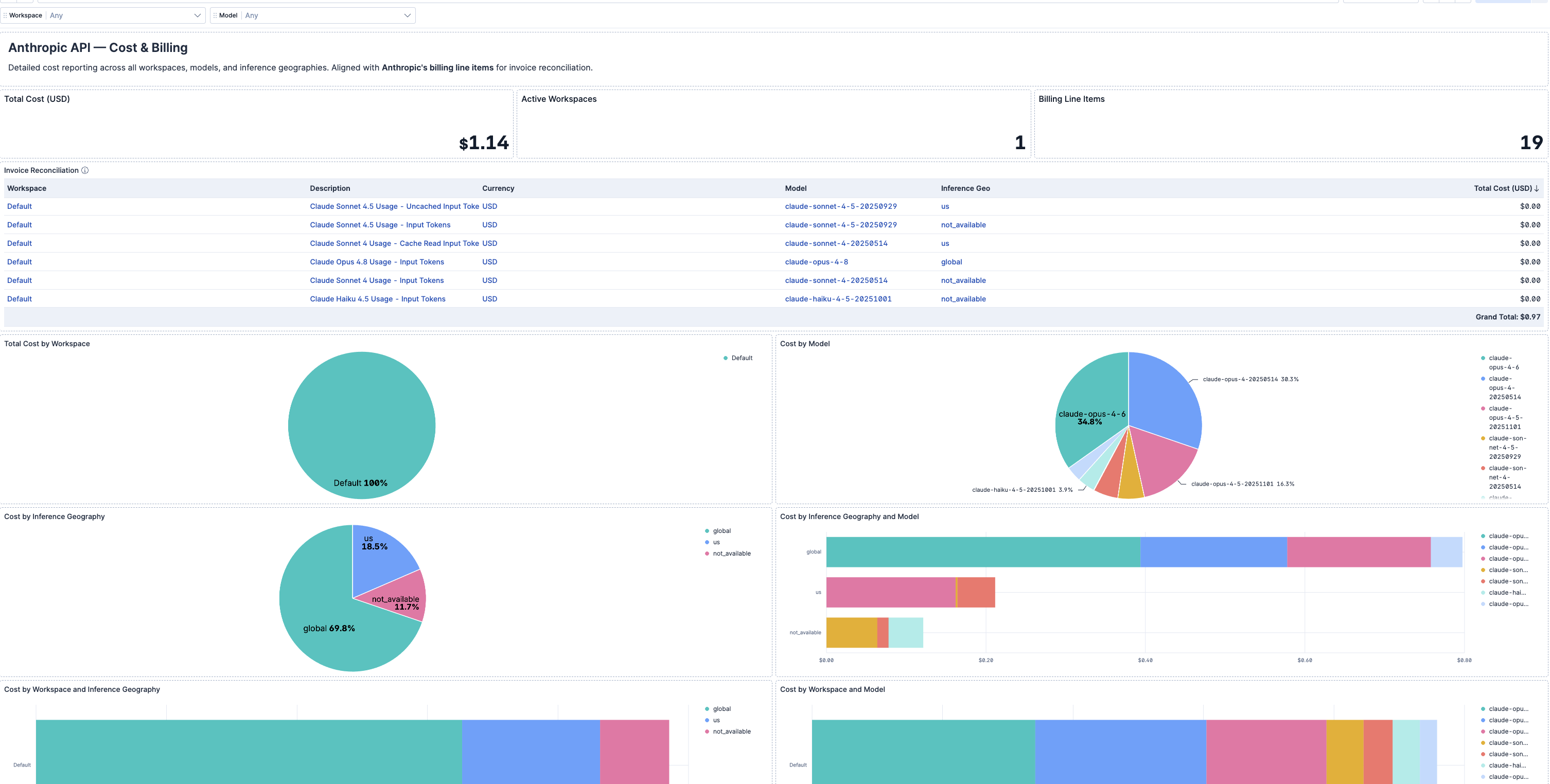

The cost data stream collects daily cost data from the Anthropic Cost API.
Exported fields
| anthropic.cost.amount | Cost amount in lowest units (e.g. cents) as returned by the Anthropic API. | double |
| anthropic.cost.bucket_end_time | End time of the cost bucket. | date |
| anthropic.cost.bucket_start_time | Start time of the cost bucket. | date |
| anthropic.cost.context_window | Context window used (e.g. 0-200k, 200k-1M). Available when grouped by description. | keyword |
| anthropic.cost.cost_type | Type of cost (e.g. tokens, web_search, code_execution, session_usage). Available when grouped by description. | keyword |
| anthropic.cost.currency | Currency code for the cost amount (e.g. USD). | keyword |
| anthropic.cost.description | Cost line description (e.g. model usage, Web Search Usage). | keyword |
| anthropic.cost.inference_geo | Inference geography for the cost item (e.g. global, us, not_available). Available when grouped by description. | keyword |
| anthropic.cost.model | Model name for the cost item. Available when grouped by description. | keyword |
| anthropic.cost.service_tier | Service tier for the cost item (e.g. standard, batch). Available when grouped by description. | keyword |
| anthropic.cost.token_type | Type of token (e.g. uncached_input_tokens, output_tokens, cache_read_input_tokens). Available when grouped by description. | keyword |
| anthropic.cost.workspace_id | Workspace identifier for the bucket. | keyword |
constant_keyword |
constant_keyword |
constant_keyword |

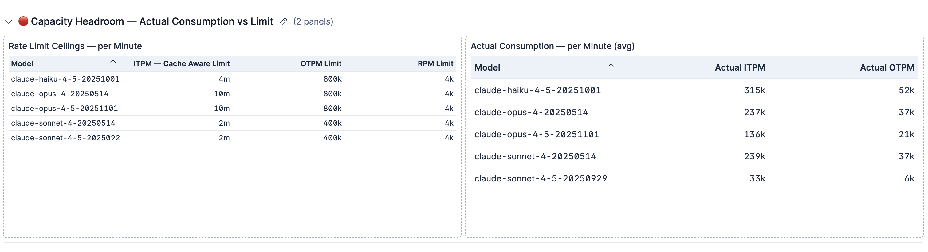

The rate_limit data stream collects rate limit configuration from the Anthropic Rate Limits API.
Exported fields
| anthropic.rate_limit.enqueued_batch_requests | Maximum enqueued batch requests allowed. | long |
| anthropic.rate_limit.group_type | Rate limit group type (e.g. model_group, batch, token_count). | keyword |
| anthropic.rate_limit.input_tokens_per_minute | Maximum input tokens per minute allowed for the model group. | long |
| anthropic.rate_limit.input_tokens_per_minute_cache_aware | Maximum cache-aware input tokens per minute for the model group. Only uncached and cache-creation tokens count against this limit; cache-read tokens are excluded for most models. | long |
| anthropic.rate_limit.limits.type | Limit metric type (e.g. requests_per_minute, input_tokens_per_minute). | keyword |
| anthropic.rate_limit.limits.value | Limit value for the metric type. | long |
| anthropic.rate_limit.models | Model names included in the group when group_type is model_group (array of keywords). | keyword |
| anthropic.rate_limit.output_tokens_per_minute | Maximum output tokens per minute allowed for the model group. | long |
| anthropic.rate_limit.requests_per_minute | Maximum requests per minute allowed for the model group. | long |
| anthropic.rate_limit.type | Object type (rate_limit). | keyword |
constant_keyword |
constant_keyword |
constant_keyword |
