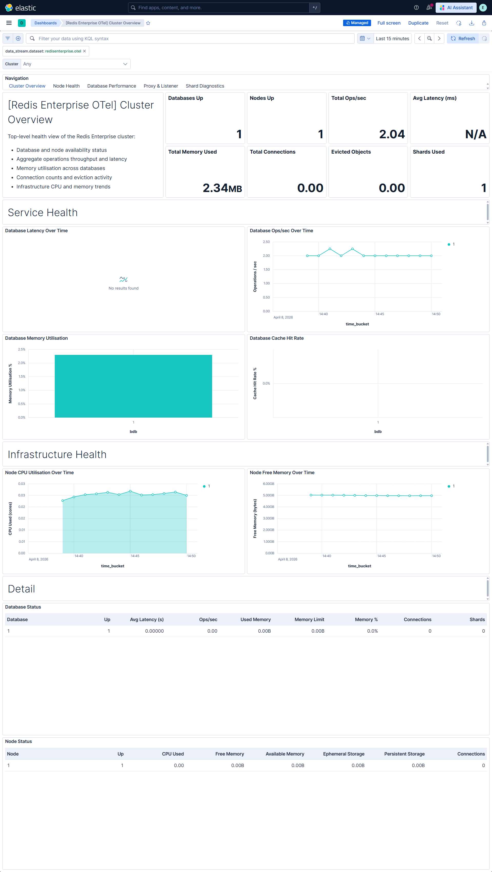

| [Redis Enterprise OTel] Cluster Overview | High-level health and performance overview covering database status, node infrastructure, and key operational KPIs. |

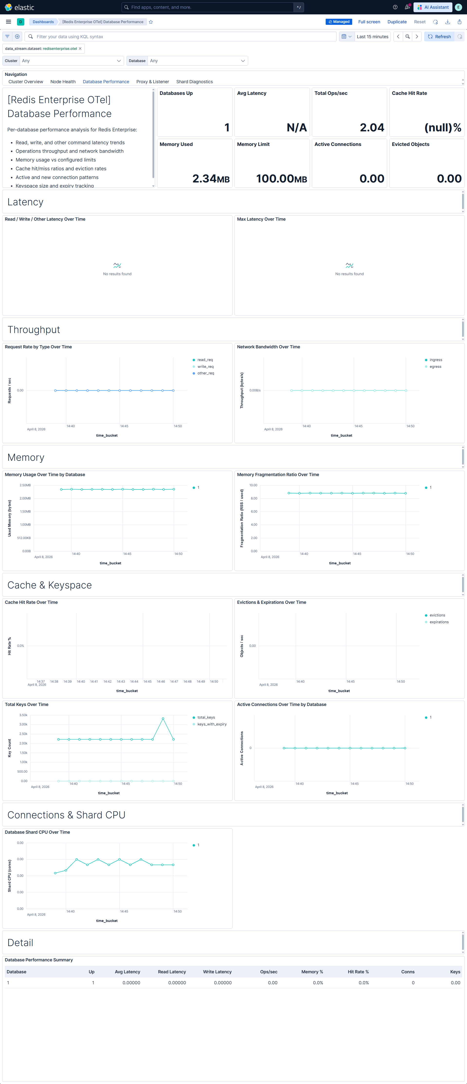

| [Redis Enterprise OTel] Database Performance | Per-database performance analysis with latency breakdown, throughput, memory utilization, cache effectiveness, and connection patterns. |

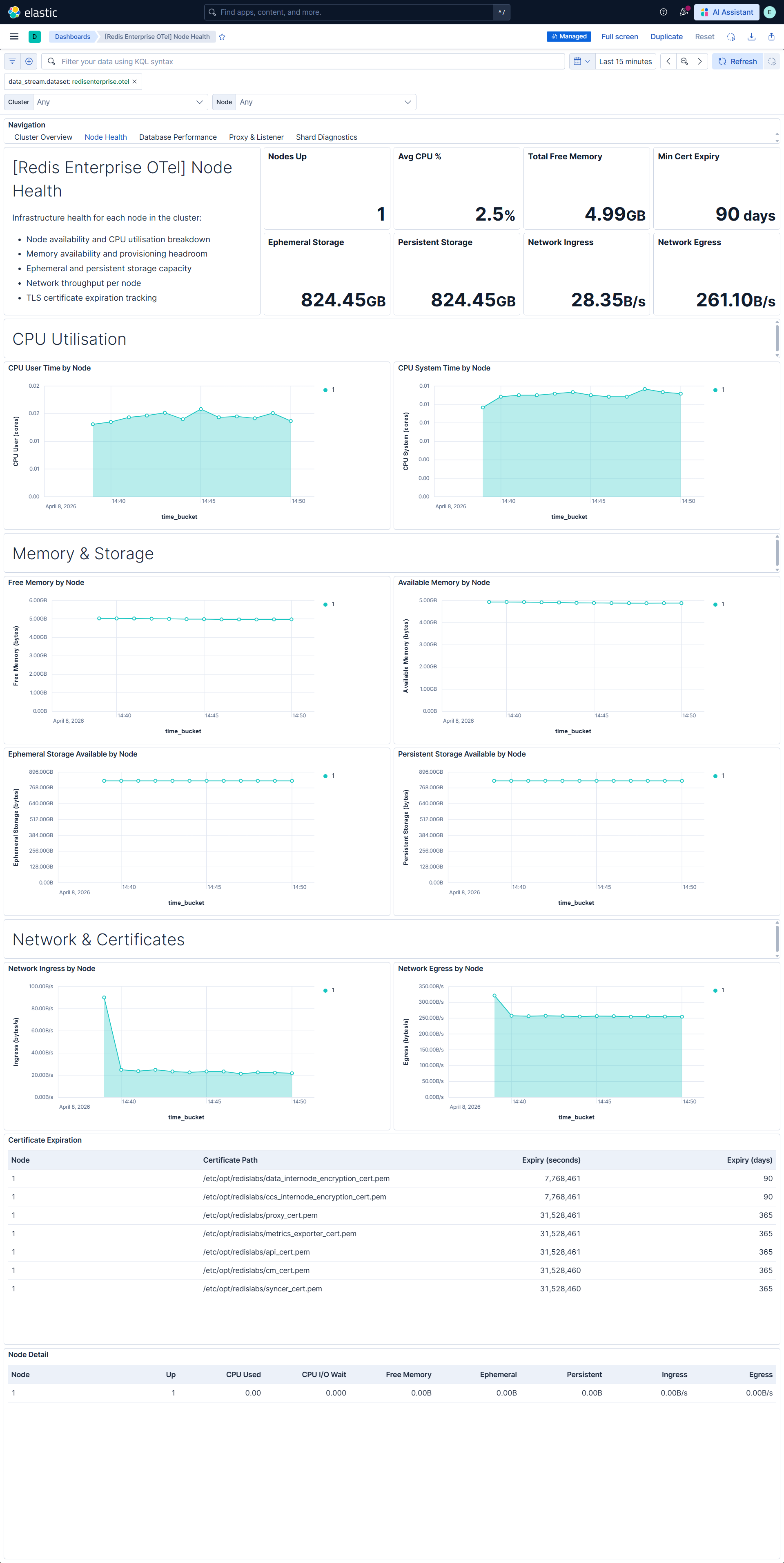

| [Redis Enterprise OTel] Node Health | Node-level monitoring covering CPU, memory, storage, network, and certificate expiration across all cluster nodes. |

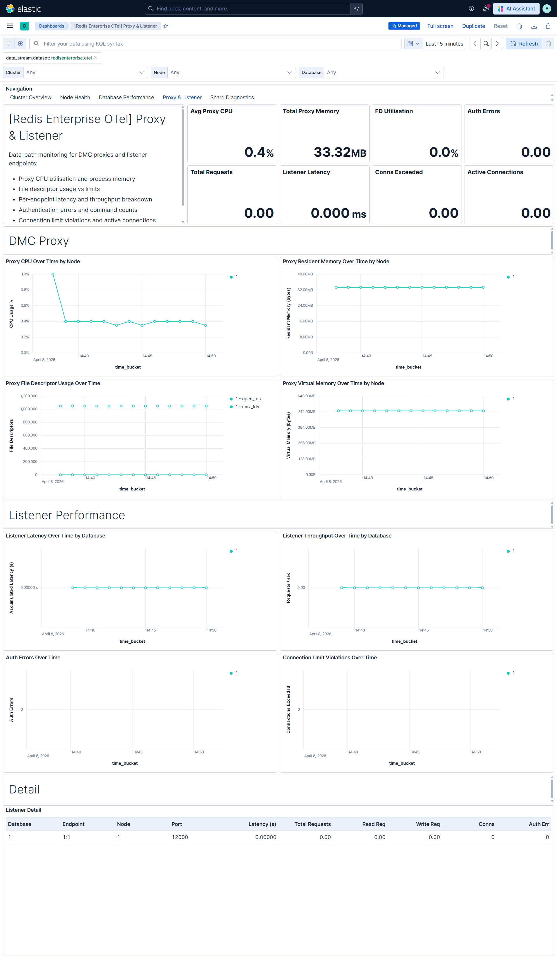

| [Redis Enterprise OTel] Proxy & Listener | DMC proxy resource usage and listener-level performance metrics including proxy CPU, memory, file descriptors, latency, throughput, and authentication activity. |

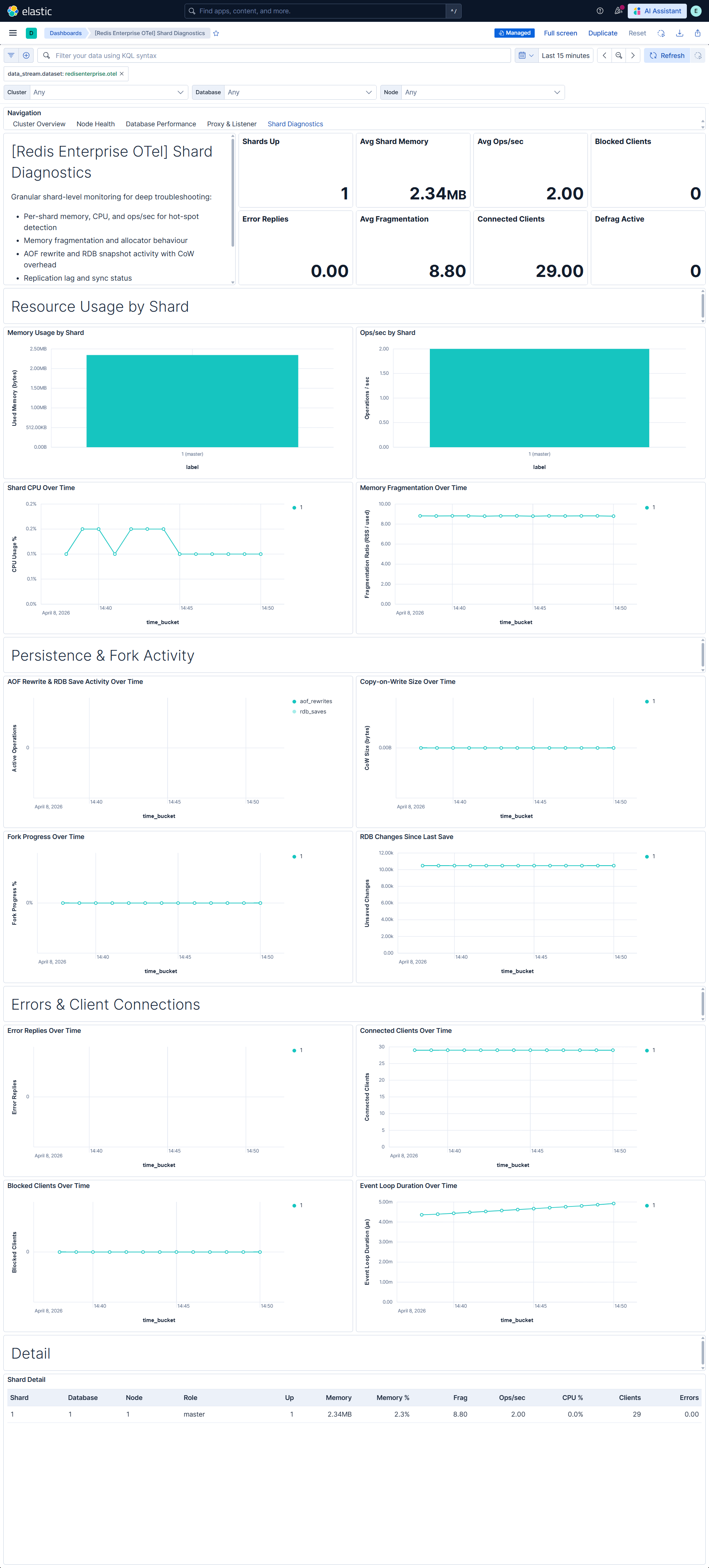

| [Redis Enterprise OTel] Shard Diagnostics | Shard-level deep diagnostics for per-shard resource usage, memory fragmentation, persistence operations, replication health, error analysis, and client connections. |
