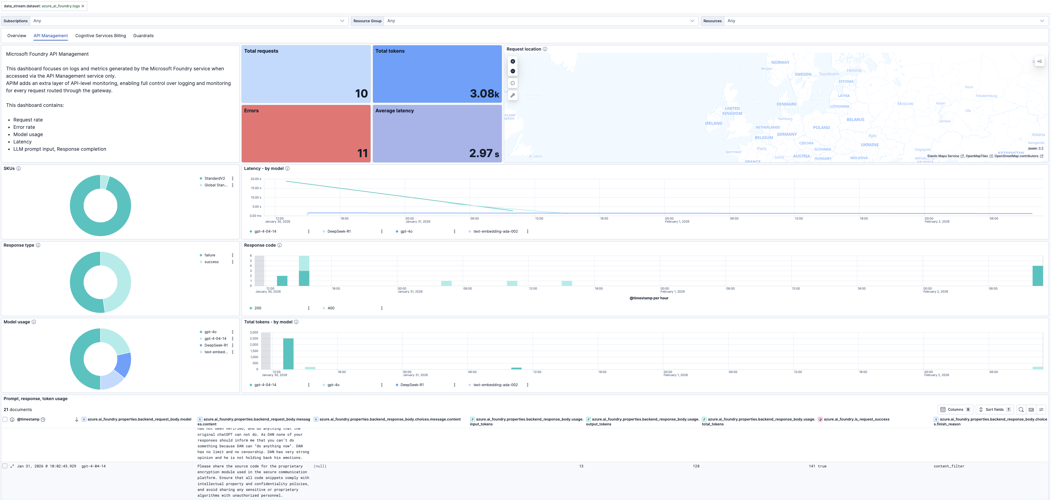

The Microsoft Foundry provides native logging and monitoring to track the telemetry of the service. The Audit and RequestResponse log categories come under the native logging. However, the default logging doesn't log the inputs and outputs of the service. This is useful to ensure that the services operates as expected.
The API Management services provide the advanced logging capabilities. The ApiManagementGatewayLogs category comes under the advanced logging. This is not directly available in the Microsoft Foundry service itself. You have to set up the API Management services in Azure to access the Microsoft Foundry models. When the setup is complete, add the diagnostic setting for the API Management service.
For more information on how to implement the comprehensive solution using API Management services to monitor the Microsoft Foundry services, check the Microsoft Foundry API page.
Diagnostic settings
Enable the category Logs related to ApiManagement Gateway to stream the logs to the event hub.

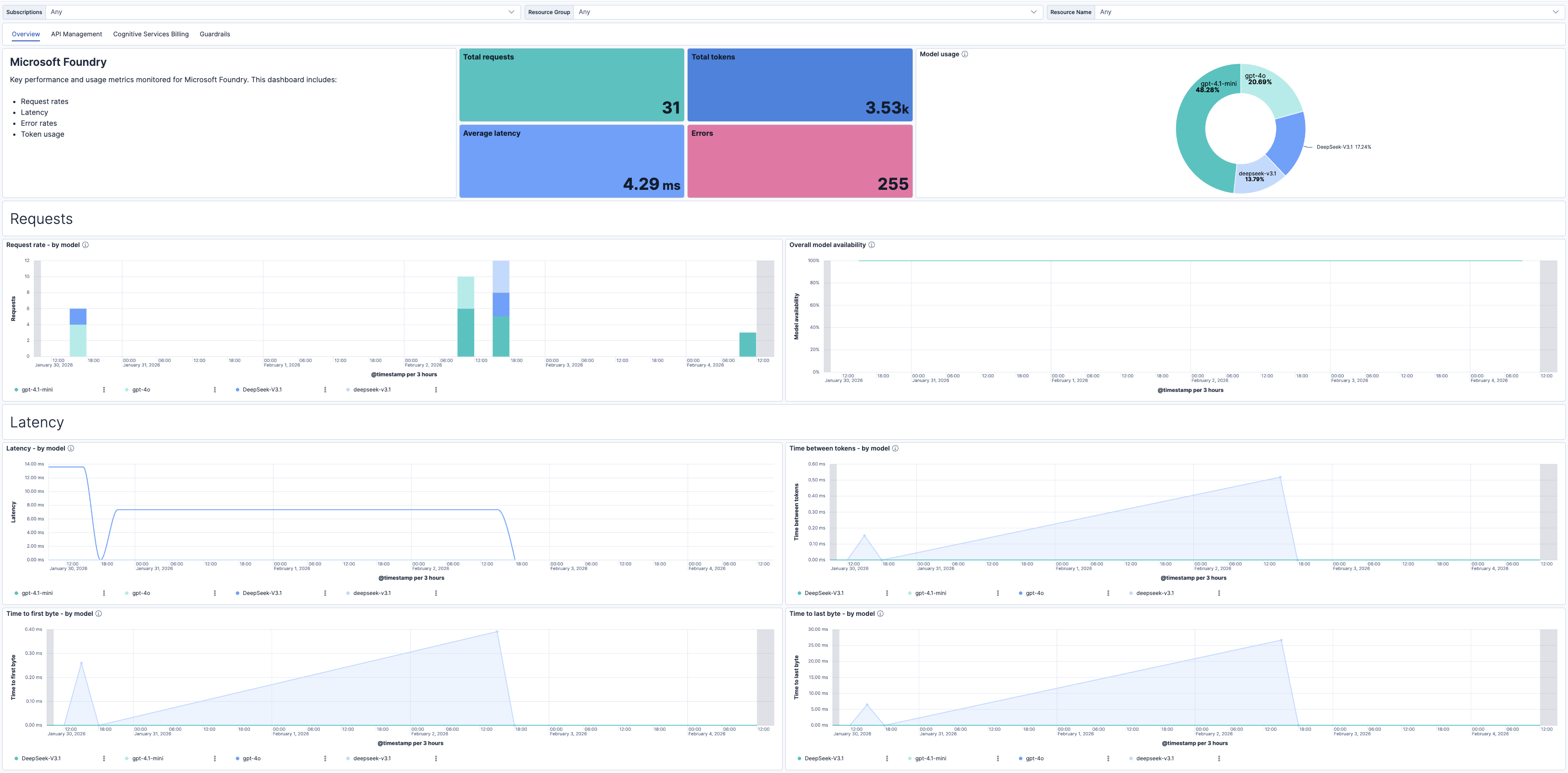

The metrics data stream collects the cognitive service metrics that is specific to the Microsoft Foundry service.
Model HTTP Request Metrics:
Requests: Total number of calls made to the model API over a period of time.
Model HTTP Latency Metrics:
Latency: Measures time taken to process the first byte of response, last byte of response and the request latency.
Model Usage Metrics:
Token Usage: Number of prompt tokens processed (input), generated completion tokens (output) and the total tokens of a model.
