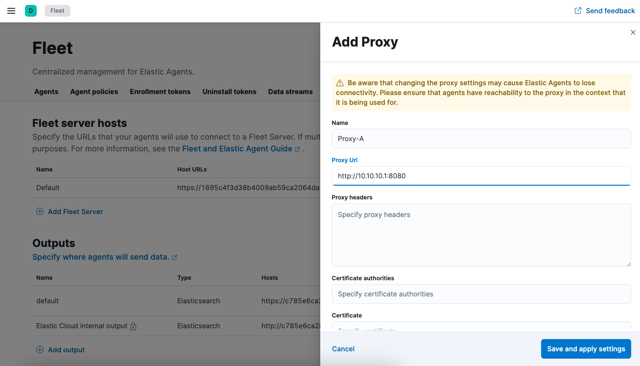

  1. Globally add proxy server details to Fleet.
    1. In Fleet, open the Settings tab.
    2. Select Add proxy. The Add proxy or Edit proxy flyout opens.
      Screen capture of the Edit Proxy UI in Fleet
    3. Add a name for the proxy (in this example Proxy-A) and specify the Proxy URL.
    4. Add any other optional settings.
    5. Select Save and apply settings. The proxy information is saved and that proxy is ready for other components in Fleet to reference.

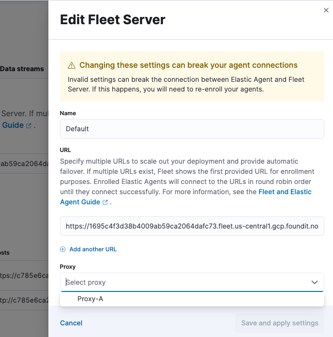

  2. Attach the proxy to a Fleet Server.
    If the control plane traffic to/from the Fleet Server needs to also go through the proxy server, the proxy created needs to also be added to the definition of that Fleet Server.
    2. In the list of Fleet server hosts, choose a host and select the edit button to configure it.
    3. In the Proxy section dropdown list, select the proxy that you configured.
      Screen capture of the Edit Fleet Server UI
      In this example, all the Elastic Agents in a policy that uses this Fleet Server will now connect to the Fleet Server through the proxy server defined in Proxy-A.
    Warning
    Any invalid changes to the Fleet Server definition that may cause connectivity issues between the Elastic Agents and the Fleet Server will cause them to disconnect. The only remedy would be to re-install the affected agents. This is because the connectivity to the Fleet Server ensures policy updates reach the agents. If a policy with an invalid host address reaches the agent it will no longer be able to connect and therefore won’t receive any other updates from the Fleet Server (including the corrected setting). In this regard, adding a proxy server that is not reachable by the agents will break connectivity to the Fleet Server.

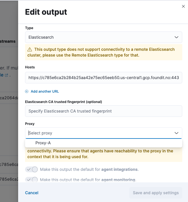

  3. Attach the proxy to the output
    Similarly, if the data plane traffic to an output is to traverse through a proxy, that proxy definition would need to be added to the output defined in Fleet.
    2. In the list of Outputs, choose an output and select the edit button to configure it.
      Screen capture of the Edit output UI in Fleet
      In this example, all the Elastic Agents in a policy that is configured to write to the chosen output will now write to that output through the proxy server defined in Proxy-A.
    Warning
    If agents are unable to reach the configured proxy server, they will not be able to write data to the output that has the proxy server configured. When changing the proxy of an output, ensure that the affected agents all have connectivity to the proxy itself.

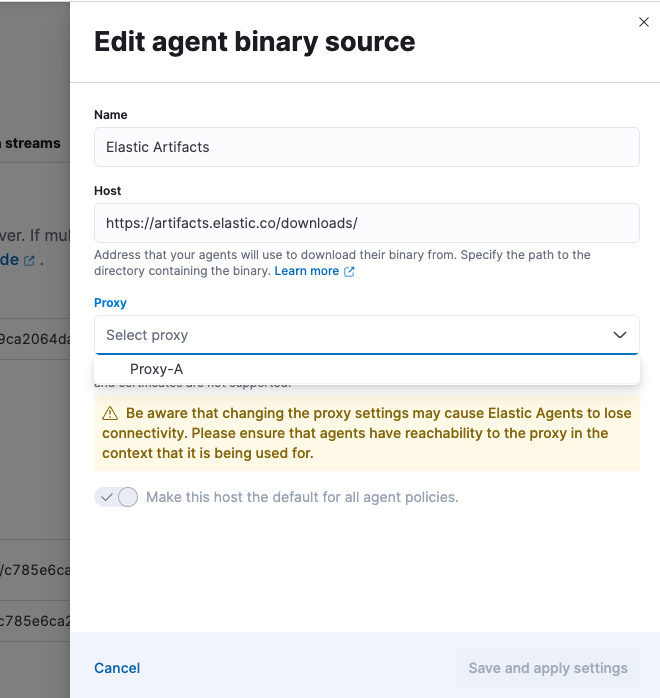

  4. Attach the proxy to the agent download source
    Likewise, if the download traffic to or from the artifact registry needs to go through the proxy server, that proxy definition also needs to be added to the agent binary source defined in Fleet.
    2. In the Agent Binary Download list, choose an agent binary source and select the edit button to configure it.
      Screen capture of the Edit agent binary source UI in Fleet
      In this example, all of the Elastic Agents enrolled in a policy that is configured to download from the chosen agent download source will now download from that agent download source through the proxy server defined in Proxy-A.
    Warning
    If agents are unable to reach the configured proxy server, they will not be able to download binaries from the agent download source that has the proxy server configured. When changing the proxy of an agent binary source, ensure that the affected agents all have connectivity to the proxy itself.

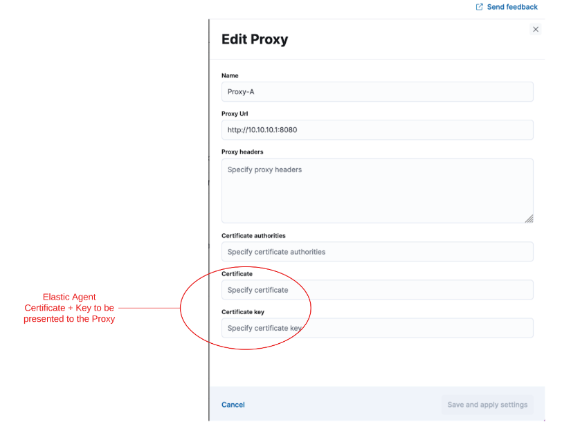

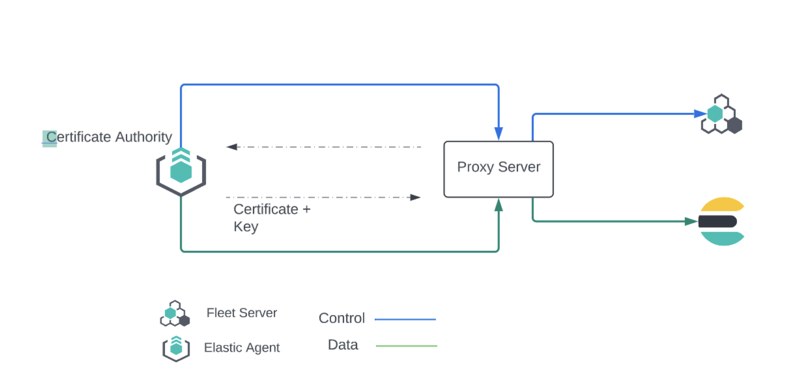

Many secure proxy gateways are configured to perform mutual TLS and expect all connections to present their certificate. In these instances, the Client (in this case, the Elastic Agent) would need to present a certificate and key to the Server (the secure proxy). In return, the client expects to receive a certificate authority chain from the server to ensure it is also communicating to a trusted entity.
Image showing data flow between the proxy server and the Certificate Authority
If mTLs is a requirement when connecting to your proxy server, then you have the option to add the Client certificate and Client certificate key to the proxy. Once configured, all the Elastic Agents in a policy that connect to this secure proxy (via an output or Fleet Server) use the nominated certificates to establish connections to the proxy server.
You can define a local path to the certificate and key as, in many common scenarios, the certificate and key are unique for each Elastic Agent.
Equally important is the Certificate Authority that the agents need to use to validate the certificate they are receiving from the secure proxy server. This can also be added when creating the proxy definition in the Fleet settings.
