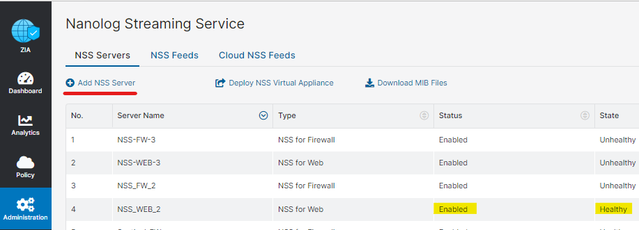

- Verify that the state of the NSS Server is healthy.
- In the ZIA Admin Portal, go to Administration > Nanolog Streaming Service > NSS Servers.
- In the State column, confirm that the state of the NSS server is healthy.

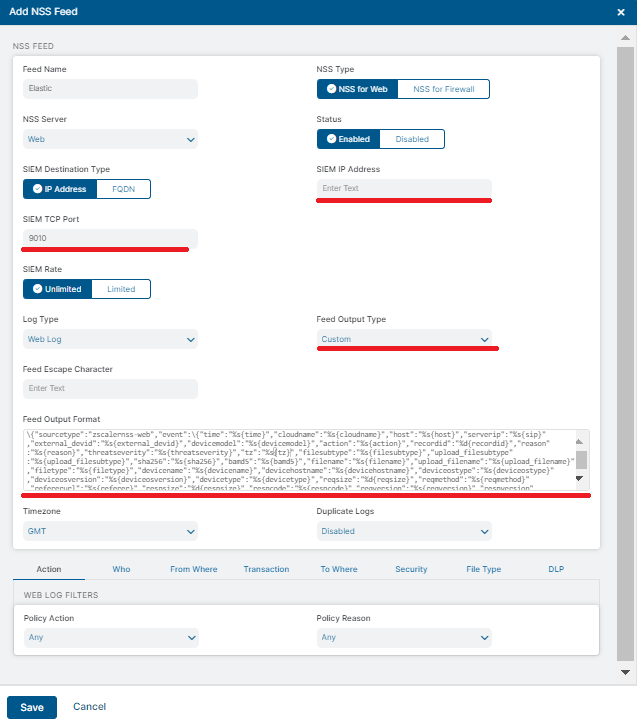

- In the ZIA Admin Portal, add an NSS Feed.
- Refer to Add NSS Feeds and select the type of feed you want to configure. The following fields require specific inputs:
- SIEM IP Address: Enter the IP address of the Elastic agent you’ll be assigning the Zscaler integration to.
- SIEM TCP Port: Enter the port number, depending on the logs associated with the NSS Feed. You will need to create an NSS Feed for each log type.
- Alerts: 9010
- Audit: 9029
- DNS: 9011
- Email DLP: 9025
- Endpoint DLP: 9023
- Firewall: 9012
- SaaS Security Activity: 9026
- SaaS Security: 9024
- Sandbox Verdict: 9027
- Tunnel: 9013
- Web: 9014
- Feed Output Type: Select Custom in Feed output type and paste the appropriate response format in Feed output format as follows:

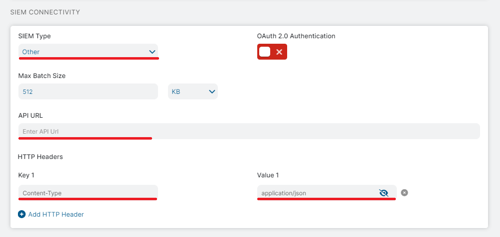

- In the ZIA Admin Portal, go to Administration > Nanolog Streaming Service > Cloud NSS Feeds.
- Give Feed Name, change status to Enabled.
- Select NSS Type.
- Change SIEM Type to other.
- Add an API URL.
- Default ports:
- Audit: 9562
- DNS: 9556
- Email DLP: 9564
- Endpoint DLP: 9561
- Firewall: 9557
- SaaS Security Activity: 9565
- SaaS Security: 9563
- Sandbox Verdict: 9566
- Tunnel: 9558
- Web: 9559
- Select JSON as feed output type.
- Add same custom header along with its value on both the side for additional security.

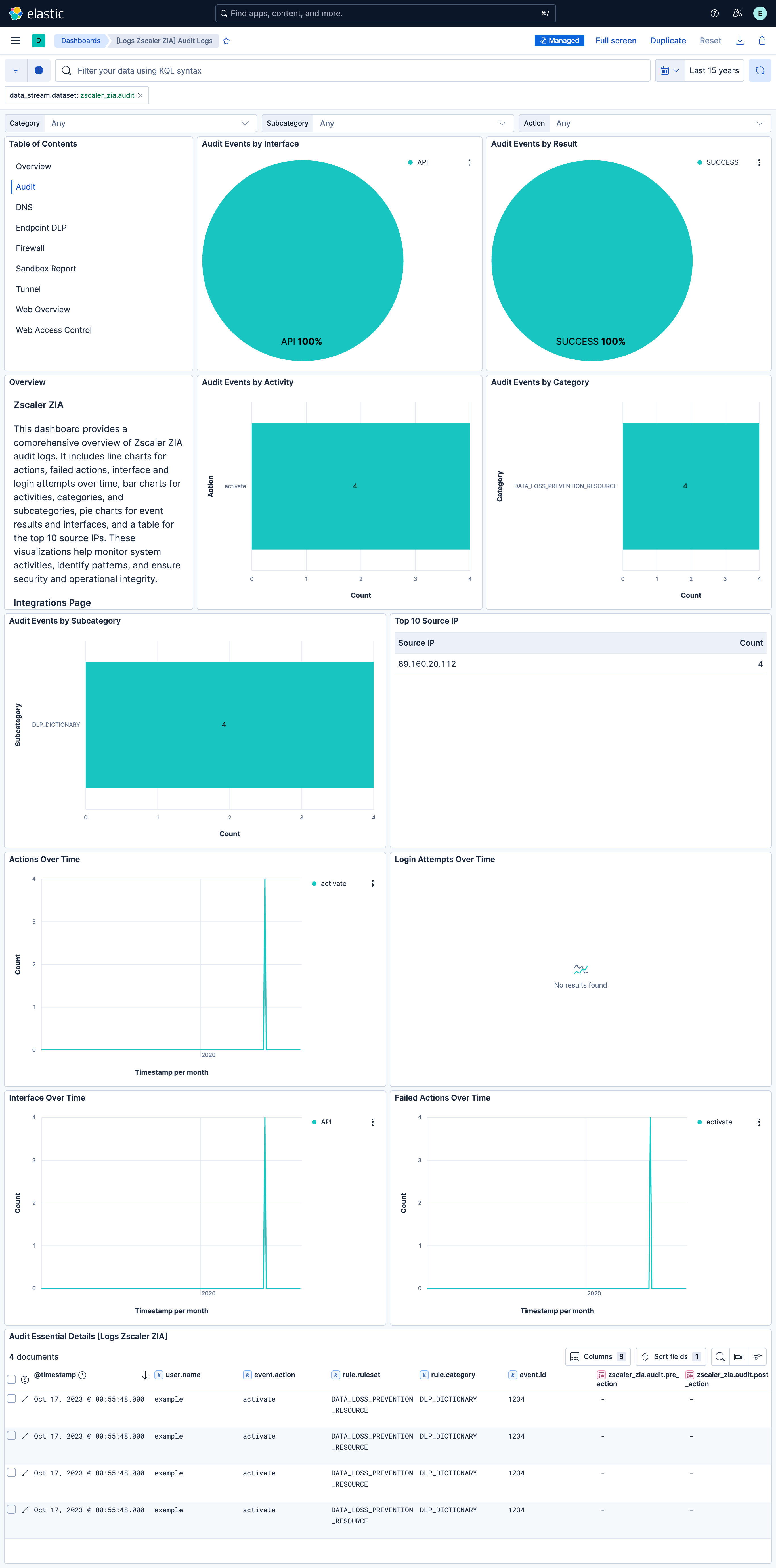

This is the alerts dataset.
Example

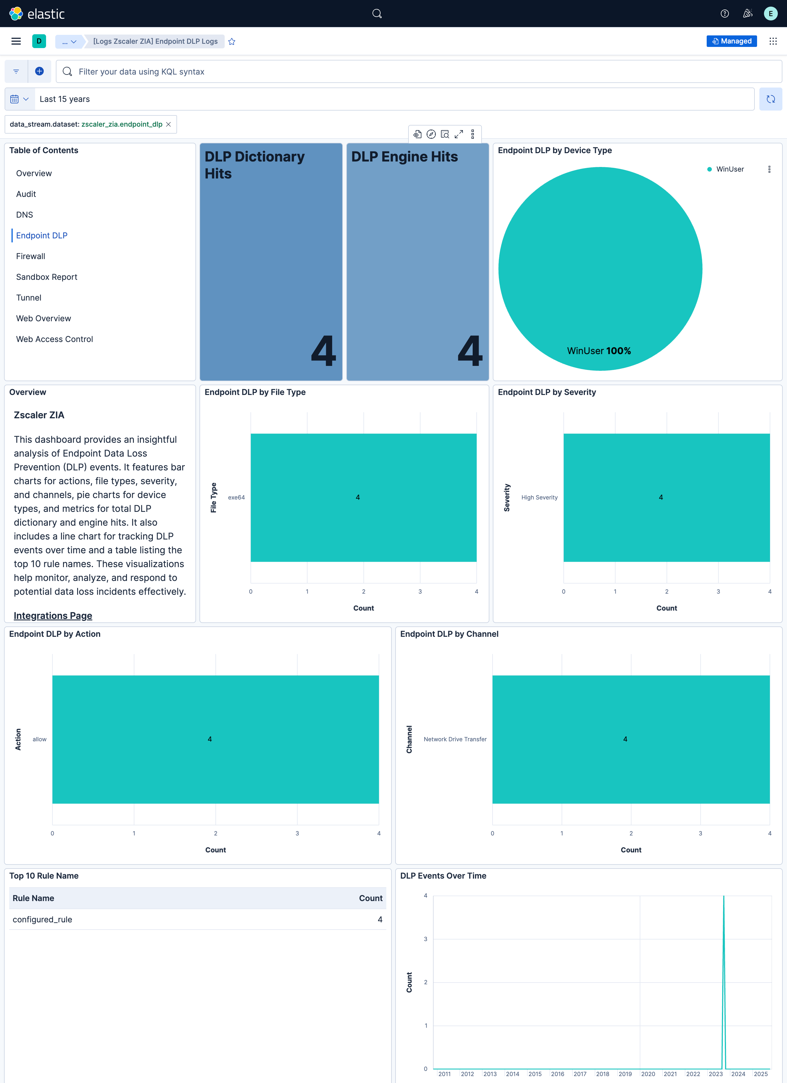

This is the endpoint_dlp dataset.

Exported fields
| event.dataset | Event dataset. | constant_keyword |
| event.module | Event module. | constant_keyword |
| input.type | Type of Filebeat input. | keyword |
| log.offset | Log offset. | long |
| log.source.address | Source address from which the log event was read / sent from. | keyword |
| zscaler_zia.endpoint_dlp.action_taken | The action taken by Zscaler Data Protection. | keyword |
| zscaler_zia.endpoint_dlp.activity_type | The activity type. | keyword |
| zscaler_zia.endpoint_dlp.additional_info | Additional information. | keyword |
| zscaler_zia.endpoint_dlp.channel | The channel. | keyword |
| zscaler_zia.endpoint_dlp.confirm_action | The confirmation action by the user. | keyword |
| zscaler_zia.endpoint_dlp.confirm_just | The confirmation action justification by the user. | keyword |
| zscaler_zia.endpoint_dlp.counts | The number of hits for each of the DLP dictionaries. | long |
| zscaler_zia.endpoint_dlp.datacenter.city | The city where the data center is located. | keyword |
| zscaler_zia.endpoint_dlp.datacenter.country | The country where the data center is located. | keyword |
| zscaler_zia.endpoint_dlp.datacenter.name | The name of the data center. | keyword |
| zscaler_zia.endpoint_dlp.day | The day of the week. | keyword |
| zscaler_zia.endpoint_dlp.day_of_month | The day of the month. | long |
| zscaler_zia.endpoint_dlp.department | The name of the department. | keyword |
| zscaler_zia.endpoint_dlp.destination_type | The destination type. | keyword |
| zscaler_zia.endpoint_dlp.device.appversion | The device application version. | keyword |
| zscaler_zia.endpoint_dlp.device.hostname | The device host name. | keyword |
| zscaler_zia.endpoint_dlp.device.model | The device model. | keyword |

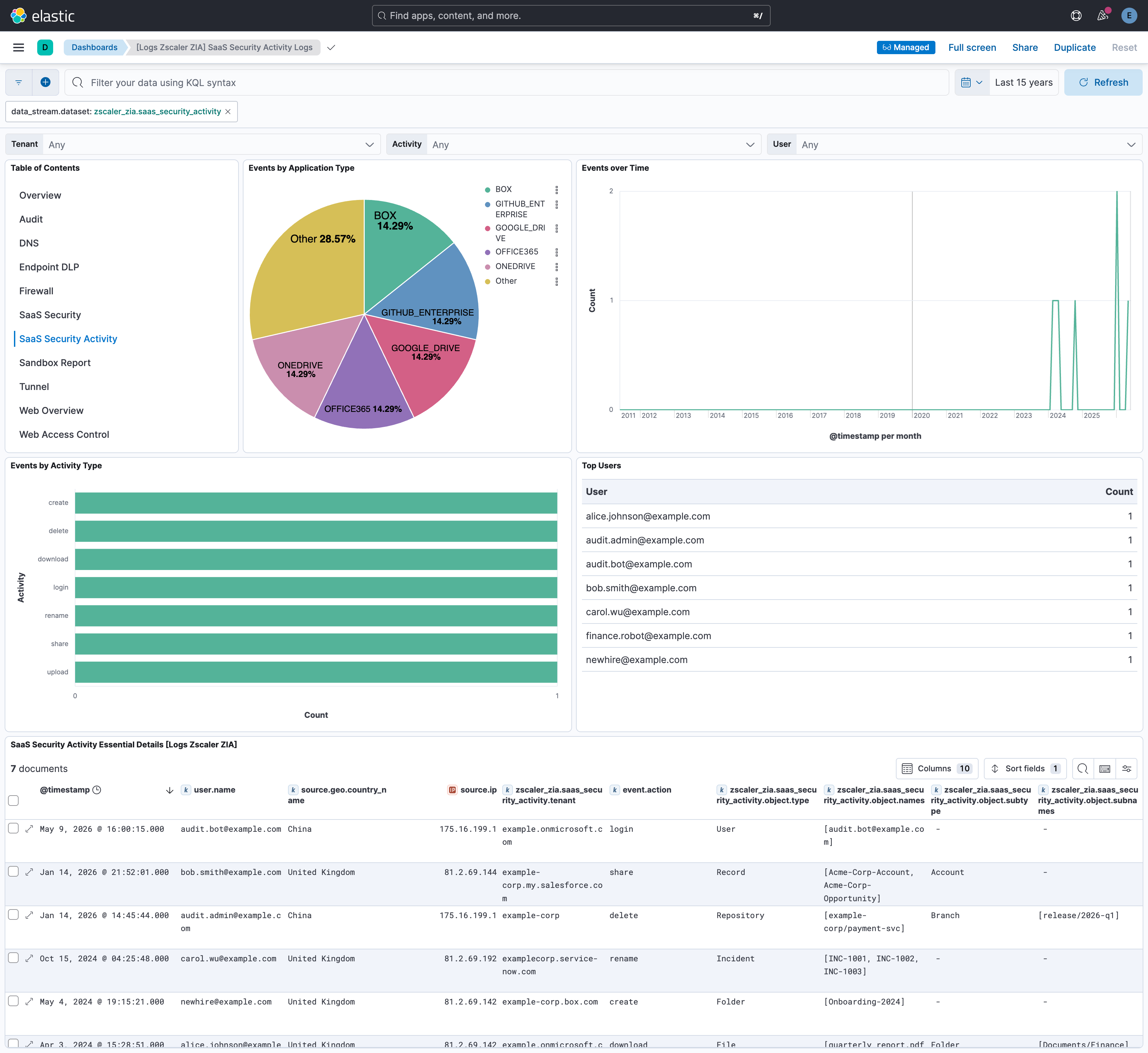

This is the saas_security_activity dataset.
Example
"@timestamp": "2024-03-15T11:30:00.000Z",
"agent": {
"ephemeral_id": "b29c5410-623b-42c9-a787-06f7986404ba",
"id": "213c4a4d-0280-41fb-a648-98539fccf384",
"name": "elastic-agent-24278",
"type": "filebeat",
"version": "8.18.0"
"data_stream": {
"dataset": "zscaler_zia.saas_security_activity",
"namespace": "89548",
"type": "logs"
"ecs": {
"version": "8.11.0"
"elastic_agent": {
"snapshot": false,
"version": "8.18.0"
"event": {
"action": "upload",
"category": [
"iam"
"ingested": "2026-06-02T06:32:41Z",
"kind": "event",
"original": "{\"activity\":{\"count\":\"1\",\"type\":\"Upload\"},\"application\":{\"name\":\"GOOGLE_DRIVE\"},\"event_time\":\"Fri Mar 15 11:30:00 2024\",\"external_owner\":\"vendor@partner.example.org\",\"is_admin\":\"0\",\"object\":{\"names\":\"[invoice-2024-Q1.xlsx]\",\"subnames\":\"[Shared with Vendors]\",\"subtype\":\"Folder\",\"type\":\"File\"},\"sourcetype\":\"zscalernss-saas_security_activity\",\"src_ip\":\"89.160.20.112\",\"tenant\":\"example.com\",\"time\":\"Fri Mar 15 11:30:00 2024\",\"tz\":\"GMT\",\"user_name\":\"finance.robot@example.com\",\"version\":\"v1\"}",
"provider": "Zscaler",
"timezone": "GMT",
"type": [
"change"
"input": {
"type": "http_endpoint"
"observer": {
"product": "Zscaler ZIA",
"vendor": "Zscaler"
"related": {
"ip": [
"89.160.20.112"
"user": [
"finance.robot@example.com",
"vendor@partner.example.org"
"source": {
"as": {
"number": 29518,
"organization": {
"name": "Bredband2 AB"
"geo": {
"city_name": "Linköping",
"continent_name": "Europe",
"country_iso_code": "SE",
"country_name": "Sweden",
"location": {
"lat": 58.4167,
"lon": 15.6167
"region_iso_code": "SE-E",
"region_name": "Östergötland County"
"ip": "89.160.20.112"
"tags": [
"preserve_original_event",
"forwarded",
"zscaler_zia-saas_security_activity"
"user": {
"domain": "example.com",
"email": "finance.robot@example.com",
"name": "finance.robot@example.com"
"zscaler_zia": {
"saas_security_activity": {
"activity": {
"count": 1,
"type": "Upload"
"application": {
"name": "GOOGLE_DRIVE"
"event_time": "2024-03-15T11:30:00.000Z",
"external_owner": "vendor@partner.example.org",
"is_admin": false,
"object": {
"names": "[invoice-2024-Q1.xlsx]",
"subnames": "[Shared with Vendors]",
"subtype": "Folder",
"type": "File"
"sourcetype": "zscalernss-saas_security_activity",
"tenant": "example.com",
"version": "v1"
Exported fields
| @timestamp | Date/time when the event originated. This is the date/time extracted from the event, typically representing when the event was generated by the source. If the event source has no original timestamp, this value is typically populated by the first time the event was received by the pipeline. Required field for all events. | date |
| data_stream.dataset | The field can contain anything that makes sense to signify the source of the data. Examples include nginx.access, prometheus, endpoint etc. For data streams that otherwise fit, but that do not have dataset set we use the value "generic" for the dataset value. event.dataset should have the same value as data_stream.dataset. Beyond the Elasticsearch data stream naming criteria noted above, the dataset value has additional restrictions: * Must not contain - * No longer than 100 characters |
constant_keyword |
| data_stream.namespace | A user defined namespace. Namespaces are useful to allow grouping of data. Many users already organize their indices this way, and the data stream naming scheme now provides this best practice as a default. Many users will populate this field with default. If no value is used, it falls back to default. Beyond the Elasticsearch index naming criteria noted above, namespace value has the additional restrictions: * Must not contain - * No longer than 100 characters |
constant_keyword |
| data_stream.type | An overarching type for the data stream. Currently allowed values are "logs" and "metrics". We expect to also add "traces" and "synthetics" in the near future. | constant_keyword |
| event.dataset | Name of the dataset. If an event source publishes more than one type of log or events (e.g. access log, error log), the dataset is used to specify which one the event comes from. It's recommended but not required to start the dataset name with the module name, followed by a dot, then the dataset name. | constant_keyword |
| event.module | Name of the module this data is coming from. If your monitoring agent supports the concept of modules or plugins to process events of a given source (e.g. Apache logs), event.module should contain the name of this module. |
constant_keyword |
| zscaler_zia.saas_security_activity.activity.count | The activity count. | long |
| zscaler_zia.saas_security_activity.activity.type | The type of activity performed by the user. | keyword |
| zscaler_zia.saas_security_activity.application.name | The SaaS application name associated with the activity. | keyword |
| zscaler_zia.saas_security_activity.event_time | The event time of the activity. | date |
| zscaler_zia.saas_security_activity.external_owner | The external owner of the SaaS application. | keyword |
| zscaler_zia.saas_security_activity.is_admin | Indicates whether the user who performed the activity is an administrator. | boolean |
| zscaler_zia.saas_security_activity.object.names | The names or identifiers associated with the primary object type. | keyword |
| zscaler_zia.saas_security_activity.object.subnames | The names or identifiers associated with the secondary object type, if applicable. | keyword |
| zscaler_zia.saas_security_activity.object.subtype | The second object type associated with the activity, if applicable. | keyword |
| zscaler_zia.saas_security_activity.object.type | The object type associated with the activity. | keyword |
| zscaler_zia.saas_security_activity.sourcetype | NSS feed sourcetype identifier for SaaS Security Activity. | keyword |
| zscaler_zia.saas_security_activity.src_ip | The IP address associated with the activity. | ip |
| zscaler_zia.saas_security_activity.tenant | The SaaS application tenant associated with the activity. | keyword |
| zscaler_zia.saas_security_activity.time | The time and date of the transaction. This excludes the time zone. | date |
| zscaler_zia.saas_security_activity.tz | The time zone. This is the same as the time zone you specified when you configured the NSS feed. | keyword |
| zscaler_zia.saas_security_activity.user_name | The user who performed the activity. | keyword |
| zscaler_zia.saas_security_activity.version | Feed Output Format template version expected by this integration. | keyword |

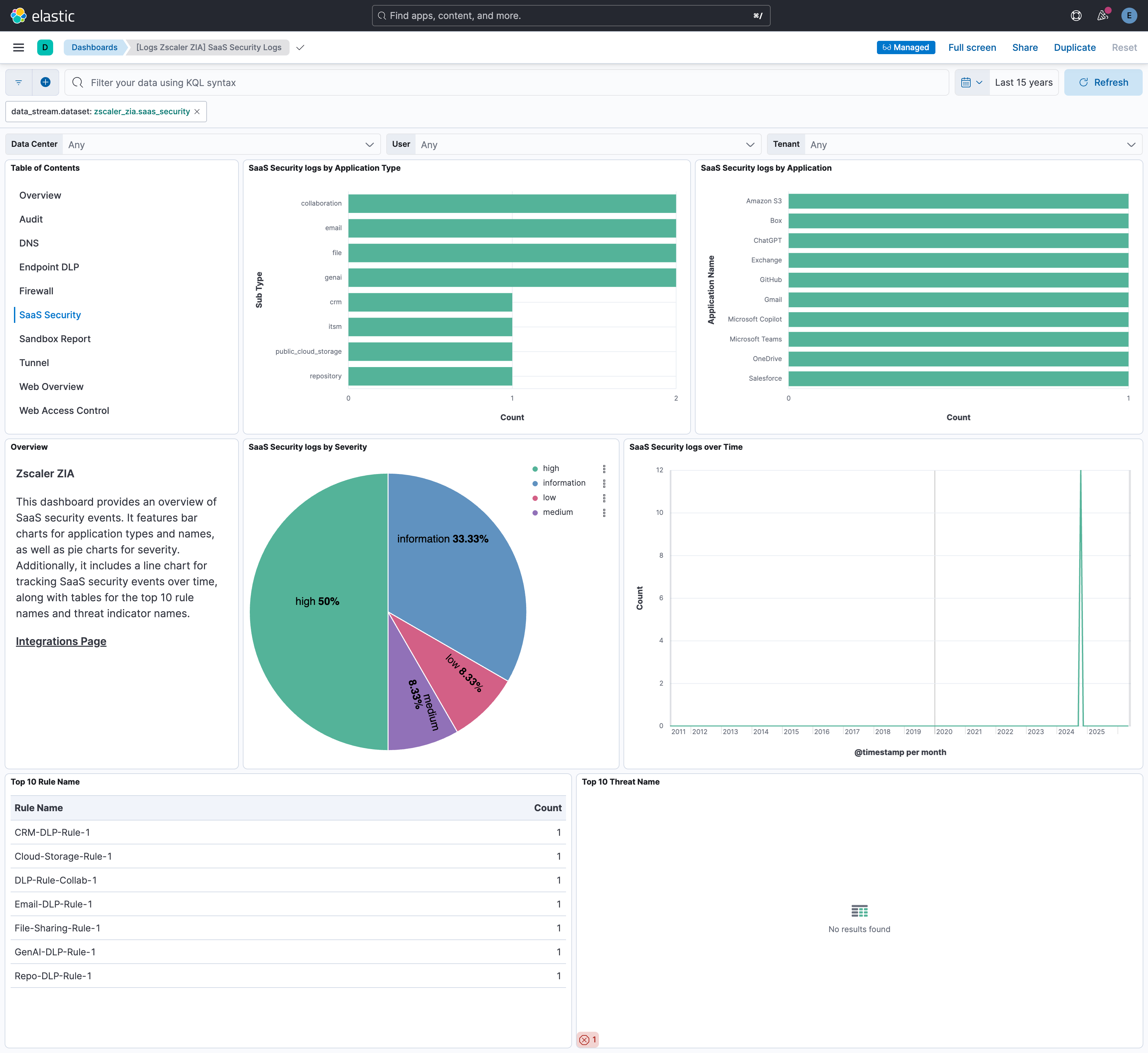

This is the saas_security dataset.
Example
"@timestamp": "2024-11-01T09:55:48.000Z",
"agent": {
"ephemeral_id": "9b4f8728-89a4-494b-9e96-833c36bd8337",
"id": "43cc9f88-ed20-4024-abcd-01e25da67e15",
"name": "elastic-agent-74083",
"type": "filebeat",
"version": "8.18.0"
"data_stream": {
"dataset": "zscaler_zia.saas_security",
"namespace": "22530",
"type": "logs"
"destination": {
"user": {
"email": [
"jane.doe@example.org",
"john.public@example.org",
"alice.smith@example.com",
"bob.jones@example.com"
"ecs": {
"version": "8.11.0"
"elastic_agent": {
"snapshot": false,
"version": "8.18.0"
"event": {
"category": [
"network",
"intrusion_detection"
"id": "7379788644480581634",
"ingested": "2026-05-20T06:26:58Z",
"kind": "event",
"original": "{\"application\":{\"name\":\"Slack\"},\"collaboration\":{\"channel\":{\"hostname\":\"teams.example.com\",\"hostname_obfuscated\":\"6389711095\",\"name\":\"engineering-private\",\"name_obfuscated\":\"9769110224\"},\"external_recipients\":\"jane.doe@example.org|john.public@example.org\",\"external_recipients_obfuscated\":\"7531480912|0912753148\",\"internal_recipients\":\"alice.smith@example.com|bob.jones@example.com\",\"internal_recipients_obfuscated\":\"2435617791|7791162435\",\"sender\":\"alice.smith@example.com\",\"sender_obfuscated\":\"6200694987\"},\"company\":{\"name\":\"Example Corp\"},\"copilot_accessible\":\"Yes\",\"datacenter\":{\"city\":\"San Jose\",\"country\":\"US\",\"name\":\"CA Client Node DC\"},\"department\":\"Engineering\",\"dlp\":{\"dict_counts\":\"4|2\",\"dict_names\":\"Credit Cards|Social Security Numbers\",\"engine_names\":\"PCI|HIPAA\",\"identifier\":\"6646484838839025669\"},\"document\":{\"type\":\"Corporate Finance\"},\"file\":{\"owner\":\"jane.doe@example.org\",\"owner_obfuscated\":\"7531480912\"},\"is_incident\":\"Yes\",\"label_name\":\"Confidential\",\"message_id\":\"01U7H7LGKE6AEZ7DPW7ZEYU2WADV7ET3CV\",\"message_id_obfuscated\":\"5300295980\",\"policy\":\"Make internal sharing read only\",\"record_id\":\"7379788644480581634\",\"rule\":{\"label\":\"DLP-Rule-Collab-1\",\"label_obfuscated\":\"3399565100\",\"type\":\"OfflineCASBDLPCOLLAB\"},\"severity\":\"High\",\"sourcesubtype\":\"collaboration\",\"sourcetype\":\"zscalernss-saas_security\",\"tenant\":\"example-tenant\",\"tenant_obfuscated\":\"8794487099\",\"threat\":{\"indicator\":{\"name\":\"None\"},\"malware\":\"None\",\"malware_class\":\"None\"},\"time\":\"1730454948\",\"tz\":\"GMT\",\"user_name\":\"alice.smith@example.com\",\"user_name_obfuscated\":\"6200694987\",\"version\":\"v1\"}",
"severity": 73,
"timezone": "GMT",
"type": [
"denied",
"info"
"file": {
"owner": "jane.doe@example.org"
"input": {
"observer": {
"geo": {
"city_name": "San Jose",
"country_iso_code": "US",
"name": "CA Client Node DC"
"name": "CA Client Node DC",
"vendor": "Zscaler"
"organization": {
"name": "Example Corp"
"related": {
"hosts": [
"teams.example.com"
"user": [
"rule": {
"name": "DLP-Rule-Collab-1",
"ruleset": "OfflineCASBDLPCOLLAB"
"source": {
"user": {
"email": "alice.smith@example.com"
"tags": [
"forwarded",
"zscaler_zia-saas_security"
"user": {
"email": "alice.smith@example.com",
"name": "alice.smith@example.com"
"zscaler_zia": {
"saas_security": {
"application": {
"name": "Slack"
"collaboration": {
"channel": {
"hostname": "teams.example.com",
"hostname_obfuscated": "6389711095",
"name": "engineering-private",
"name_obfuscated": "9769110224"
"external_recipients_obfuscated": [
"7531480912",
"0912753148"
"internal_recipients_obfuscated": [
"2435617791",
"7791162435"
"sender_obfuscated": "6200694987"
"copilot_accessible": true,
"department": "Engineering",
"dlp": {
"dict_counts": [
4,
2
"dict_names": [
"Credit Cards",
"Social Security Numbers"
"engine_names": [
"PCI",
"HIPAA"
"identifier": "6646484838839025669"
"document": {
"type": "Corporate Finance"
"file": {
"owner_obfuscated": "7531480912"
"is_incident": true,
"label_name": "Confidential",
"message_id": "01U7H7LGKE6AEZ7DPW7ZEYU2WADV7ET3CV",
"message_id_obfuscated": "5300295980",
"policy": "Make internal sharing read only",
"rule": {
"label_obfuscated": "3399565100"
"severity": "High",
"sourcesubtype": "collaboration",
"sourcetype": "zscalernss-saas_security",
"tenant": "example-tenant",
"tenant_obfuscated": "8794487099",
"user_name_obfuscated": "6200694987",
"version": "v1"
Exported fields
| Field | Description | Type | |
| @timestamp | Date/time when the event originated. This is the date/time extracted from the event, typically representing when the event was generated by the source. If the event source has no original timestamp, this value is typically populated by the first time the event was received by the pipeline. Required field for all events. | date | |
constant_keyword | |
| data_stream.type | An overarching type for the data stream. Currently allowed values are "logs" and "metrics". We expect to also add "traces" and "synthetics" in the near future. | constant_keyword | |
| email.attachments | A list of objects describing the attachment files sent along with an email message. | nested | |
| email.attachments.file.hash.md5 | MD5 hash. | keyword | |
| email.attachments.file.name | Name of the attachment file including the file extension. | keyword | |
| email.attachments.file.size | Attachment file size in bytes. | long | |
| event.dataset | Name of the dataset. If an event source publishes more than one type of log or events (e.g. access log, error log), the dataset is used to specify which one the event comes from. It's recommended but not required to start the dataset name with the module name, followed by a dot, then the dataset name. | constant_keyword | |
| input.type | Type of Filebeat input. | keyword | |
| log.offset | Log offset. | long | |
| log.source.address | Source address from which the log event was read / sent from. | keyword | |
| zscaler_zia.saas_security.accessibility_flags | A multivalue flag that provides the accessibility information of the asset. | keyword | |
| zscaler_zia.saas_security.application.name | The name of the sanctioned SaaS application. | keyword | |
| zscaler_zia.saas_security.bucket.id | The bucket ID. | keyword | |
| zscaler_zia.saas_security.bucket.name | The bucket name. | keyword | |
| zscaler_zia.saas_security.bucket.name_obfuscated | The obfuscated version of the bucket name. | keyword | |
| zscaler_zia.saas_security.bucket.owner | The bucket owner. | keyword | |
| zscaler_zia.saas_security.bucket.owner_obfuscated | The obfuscated version of the bucket name. | keyword | |
| zscaler_zia.saas_security.collab_count | The number of collaborators. | long | |
| zscaler_zia.saas_security.collab_names | The names of the collaborators. | keyword | |
| zscaler_zia.saas_security.collab_names_obfuscated | The obfuscated version of the names of the collaborators. | keyword | |
| zscaler_zia.saas_security.collaboration.channel.hostname | The hostname of the shared channel. | keyword | |
| zscaler_zia.saas_security.collaboration.channel.hostname_obfuscated | The obfuscated version of the hostname of the shared channel. | keyword | |
| zscaler_zia.saas_security.collaboration.channel.name | The name of the channel. | keyword | |
| zscaler_zia.saas_security.collaboration.channel.name_obfuscated | The obfuscated version of the channel name. | keyword | |
| zscaler_zia.saas_security.collaboration.external_recipients | The names of the external recipient names. | keyword | |
| zscaler_zia.saas_security.collaboration.external_recipients_obfuscated | The obfuscated version of the external recipient names. | keyword | |
| zscaler_zia.saas_security.collaboration.internal_recipients | The names of the internal recipients. | keyword | |
| zscaler_zia.saas_security.collaboration.internal_recipients_obfuscated | The obfuscated version of the internal recipient names. | keyword | |
| zscaler_zia.saas_security.collaboration.sender | The sender's email. | keyword | |
| zscaler_zia.saas_security.collaboration.sender_obfuscated | The obfuscated version of the sender's email. | keyword | |
| zscaler_zia.saas_security.company.id | The numeric ID given to a company by Zscaler. | keyword | |
| zscaler_zia.saas_security.company.name | The company name. | keyword | |
| zscaler_zia.saas_security.component | The type of component recorded. | keyword | |
| zscaler_zia.saas_security.copilot_accessible | Indicates whether the asset is accessible by the Microsoft Copilot Readiness Assessment. | boolean | |
| zscaler_zia.saas_security.datacenter.city | The city where the data center is located. | keyword | |
| zscaler_zia.saas_security.datacenter.country | The country where the data center is located. | keyword | |
| zscaler_zia.saas_security.datacenter.name | The name of the data center. | keyword | |
| zscaler_zia.saas_security.department | The user's department. If authentication is not required and the traffic comes from a location specified in the service, this field displays the name of the gateway location. | keyword | |
| zscaler_zia.saas_security.dlp.dict_counts | The number of hits for each of the DLP dictionaries that were matched in the transaction. This displays a string field separated by a vertical line (" | "). | long |
| zscaler_zia.saas_security.dlp.dict_names | The Data Loss Prevention (DLP) dictionary names. | keyword | |
| zscaler_zia.saas_security.dlp.dict_names_obfuscated | The obfuscated version of the DLP dictionary names. | keyword | |
| zscaler_zia.saas_security.dlp.engine_names | The DLP engine names. | keyword | |
| zscaler_zia.saas_security.dlp.engine_names_obfuscated | The obfuscated version of the DLP engine names. | keyword | |
| zscaler_zia.saas_security.dlp.identifier | The DLP identifier. Whenever a DLP rule is hit, and the appropriate alert is configured, an email containing this ID is sent to your auditors. | keyword | |
| zscaler_zia.saas_security.document.subtype | The subtype of the document uploaded or downloaded during the transaction. | keyword | |
| zscaler_zia.saas_security.document.type | The type of document uploaded or downloaded during the transaction. | keyword | |
| zscaler_zia.saas_security.email.attachments.file_names | The name of the suspicious file detected by the Data at Rest Scanning policy. | keyword | |
| zscaler_zia.saas_security.email.attachments.file_names_obfuscated | The obfuscated version of the name of the suspicious file detected by the Data at Rest Scanning policy. | keyword | |
| zscaler_zia.saas_security.email.attachments.file_sizes | The size of the file in bytes. | long | |
| zscaler_zia.saas_security.email.attachments.file_types | The component file type. | keyword | |
| zscaler_zia.saas_security.email.attachments.md5s | The component file MD5. | keyword | |
| zscaler_zia.saas_security.email.external_recipients | The names of external recipients. | keyword | |
| zscaler_zia.saas_security.email.external_recipients_count | The number of external recipients. | long | |
| zscaler_zia.saas_security.email.external_recipients_obfuscated | The obfuscated version of the names of external recipients. | keyword | |
| zscaler_zia.saas_security.email.internal_recipients | The names of internal recipients. | keyword | |
| zscaler_zia.saas_security.email.internal_recipients_count | The number of internal recipients. | long | |
| zscaler_zia.saas_security.email.internal_recipients_obfuscated | The obfuscated version of the names of internal recipients. | keyword | |
| zscaler_zia.saas_security.email.is_inbound | Indicates whether the email was sent or received or not. | boolean | |
| zscaler_zia.saas_security.email.message_size_bytes | The size of the message in bytes. | long | |
| zscaler_zia.saas_security.email.received_time | The time at which the transaction was recorded. | date | |
| zscaler_zia.saas_security.external_collab_count | The number of external collaborators. | long | |
| zscaler_zia.saas_security.external_collab_groups | The group of collaborators outside your organization with whom the user shares assets. The field can have up to 8 values separated by a vertical line (" | "). | keyword |
| zscaler_zia.saas_security.external_collab_groups_obfuscated | The obfuscated version of the group of collaborators outside your organization with whom the user shares assets. The field can have up to 8 values separated by a vertical line (" | "). | keyword |
| zscaler_zia.saas_security.external_collab_names | The names of external collaborators. | keyword | |
| zscaler_zia.saas_security.external_collab_names_obfuscated | The obfuscated version of external collaborator names. | keyword | |
| zscaler_zia.saas_security.external_user_name | The username or email address of the external user who performs the transaction. | keyword | |
| zscaler_zia.saas_security.file.collaboration_scope | The collaboration scope and permissions for SaaS application tenant files. | keyword | |
| zscaler_zia.saas_security.file.directory | The source location of the files containing sensitive data that were detected by the Data at Rest Scanning DLP or Malware Detection policy. | keyword | |
| zscaler_zia.saas_security.file.download_time_ms | The download time (in milliseconds) of the suspicious file detected by the Data at Rest Scanning policy. | long | |
| zscaler_zia.saas_security.file.extension | The type of file that was either uploaded or downloaded. | keyword | |
| zscaler_zia.saas_security.file.full_url | The SaaS Security public URL used to access a shared file. | keyword | |
| zscaler_zia.saas_security.file.full_url_obfuscated | The obfuscated version of the full URL. | keyword | |
| zscaler_zia.saas_security.file.hash.md5 | The MD5 hash for the file. | keyword | |
| zscaler_zia.saas_security.file.hash.sha256 | The SHA-256 hash for the file. | keyword | |
| zscaler_zia.saas_security.file.id | The file ID value in a string format. | keyword | |
| zscaler_zia.saas_security.file.id_obfuscated | The obfuscated version of the file ID value in a string format. | keyword | |
| zscaler_zia.saas_security.file.last_modified_time | The last modification time of the file/message. | date | |
| zscaler_zia.saas_security.file.last_share_user | The user who last shared the file that triggered the DLP violation. | keyword | |
| zscaler_zia.saas_security.file.last_shared_on | The date and time when the file was shared. | date | |
| zscaler_zia.saas_security.file.name | The name of the suspicious file detected by the Data at Rest Scanning policy. | keyword | |
| zscaler_zia.saas_security.file.owner | The file owners (inside or outside your organization) who are not provisioned to Internet & SaaS (ZIA). | keyword | |
| zscaler_zia.saas_security.file.owner_obfuscated | The obfuscated version of the file owners (inside or outside your organization) who are not provisioned to Internet & SaaS. | keyword | |
| zscaler_zia.saas_security.file.path | The file path. | keyword | |
| zscaler_zia.saas_security.file.scan_time_ms | The amount of time (in milliseconds) the Data at Rest Scanning policy took to scan content within the tenant. | long | |
| zscaler_zia.saas_security.file.size | The size of the file in bytes. | long | |
| zscaler_zia.saas_security.file.sub_url | The URI portion of the full URL. | keyword | |
| zscaler_zia.saas_security.file.type_category | The category of the file type. | keyword | |
| zscaler_zia.saas_security.genai.bot_name | The name of the bot. | keyword | |
| zscaler_zia.saas_security.genai.run_id | The unique identifier of the run (i.e., when a scan is stopped and started). | keyword | |
| zscaler_zia.saas_security.genai.scan_id | The unique identifier of the scan defined in the Historic Scan Configuration. | keyword | |
| zscaler_zia.saas_security.genai.sender_type | The type of sender (i.e., bot, system, or user). | keyword | |
| zscaler_zia.saas_security.hostname | The hostname of the recorded internal URL. | keyword | |
| zscaler_zia.saas_security.hostname_obfuscated | The obfuscated version of the hostname. | keyword | |
| zscaler_zia.saas_security.internal_collab_count | The number of internal collaborators. | long | |
| zscaler_zia.saas_security.internal_collab_groups | The group of collaborators within your organization with whom the user shares assets. The field can have up to 8 values separated by a vertical line (" | "). | keyword |
| zscaler_zia.saas_security.internal_collab_groups_obfuscated | The obfuscated version of the group of collaborators within your organization with whom the user shares assets. The field can have up to 8 values separated by a vertical line (" | "). | keyword |
| zscaler_zia.saas_security.internal_collab_names | The names of internal collaborators. | keyword | |
| zscaler_zia.saas_security.internal_collab_names_obfuscated | The obfuscated version of the internal collaborator names. | keyword | |
| zscaler_zia.saas_security.internal_user_name | The username or email address of the internal user who performs the transaction. If an internet gateway location is specified and authentication is not required, this field displays the name of the gateway location. | keyword | |
| zscaler_zia.saas_security.is_incident | Indicates whether the transaction was an incident or not. | boolean | |
| zscaler_zia.saas_security.label_name | The type of Microsoft Information Protection (MIP) label applied to the assets. | keyword | |
| zscaler_zia.saas_security.message_id | The message ID assigned by the application. | keyword | |
| zscaler_zia.saas_security.message_id_obfuscated | The obfuscated version of the message ID assigned by the application. | keyword | |
| zscaler_zia.saas_security.object.name | The name of the object logged. | keyword | |
| zscaler_zia.saas_security.object.type | The type of the object logged. | keyword | |
| zscaler_zia.saas_security.policy | The Data at Rest Scanning policy rule action. | keyword | |
| zscaler_zia.saas_security.record_id | The unique record identifier for each log. | keyword | |
| zscaler_zia.saas_security.repository.name | The name of the repository. | keyword | |
| zscaler_zia.saas_security.repository.project_name | The name of the project. | keyword | |
| zscaler_zia.saas_security.rule.label | The name of the rule that triggered on the session or aggregated sessions. | keyword | |
| zscaler_zia.saas_security.rule.label_obfuscated | The obfuscated name of the rule that triggered on the session or aggregated sessions. | keyword | |
| zscaler_zia.saas_security.rule.type | The type of policy that took action during the transaction. | keyword | |
| zscaler_zia.saas_security.severity | The severity level of the incident detected by the Data at Rest Scanning DLP policy. | keyword | |
| zscaler_zia.saas_security.sourcesubtype | keyword | ||
| zscaler_zia.saas_security.sourcetype | keyword | ||
| zscaler_zia.saas_security.tenant | The sanctioned SaaS application tenant integrated with the Zscaler service. | keyword | |
| zscaler_zia.saas_security.tenant_obfuscated | The obfuscated version of the SaaS application tenant. | keyword | |
| zscaler_zia.saas_security.threat.indicator.name | If the service detects a threat in the transaction, it displays the name of the threat. | keyword | |
| zscaler_zia.saas_security.threat.malware | If the service detects a threat in the transaction, it displays the virus or spyware type, if applicable. | keyword | |
| zscaler_zia.saas_security.threat.malware_class | If the service detects a threat in the transaction, it displays the virus and spyware super category, if applicable. | keyword | |
| zscaler_zia.saas_security.time | The time of the incident in epoch format. | date | |
| zscaler_zia.saas_security.tz | The time zone. This is the same as the time zone you specified when you configured the NSS feed. | keyword | |
| zscaler_zia.saas_security.user_name | The username or email address of the user who performs the transaction. | keyword | |
| zscaler_zia.saas_security.user_name_obfuscated | The obfuscated username or email address of the user who performs the transaction. | keyword | |
| zscaler_zia.saas_security.version | keyword |

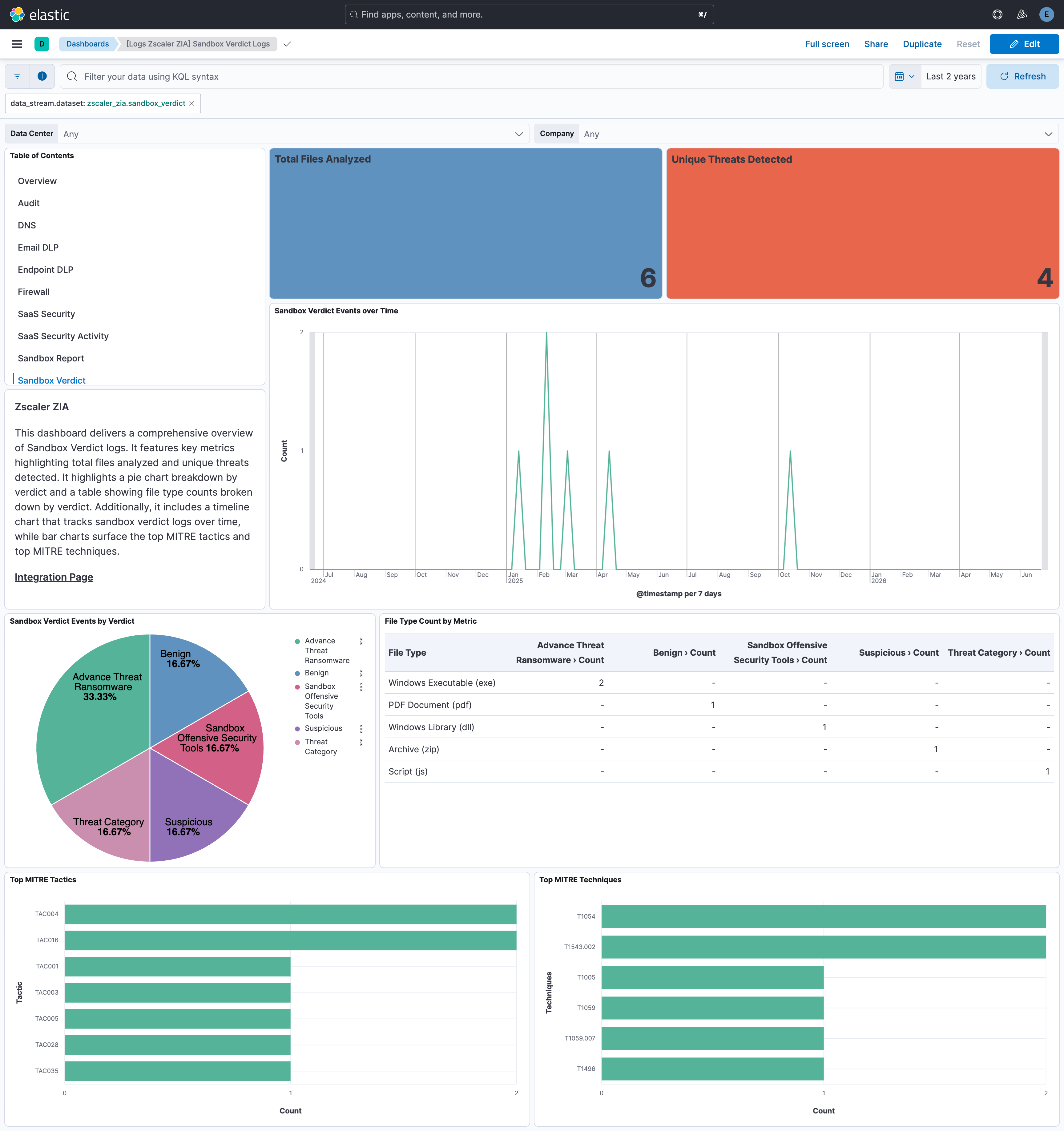

This is the sandbox_verdict dataset.
Example
"@timestamp": "2025-01-15T09:30:01.000Z",
"agent": {
"ephemeral_id": "8c5aa7f2-e5ab-4a15-96ba-67e0b9f3602c",
"id": "ddfaf50e-310f-4d90-b10f-92e616bec2f9",
"name": "elastic-agent-29786",
"type": "filebeat",
"version": "8.18.0"
"data_stream": {
"dataset": "zscaler_zia.sandbox_verdict",
"namespace": "93269",
"type": "logs"
"ecs": {
"version": "8.11.0"
"elastic_agent": {
"snapshot": false,
"version": "8.18.0"
"event": {
"category": [
"malware"
"id": "7353686396818817200",
"ingested": "2026-06-23T05:25:43Z",
"kind": "event",
"original": "{\"analysis_completed_time\":\"Wed Jan 15 09:30:01 2025\",\"company\":{\"name\":\"Example Corp\"},\"datacenter\":{\"city\":\"Sydney\",\"country\":\"AU\",\"name\":\"Sydney\"},\"event_time\":\"Wed Jan 15 09:30:03 2025\",\"feed_time\":\"Wed Jan 15 09:30:04 2025\",\"file\":{\"ba_md5_url\":\"zsapi/v1/baSso?md5ReportId=098f6bcd4621d373cade4e832627b4f6\\u0026sourceURL=admin.example.net/\",\"extension\":\"zip\",\"hash\":{\"children_md5\":\"5d41402abc4b2a76b9719d911017c592|aab3238922bcc25a6f606eb525ffdc56\",\"md5\":\"098f6bcd4621d373cade4e832627b4f6\",\"sha256\":\"9f86d081884c7d659a2feaa0c55ad015a3bf4f1b2b0b822cd15d6c15b0f00a08\"},\"type_category\":\"Archive (zip)\"},\"record_id\":\"7353686396818817200\",\"sourcetype\":\"zscalernss-sandbox_verdict\",\"threat\":{\"indicator\":{\"name\":\"Suspicious.Generic\"},\"tactic\":{\"id\":\"TAC001\"},\"technique\":{\"id\":\"T1059\"}},\"time\":\"Wed Jan 15 09:30:01 2025\",\"tz\":\"GMT\",\"verdict\":\"Suspicious\",\"version\":\"v1\"}",
"timezone": "GMT",
"type": [
"info"
"file": {
"extension": "zip",
"hash": {
"md5": "098f6bcd4621d373cade4e832627b4f6",
"sha256": "9f86d081884c7d659a2feaa0c55ad015a3bf4f1b2b0b822cd15d6c15b0f00a08"
"input": {
"observer": {
"geo": {
"city_name": "Sydney",
"country_iso_code": "AU",
"name": "Sydney"
"name": "Sydney",
"vendor": "Zscaler"
"organization": {
"related": {
"hash": [
"9f86d081884c7d659a2feaa0c55ad015a3bf4f1b2b0b822cd15d6c15b0f00a08",
"5d41402abc4b2a76b9719d911017c592",

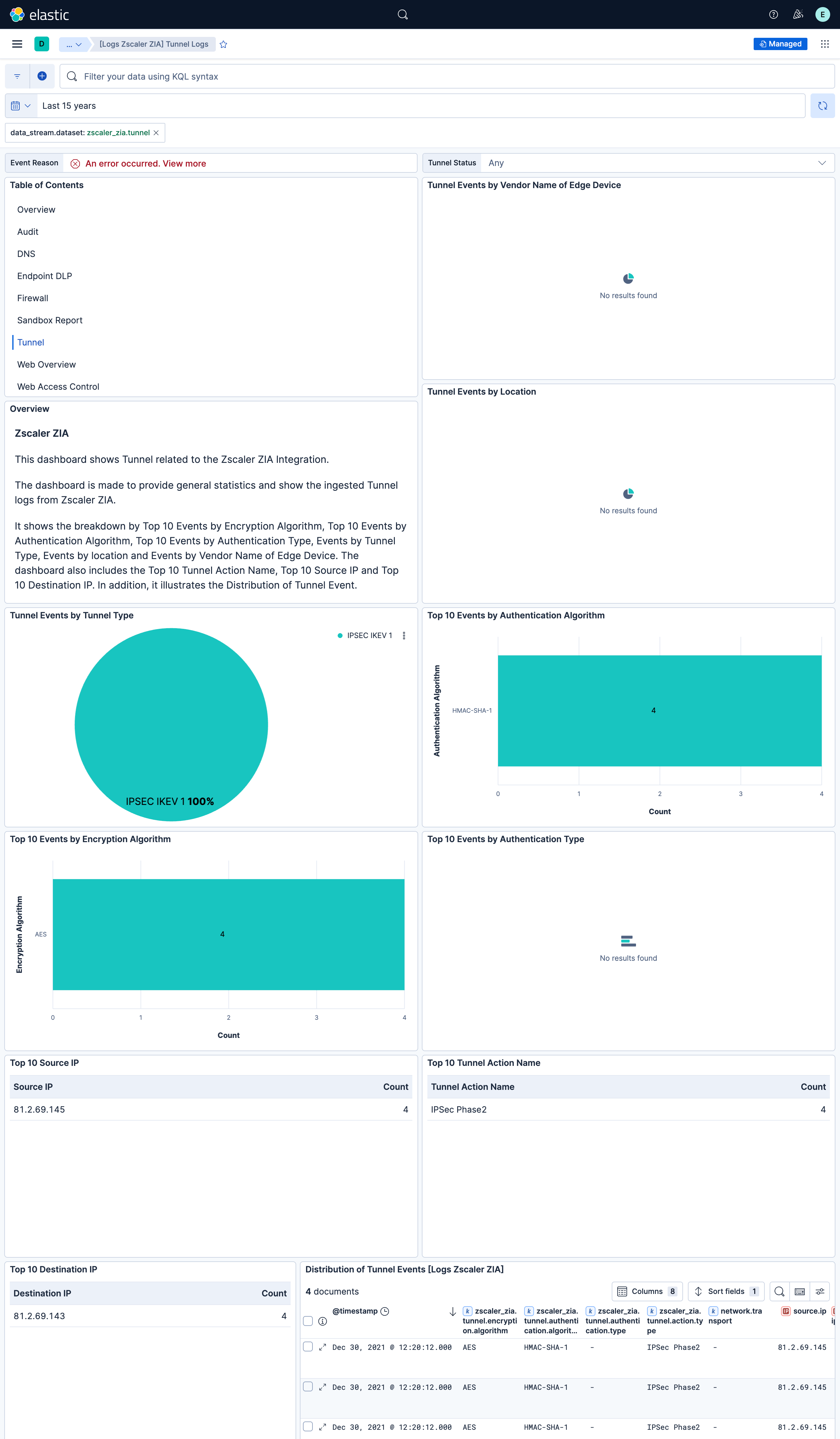

This is the tunnel dataset.
Example
"@timestamp": "2021-12-30T11:20:12.000Z",
"agent": {
"ephemeral_id": "85f8a4ec-94a7-4111-9cab-36896851bb15",
"id": "7a8d18bc-b73c-424e-a30b-120ddeb66eeb",
"name": "docker-fleet-agent",
"type": "filebeat",
"version": "8.13.0"
"data_stream": {
"dataset": "zscaler_zia.tunnel",
"namespace": "ep",
"type": "logs"
"destination": {
"ip": "81.2.69.143"
"ecs": {
"version": "8.11.0"
"elastic_agent": {
"snapshot": false,
"version": "8.13.0"
"event": {
"category": [
"network"
"id": "1111111111111111111",
"ingested": "2024-07-04T12:10:30Z",
"kind": "event",
"timezone": "UTC",
"type": [
"info"
"input": {
"type": "tcp"
"log": {
"source": {
"address": "192.168.243.6:36470"
"related": {
"ip": [
"81.2.69.143",
"81.2.69.145"
"source": {
"ip": "81.2.69.145",
"port": 0
"tags": [
"forwarded",
"zscaler_zia-tunnel"
"zscaler_zia": {
"tunnel": {
"action": {
"type": "IPSec Phase2"
"authentication": {
"algorithm": "HMAC-SHA-1"
"destination": {
"end": {
"ip": "81.2.69.143"
"start": {
"ip": "81.2.69.143",
"port": 0
"encryption": {
"algorithm": "AES"
"ikeversion": "1",
"life": {
"bytes": 0,
"time": 3600
"policy": {
"protocol": "Any"
"protocol": "ESP",
"source": {
"end": {
"ip": "81.2.69.145"
"start": {
"port": 0
"spi": "123456789",
"type": "IPSEC IKEV 1",
"user_ip": "81.2.69.145"
Exported fields
| zscaler_zia.tunnel.action.type | The action type. | keyword |
| zscaler_zia.tunnel.authentication.algorithm | The authentication algorithm. | keyword |
| zscaler_zia.tunnel.authentication.type | The authentication type. | keyword |
| zscaler_zia.tunnel.bytes.received | The bytes received in a 60-second sample window by Zscaler from the customer. | long |
| zscaler_zia.tunnel.bytes.sent | The bytes transmitted in a 60-second sample window from Zscaler to the customer. | long |
| zscaler_zia.tunnel.datetime | The date and time of the event. | date |
| zscaler_zia.tunnel.day | The day of the week. | keyword |
| zscaler_zia.tunnel.day_of_month | The day of the month. | long |
| zscaler_zia.tunnel.destination.end.ip | Phase 2 policy proposal - Destination IP end. | ip |
| zscaler_zia.tunnel.destination.port | The tunnel destination port. | long |
| zscaler_zia.tunnel.destination.start.ip | Phase 2 policy proposal - Destination IP start. | ip |
| zscaler_zia.tunnel.destination.start.port | Phase 2 policy proposal - Destination port start. | long |
| zscaler_zia.tunnel.destination.vip.address | The tunnel destination VIP address. | ip |
| zscaler_zia.tunnel.dpd_packets | The number of DPD packets received in a 60-second sample window. | long |
| zscaler_zia.tunnel.encryption.algorithm | The encryption algorithm. | keyword |
| zscaler_zia.tunnel.event | The tunnel status. | keyword |
| zscaler_zia.tunnel.event_reason | The reason for the tunnel status change. | keyword |
| zscaler_zia.tunnel.hour | Hours. | long |
| zscaler_zia.tunnel.ikeversion | The IKE version. | keyword |
| zscaler_zia.tunnel.life.bytes | Life bytes. | long |
| zscaler_zia.tunnel.life.time | The lifetime of IKE Phase 2 (seconds). | long |
| zscaler_zia.tunnel.locationname | The location name. | keyword |
| zscaler_zia.tunnel.minute | Minutes. | long |
| zscaler_zia.tunnel.month | The name of the month. | keyword |
| zscaler_zia.tunnel.month_of_year | The month of the year. | long |
| zscaler_zia.tunnel.obfuscated.location_name | The obfuscated version of the location name. | keyword |
| zscaler_zia.tunnel.obfuscated.vpn_credential_name | The obfuscated version of the VPN credential name for the IPSec tunnel. | keyword |
| zscaler_zia.tunnel.packets.received | The packets received in a 60-second sample window by Zscaler from the customer. | long |
| zscaler_zia.tunnel.packets.sent | The packets transmitted in a 60-second sample window from Zscaler to the customer. | long |
| zscaler_zia.tunnel.policy.protocol | Phase 2 policy proposal - Protocol. | keyword |
| zscaler_zia.tunnel.protocol | The IPSec tunnel protocol type. | keyword |
| zscaler_zia.tunnel.record.id | The unique record identifier for each log. | keyword |
| zscaler_zia.tunnel.second | Seconds. | long |
| zscaler_zia.tunnel.source.end.ip | Phase 2 policy proposal - Source IP end. | ip |
| zscaler_zia.tunnel.source.ip | The tunnel source IP address. | ip |
| zscaler_zia.tunnel.source.port | The tunnel source port. | long |
| zscaler_zia.tunnel.source.start.ip | Phase 2 policy proposal - Source IP start. | ip |
| zscaler_zia.tunnel.source.start.port | Phase 2 policy proposal - Source port start. | long |
| zscaler_zia.tunnel.spi | The Security Parameter Index. | keyword |
| zscaler_zia.tunnel.spi_in | The initiator cookie. | keyword |
| zscaler_zia.tunnel.spi_out | The responder cookie. | keyword |
| zscaler_zia.tunnel.timezone | The time zone. | keyword |
| zscaler_zia.tunnel.type | The tunnel type. | keyword |
| zscaler_zia.tunnel.user_ip | ip | |
| zscaler_zia.tunnel.vendor.name | The vendor name of the edge device. | keyword |
| zscaler_zia.tunnel.vpn_credential_name | The VPN credential name for the IPSec tunnel. | keyword |
| zscaler_zia.tunnel.year | Year. | long |
