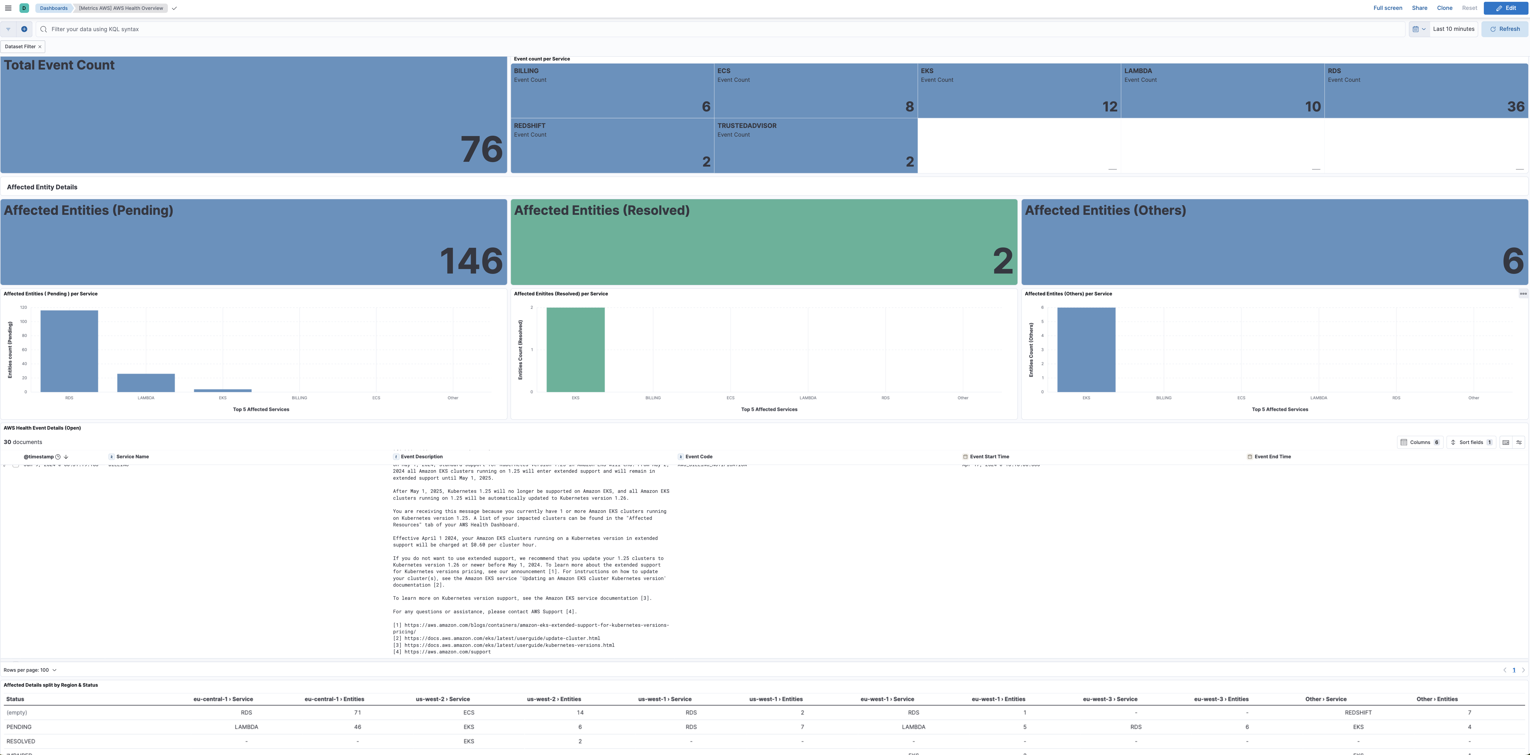

AWS Health metrics provide insights into the health of your AWS environment by monitoring various aspects such as open issues, scheduled maintenance events, security advisories, compliance status, notification counts, and service disruptions. These metrics help you proactively identify and address issues impacting your AWS resources, ensuring the reliability, security, and compliance of your infrastructure.
The AWS Health integration collects one type of data: metrics.
Metrics provide insight into the operational health of your AWS environment, including the status of AWS services, scheduled changes, and notifications about potential issues that could impact your resources. Metrics are gathered with the AWS Health API
Check more details in the Metrics reference.
