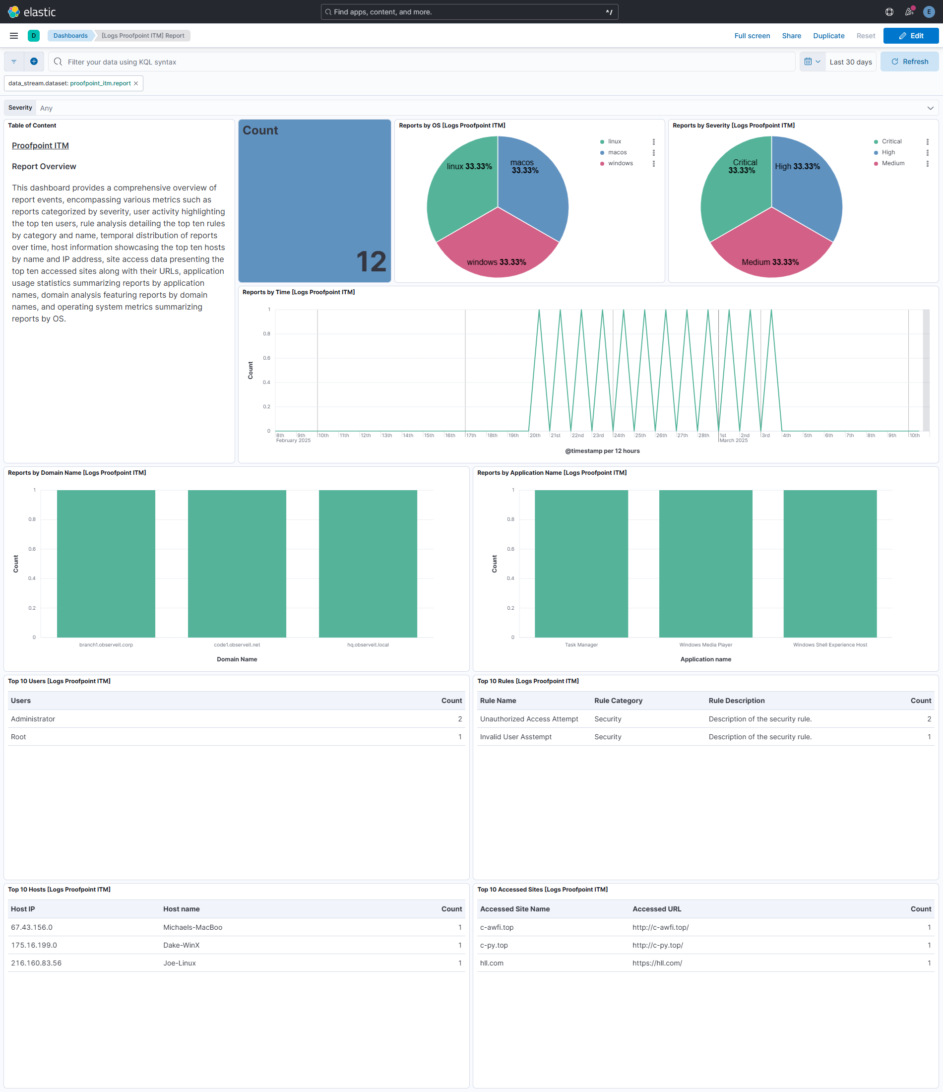

Reports - This data stream enables users to retrieve reports from Proofpoint ITM, including the following log types:
User activity
DBA activity
System events
Alerts activity
Audit activity
In-App elements
