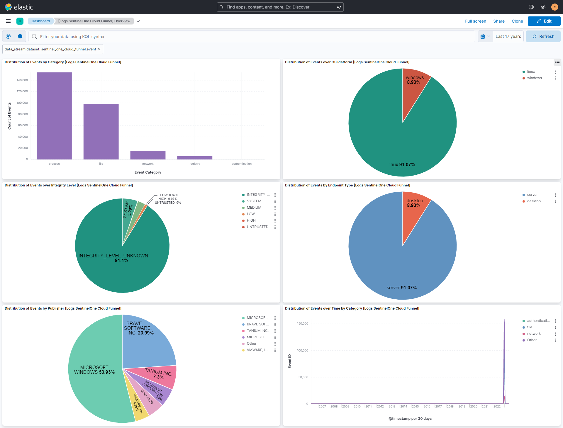

The SentinelOne Cloud Funnel integration collects logs for the following thirteen events:
| Event Type |
| Command Script |

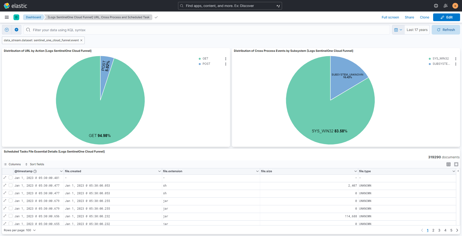

| Cross Process |
| DNS |
| File |
| Indicator |

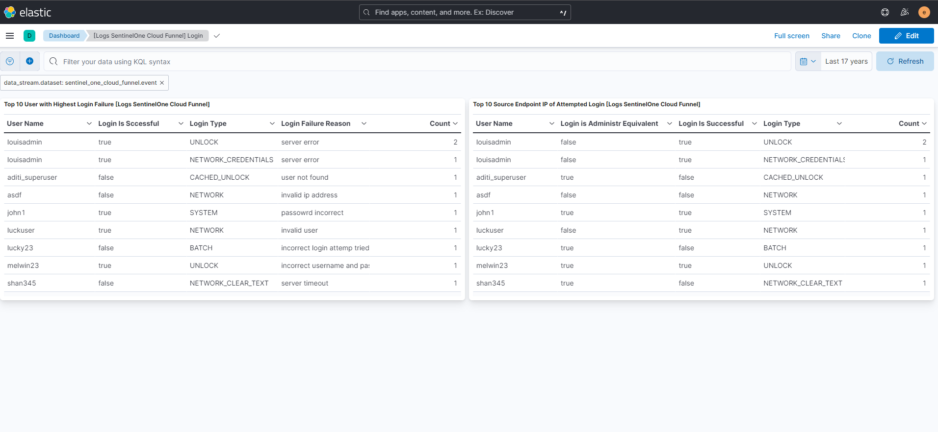

| Login |
| Module |

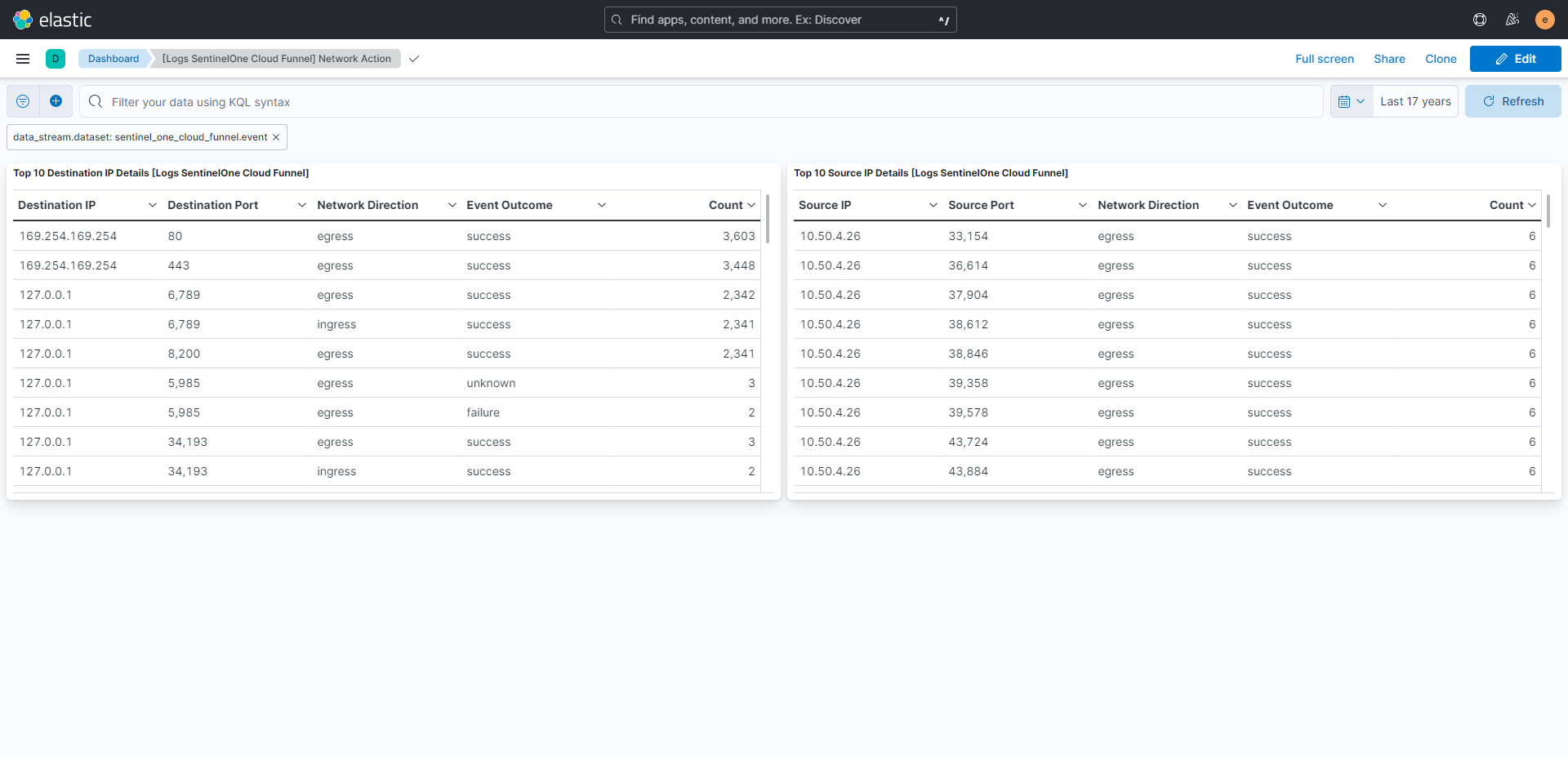

| Network Action |
| Process |

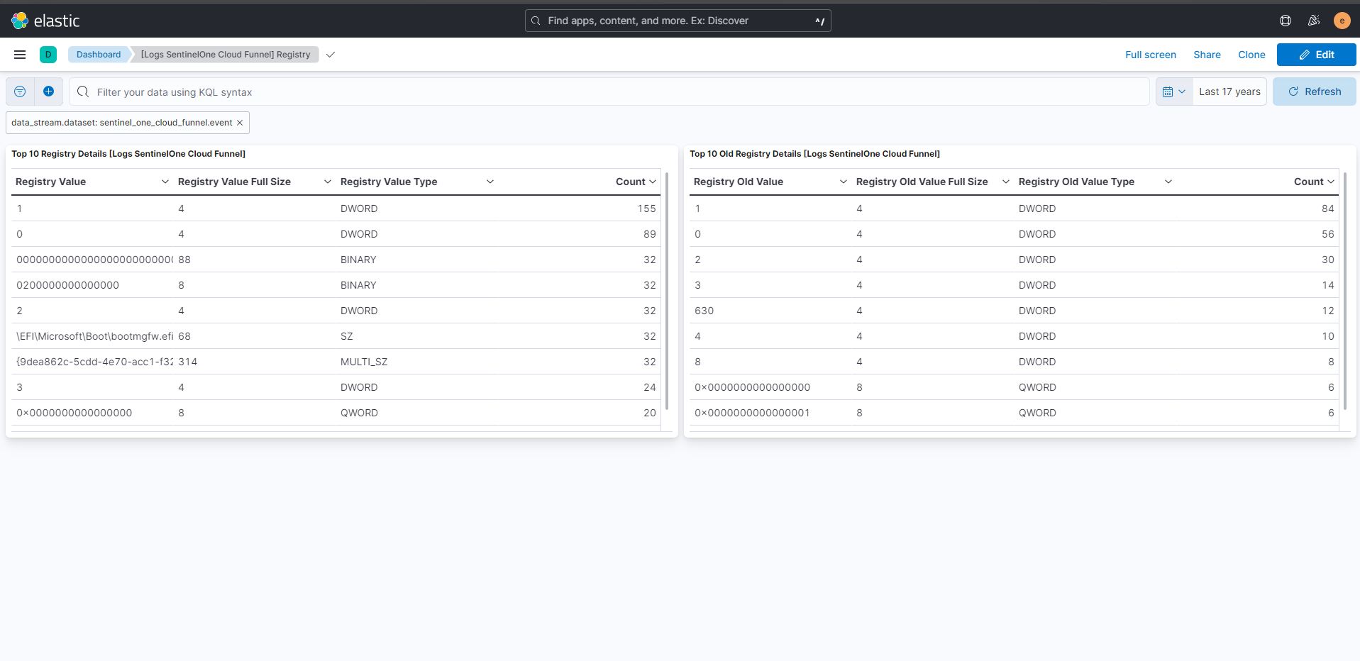

| Registry |
| Scheduled Task |

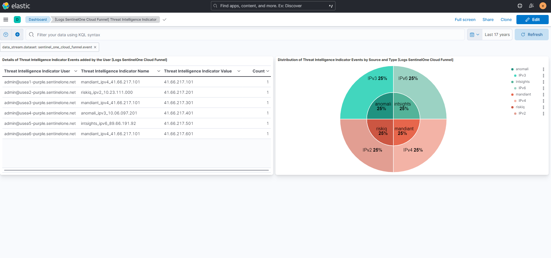

| Threat Intelligence Indicator |
| URL |
