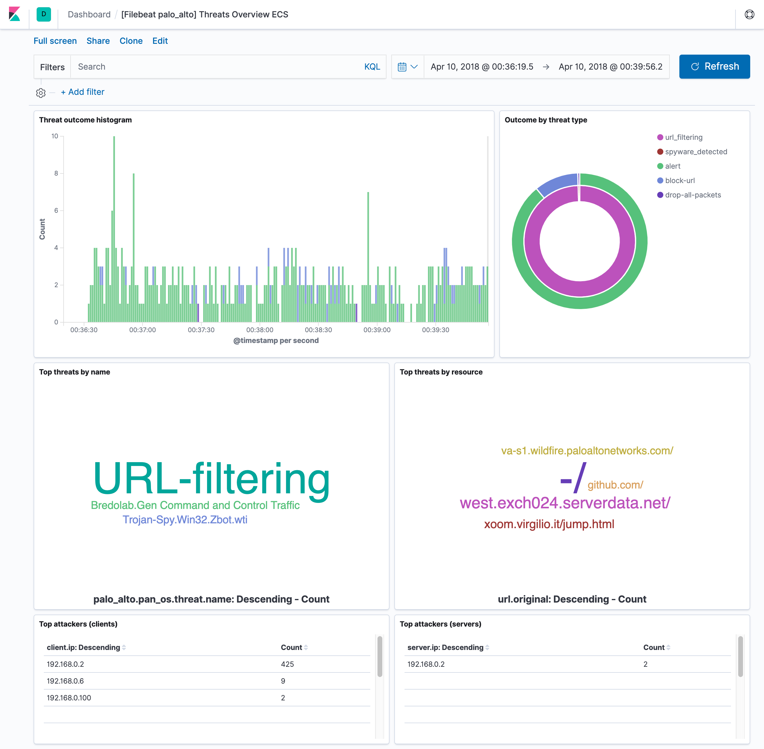

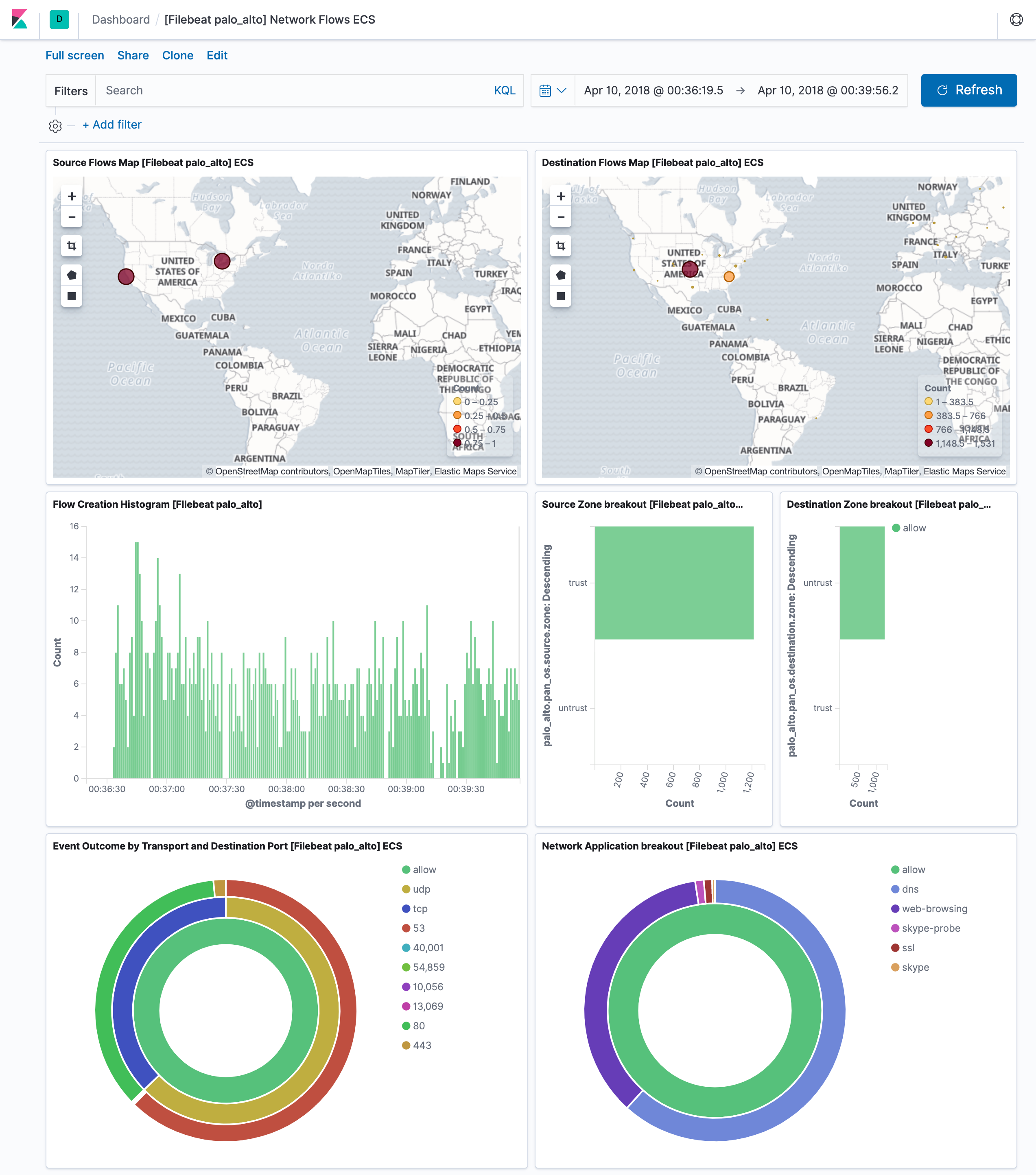

This module comes with two sample dashboards:
filebeat panw traffic
filebeat panw threat
