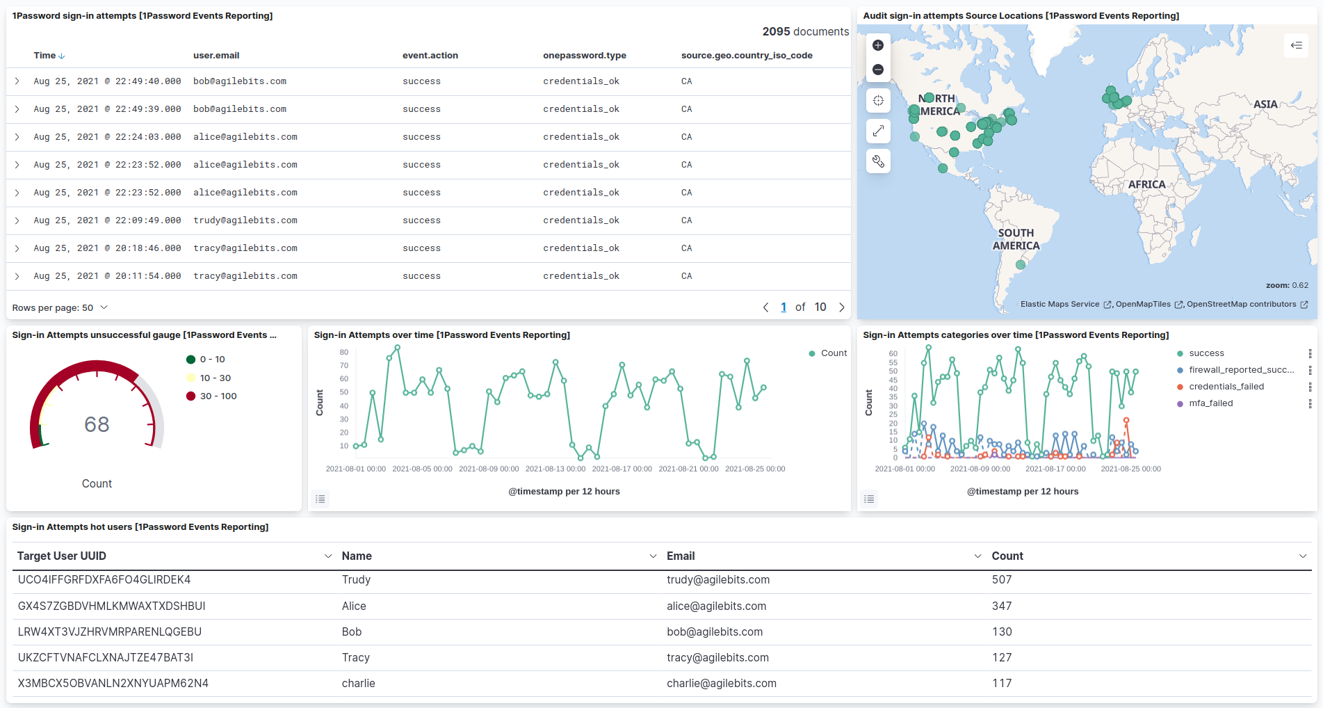

Use the 1Password Events API to retrieve information about sign-in attempts. Events include the name and IP address of the user who attempted to sign in to the account, when the attempt was made, and – for failed attempts – the cause of the failure.

| event.dataset | Event dataset | constant_keyword |
| event.module | Event module | constant_keyword |
| input.type | Input type | keyword |
| onepassword.client.app_name | The name of the 1Password app that attempted to sign in to the account | keyword |
| onepassword.client.app_version | The version number of the 1Password app | keyword |
| onepassword.client.platform_name | The name of the platform running the 1Password app | keyword |
| onepassword.client.platform_version | The version of the browser or computer where the 1Password app is installed, or the CPU of the machine where the 1Password command-line tool is installed | keyword |
| onepassword.country | The country code of the event. Uses the ISO 3166 standard | keyword |
| onepassword.details.value | keyword | |
| onepassword.session_uuid | The UUID of the session that created the event | keyword |
| onepassword.type | Details about the sign-in attempt | keyword |
| onepassword.uuid | The UUID of the event | keyword |

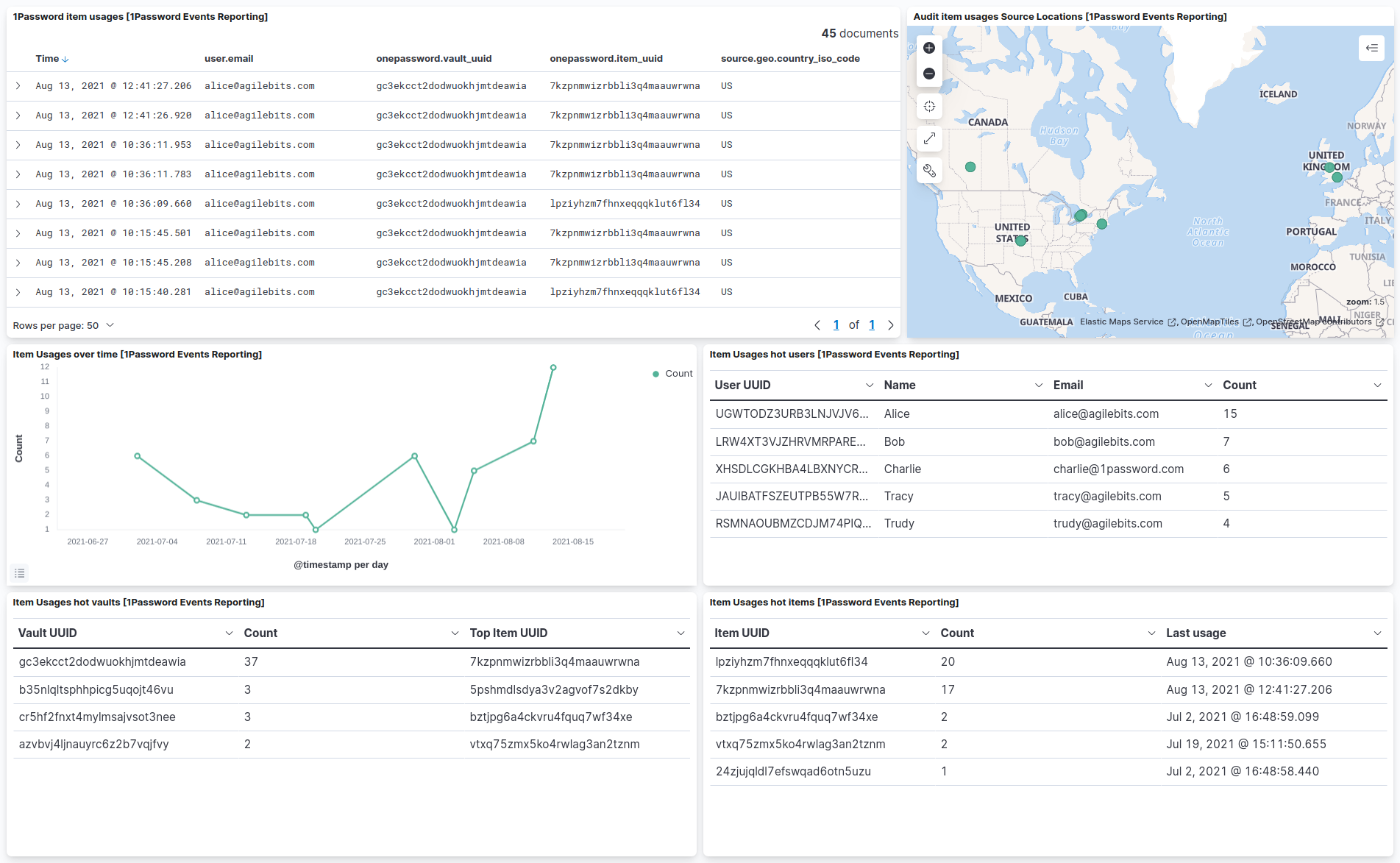

This uses the 1Password Events API to retrieve information about items in shared vaults that have been modified, accessed, or used. Events include the name and IP address of the user who accessed the item, when it was accessed, and the vault where the item is stored.
Exported fields
| onepassword.client.app_name | The name of the 1Password app the item was accessed from | keyword |
| onepassword.client.platform_name | The name of the platform the item was accessed from | keyword |
| onepassword.item_uuid | The UUID of the item that was accessed | keyword |
| onepassword.used_version | The version of the item that was accessed | integer |
| onepassword.vault_uuid | The UUID of the vault the item is in | keyword |
