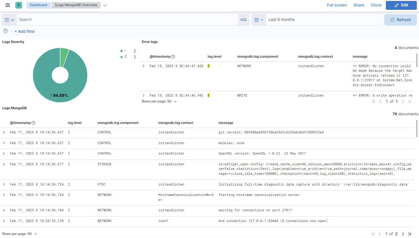

The log dataset collects the MongoDB logs.
Example
"@timestamp": "2022-12-16T07:30:07.376Z",
"agent": {
"ephemeral_id": "d4efa095-1892-409c-96cf-691d6307b15b",
"id": "4729bacd-4e52-4243-ae58-793424154f42",
"name": "docker-fleet-agent",
"type": "filebeat",
"version": "8.5.0"
"data_stream": {
"dataset": "mongodb.log",
"namespace": "ep",
"type": "logs"
"ecs": {
"version": "8.11.0"
"elastic_agent": {
"snapshot": false,
"version": "8.5.0"
"event": {
"category": [
"database"
"created": "2022-12-16T07:30:25.369Z",
"ingested": "2022-12-16T07:30:26Z",
"kind": "event",
"type": [
"info"
"host": {
"architecture": "x86_64",
"containerized": false,
"hostname": "docker-fleet-agent",
"id": "66392b0697b84641af8006d87aeb89f1",
"ip": [
"172.18.0.7"
"mac": [
"02-42-AC-12-00-07"
"os": {
"codename": "focal",
"family": "debian",
"kernel": "5.15.49-linuxkit",
"name": "Ubuntu",
"platform": "ubuntu",
"type": "linux",
"version": "20.04.5 LTS (Focal Fossa)"
"input": {
"type": "log"
"log": {
"file": {
"path": "/tmp/service_logs/mongodb.log"
"level": "I",
"offset": 0
"message": "***** SERVER RESTARTED *****",
"mongodb": {
"log": {
"component": "CONTROL",
"context": "main"
"related": {
"hosts": [
"tags": [
"mongodb-logs"

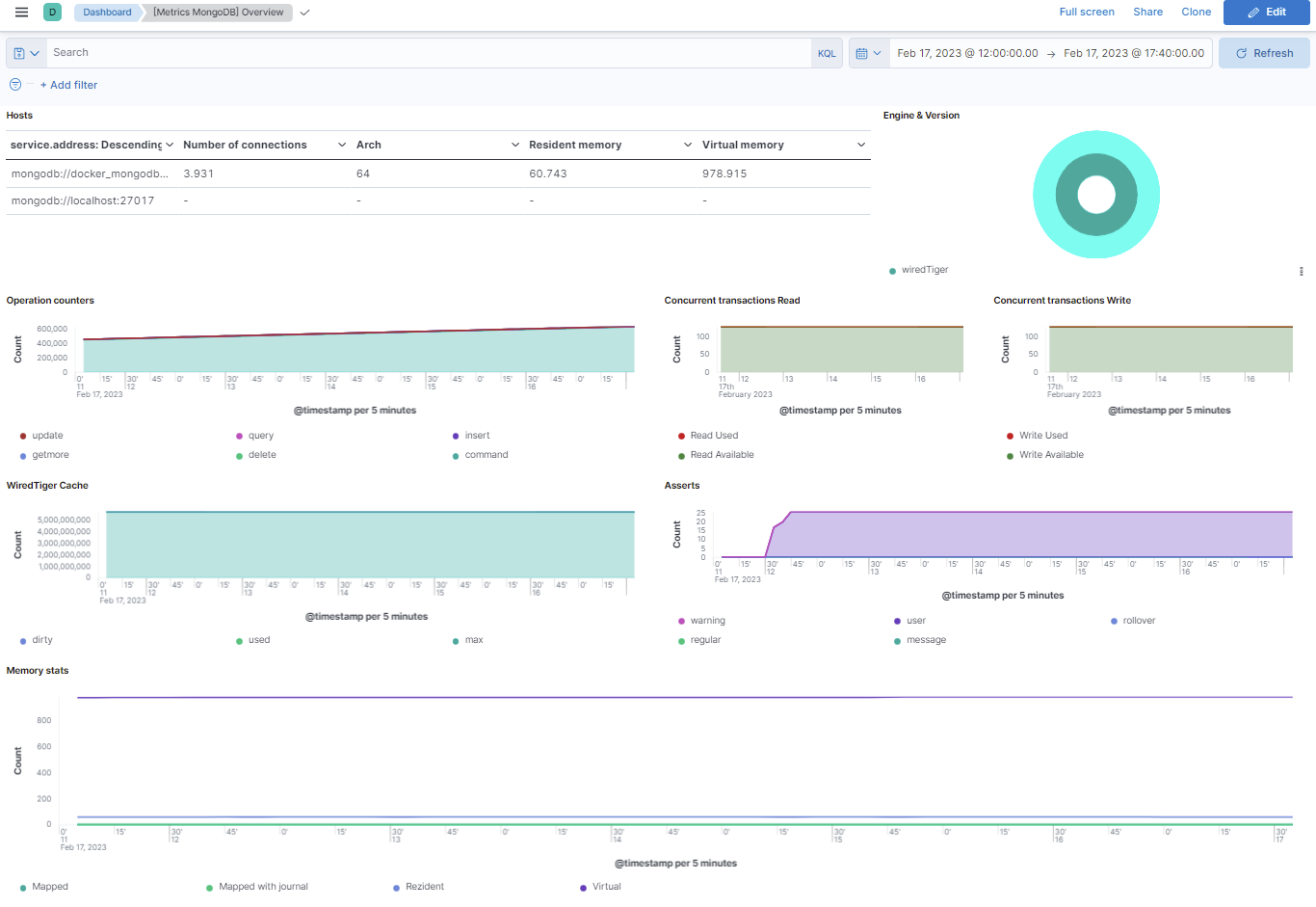

The collstats dataset uses the top administrative command to return usage
statistics for each collection. It provides the amount of time, in microseconds,
used and a count of operations for the following types: total, readLock, writeLock,
queries, getmore, insert, update, remove, and commands.
It requires the following privileges, which is covered by the clusterMonitor role:
Example
