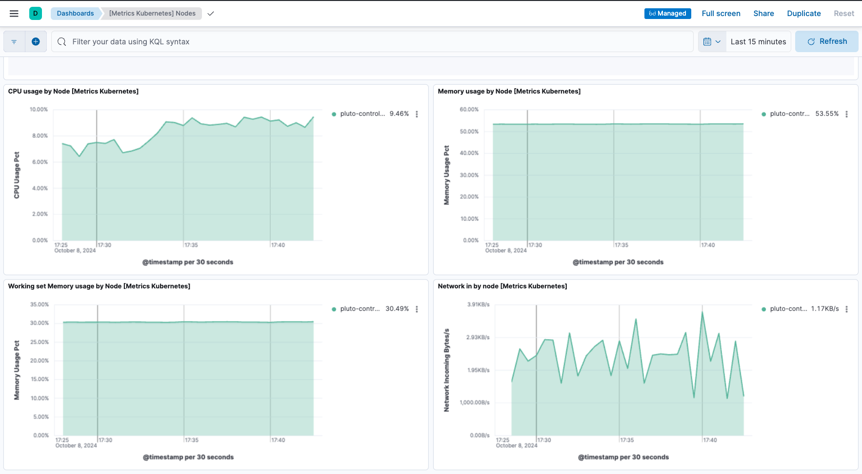

  4. On the Kubernetes integration page, open the Assets tab and select the [Metrics Kubernetes] Nodes dashboard.
    On the dashboard, you can view the status of your Kubernetes nodes, including metrics on memory, CPU, and filesystem usage, network throughput, and more.
    Screen capture of the Metrics Kubernetes nodes dashboard

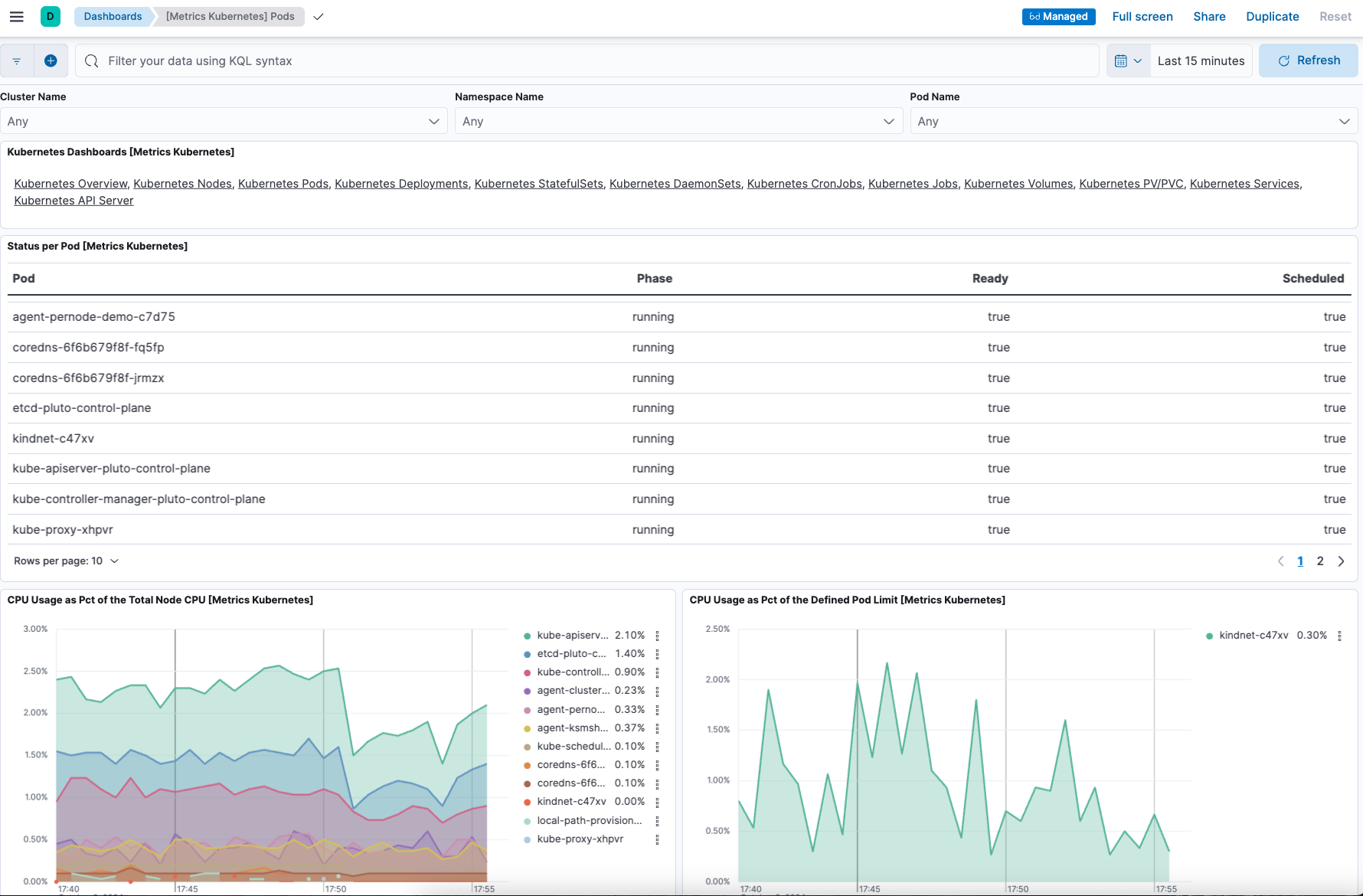

  5. On the Kubernetes integration page, open the Assets tab and select the [Metrics Kubernetes] Pods dashboard. As with the nodes dashboard, on this dashboard you can view the status of your Kubernetes pods, including various metrics on memory, CPU, and network throughput.
    Screen capture of the Metrics Kubernetes pods dashboard
