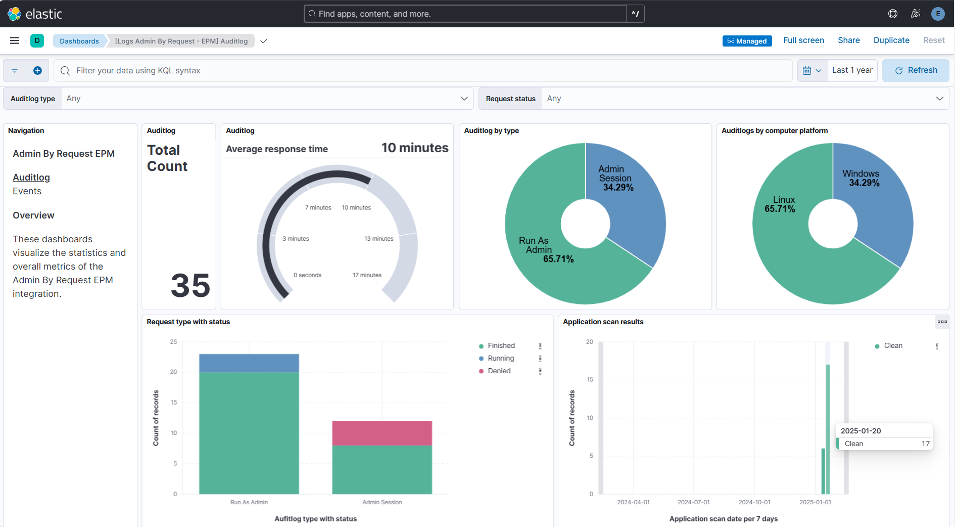

The Elastic integration for Admin By Request EPM enables real-time monitoring and analysis of audit logging of privilege elevations, software installations and administrative actions through user portal. This integration collects, processes, and visualizes audit logs and events to enhance security posture, compliance, and operational efficiency.
auditlog
: Provides audit data that includes elevation requests, approvals, application installations, and scan results.Auditlog are records generated when user takes action such as installing a software, running an application with admin privileges, requesting for admin session, approval or denial of requests and scan results.

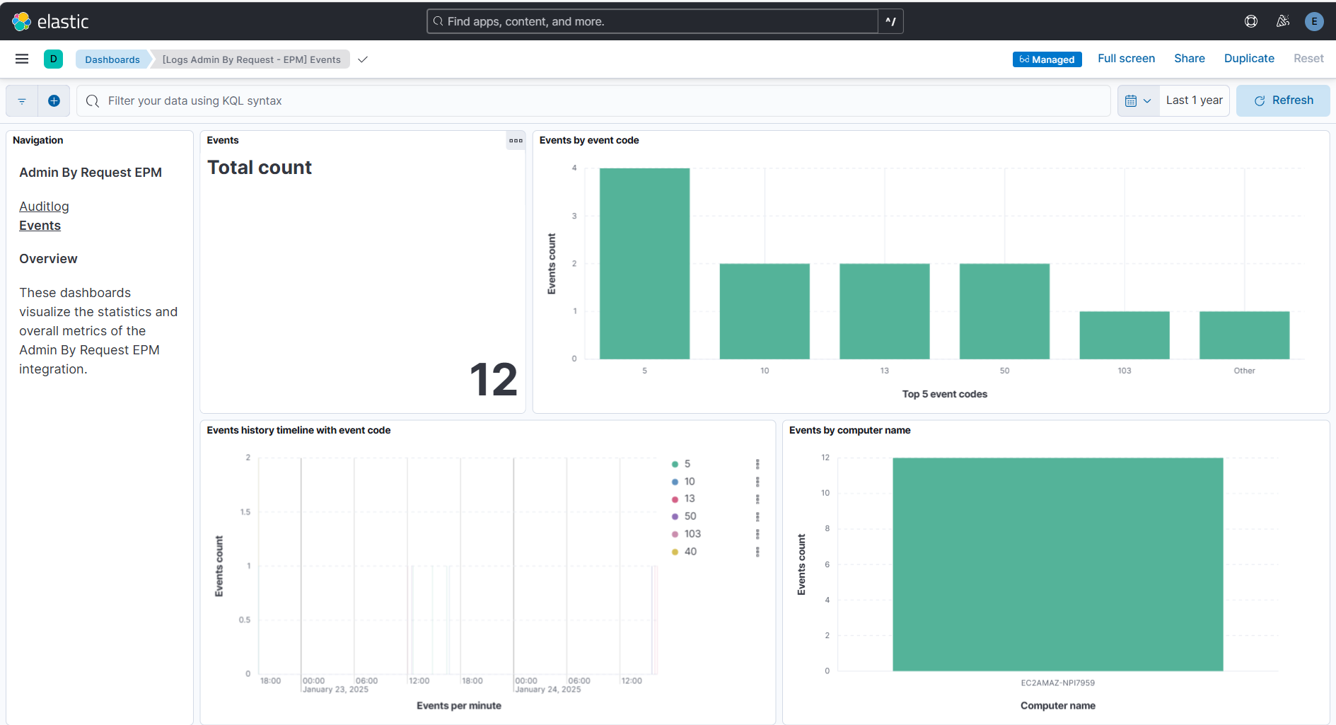

endpoint to retrieve data.events
: Provides system security events and administrative changes, including group modifications, policy changes and security violations. This allows tracking of administrative activities and security-critical events. Some events have corresponding audit log entries.Events are records that are generated on various actions done by users and administrators. These include group modifications, policy changes, security violations, and other administrative activities.
This data stream leverages the Admin By Request EPM API
/events

Auditlog documents can be found by setting the following filter:
event.dataset : "admin_by_request_epm.auditlog"
Example

Event documents can be found by setting the following filter:
event.dataset : "admin_by_request_epm.events"
Example
