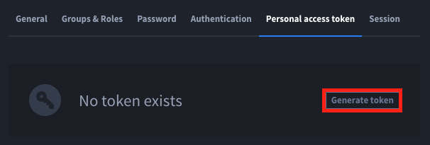

Generate a personal access token for an administrator user.

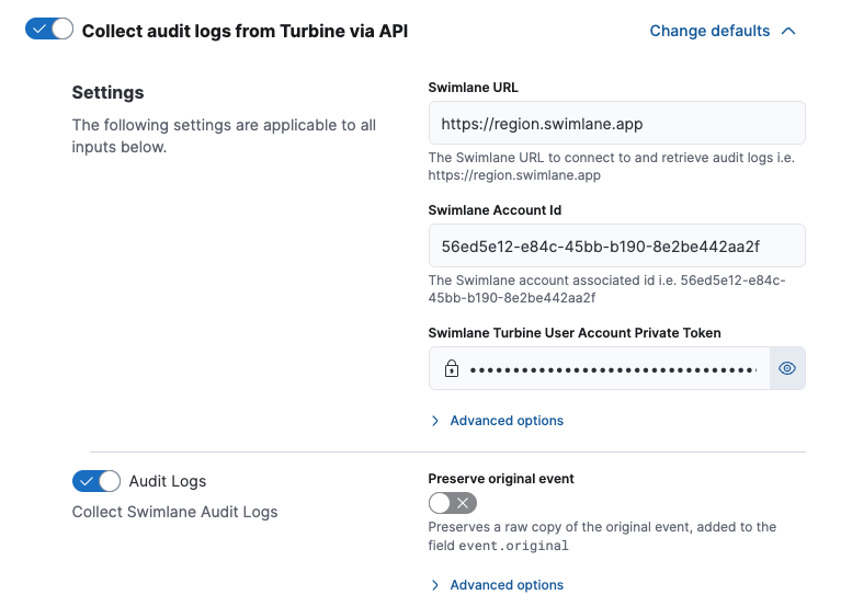

Configure the settings page with your Turbine Cloud URL, Account Id, and Private Token

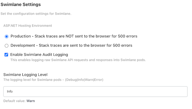

TPI settings can be configured in the administrator dashboard as seen below:
The following environment variables will need to be set for Audit logs to be outputted into the container pod logs.
swimlane-api & swimlane-tenant:
"SWIMLANE_Logging__Level=Info"
"SWIMLANE_Logging__IncludeAudit=true"
turbine-api:
"LOG_LEVEL_API=info"
"LOG_LEVEL_DEFAULT=info"
"LOG_LEVEL_SYSTEM=info"
"LOG_FILES_ENABLED=false"
