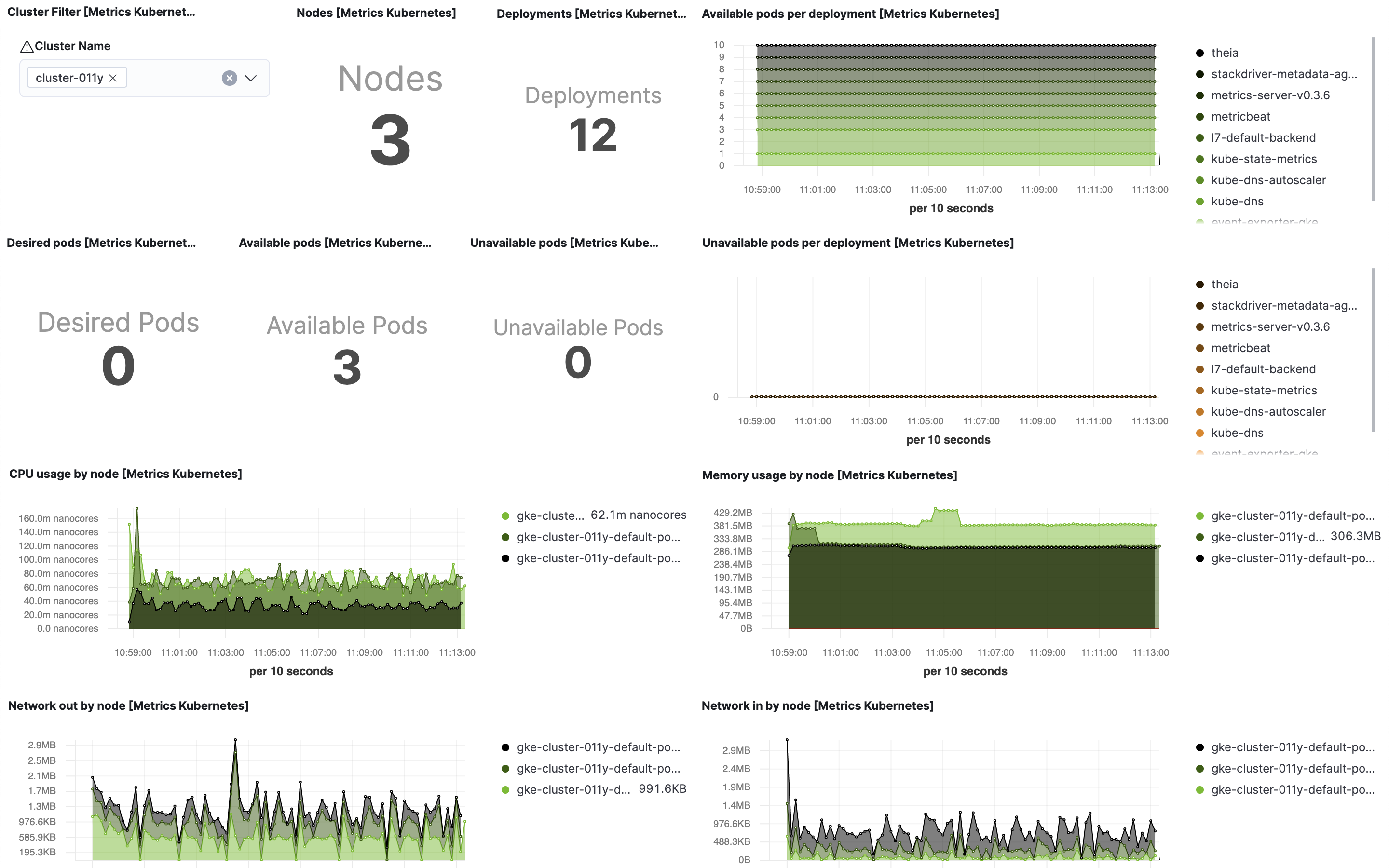

Kubernetes integration is shipped including default dashboards for apiserver, controllermanager, overview, proxy and scheduler.
If you are using HA for those components, be aware that when gathering data from all instances the dashboard will usually show the average of the metrics. For those scenarios filtering by hosts or service address is possible.
Cluster selector in overview dashboard helps in distinguishing and filtering metrics collected from multiple clusters. If you want to focus on a subset of the Kubernetes clusters for monitoring a specific scenario, this cluster selector could be a handy tool. Note that this selector gets populated from the orchestrator.cluster.name field that may not always be available. This field gets its value from sources like kube_config, kubeadm-config configMap, and Google Cloud's meta API for GKE. If the sources mentioned above don't provide this value, metricbeat will not report it. However, you can always use processors to set this field and utilize it in the cluster overview dashboard.
