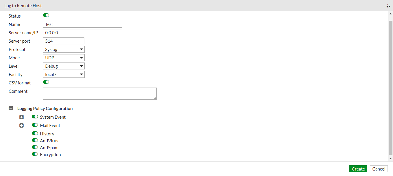

This module has been tested against Fortinet FortiMail version 7.2.2.
The User must have to Enable CSV format option.
