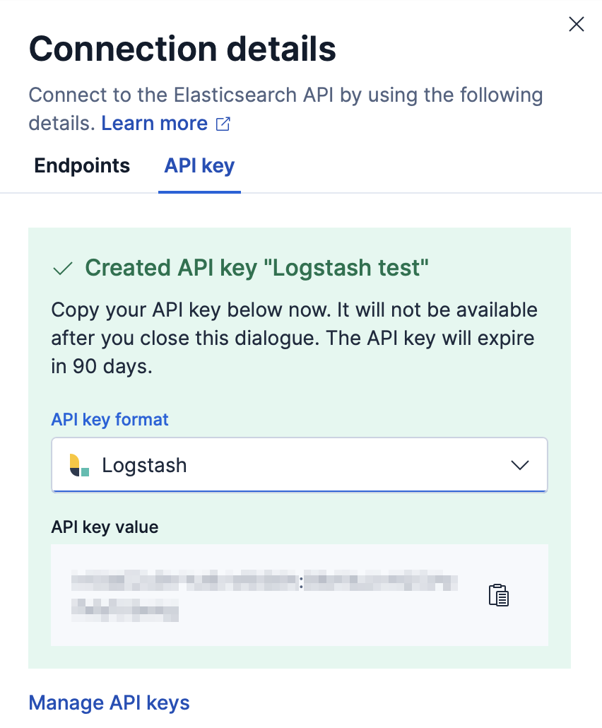

Instead of using usernames and passwords, you can use API keys to grant access to Elasticsearch resources. You can set API keys to expire at a certain time, and you can explicitly invalidate them. Any user with the manage_api_key or manage_own_api_key cluster privilege can create API keys.
Tips for creating API keys:
  • API keys are tied to the cluster they are created in. If you are sending output to different clusters, be sure to create the correct kind of API key.
  • Logstash can send both collected data and monitoring information to Elasticsearch. If you are sending both to the same cluster, you can use the same API key. For different clusters, you need an API key per cluster.
  • A single cluster can share a key for ingestion and monitoring purposes.
  • A production cluster and a monitoring cluster require separate keys.
Note
For security reasons, we recommend using a unique API key per Logstash instance. You can create as many API keys per user as necessary.
You can create API keys using either the Create API key API or the Kibana UI. This section walks you through creating an API key using the Create API key API. The privileges needed are the same for either approach.
Here is an example that shows how to create an API key for publishing to Elasticsearch using the Elasticsearch output plugin.
 POST /_security/api_key {

You’re in luck! The example we used in the Create an API key section creates an API key for publishing to Elasticsearch using the Elasticsearch output plugin.
Here’s an example using the API key in your Elasticsearch output plugin configuration.
output {
  elasticsearch {
    api_key => "TiNAGG4BaaMdaH1tRfuU:KnR6yE41RrSowb0kQ0HWoA"
  1. Format is id:api_key (as returned by Create API key)
