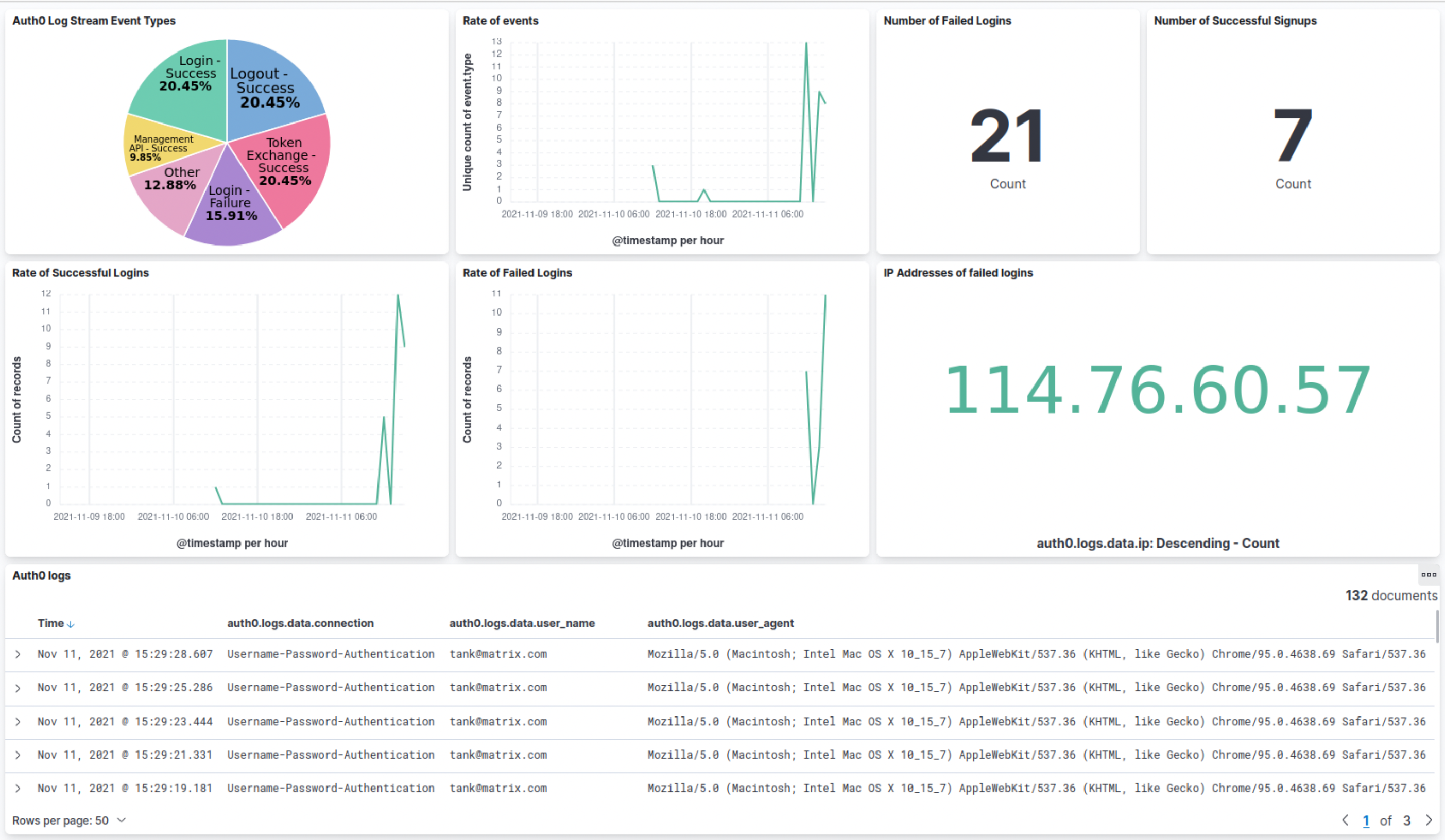

The Auth0 logs dataset provides events from Auth0 log stream. All Auth0 log events are available in the auth0.logs field group.
