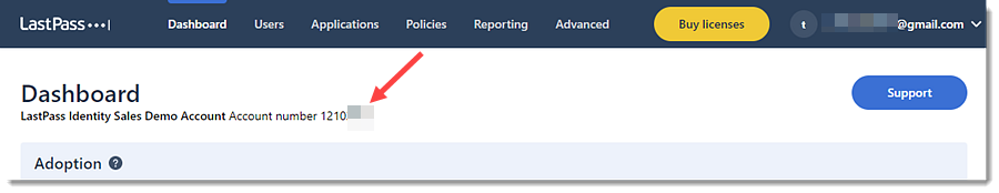

- To get an Account Number(CID), follow the below steps:
- On the Dashboard tab, the Account Number(CID) is located at the top of the page. it is preceded by the words Account number.

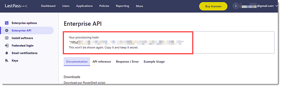

- To create a Provisioning Hash, follow the below steps:
- Go to Advanced -> Enterprise API.
- Choose from the following options:
- If the user has not previously created a provisioning hash, click Create provisioning hash -> OK, then the provisioning hash is shown at the top of the page.
- If the user previously created a provisioning hash but has since forgotten it, the user can generate a new one.
- NOTE: If the user has already created a provisioning hash, then generating a new one will invalidate the previous hash, and will require updating all integrations with the newly generated hash.
- To proceed with creating a new provisioning hash, click Reset your provisioning hash -> OK, then a new provisioning hash is shown at the top of the page.
