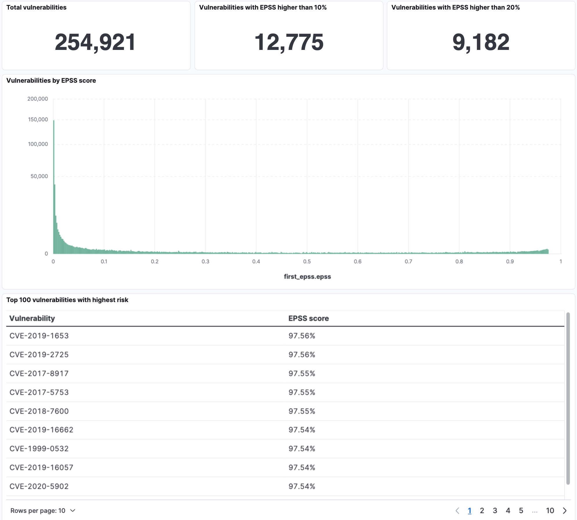

The First EPSS integration allows users to retrieve EPSS score from First EPSS API.
The Exploit Prediction Scoring System (EPSS) is a data-driven effort for estimating the likelihood (probability) that a software vulnerability (CVE) will be exploited in the wild.

The First EPSS integration collects one type of data stream: vulnerability
EPSS scores are retrieved via the First EPSS API (https://api.first.org/data/v1/epss).
The package ships a latest transform that maintains the most recent EPSS score per CVE in the lookup index logs-first_epss_latest.vulnerability. The full EPSS catalog is re-ingested on every poll cycle, so the same CVE is re-ingested repeatedly with updated scores. The transform collapses those snapshots into the latest row per CVE, making it the preferred enrichment path.
You can enrich vulnerability findings at query time with the ES|QL LOOKUP JOIN command on vulnerability.id:
FROM logs-endpoint.vulnerability-*
| LOOKUP JOIN logs-first_epss_latest.vulnerability ON vulnerability.id
| KEEP vulnerability.id, first_epss.vulnerability.epss, first_epss.vulnerability.percentile, first_epss.vulnerability.date
| WHERE first_epss.vulnerability.epss IS NOT NULL
