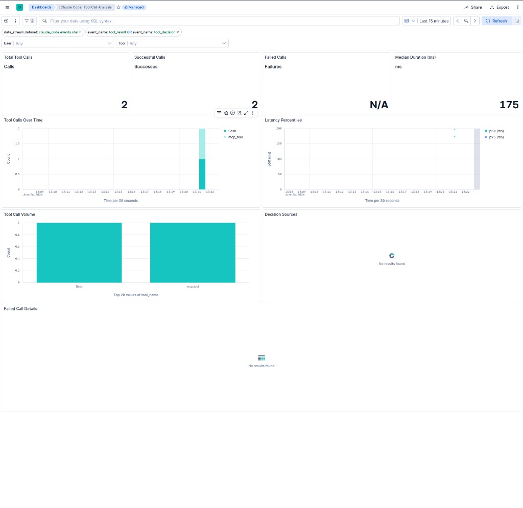

tool_result |
Tool execution outcome (success/failure, duration, parameters). | process |

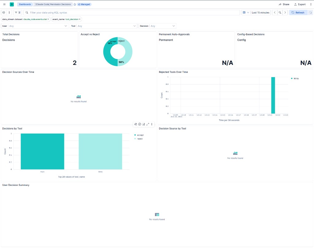

tool_decision |
Permission decision for a tool call (accept/reject, source). | process |

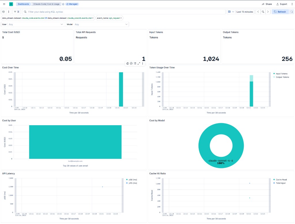

api_request |
API call to Anthropic (model, cost, tokens, duration). | web |

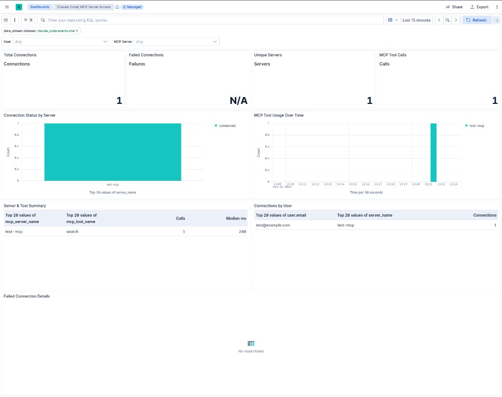

mcp_server_connection |
MCP server connection attempt (status, transport type). | network |

Tool invocation auditing — query all Bash commands executed by a user:
claude_code.tool_name: "Bash" AND event.action: "tool_result"
Permission decision analysis — find user_permanent auto-approvals (potential risk signal):
event.action: "tool_decision" AND claude_code.decision_source: "user_permanent"
Cost anomaly detection — aggregate cost_usd per user per day to detect unusual spending patterns.
MCP server access monitoring — track which MCP servers users connect to and which tools they invoke:
event.action: "mcp_server_connection" OR (event.action: "tool_result" AND claude_code.tool_name: "mcp_tool")
