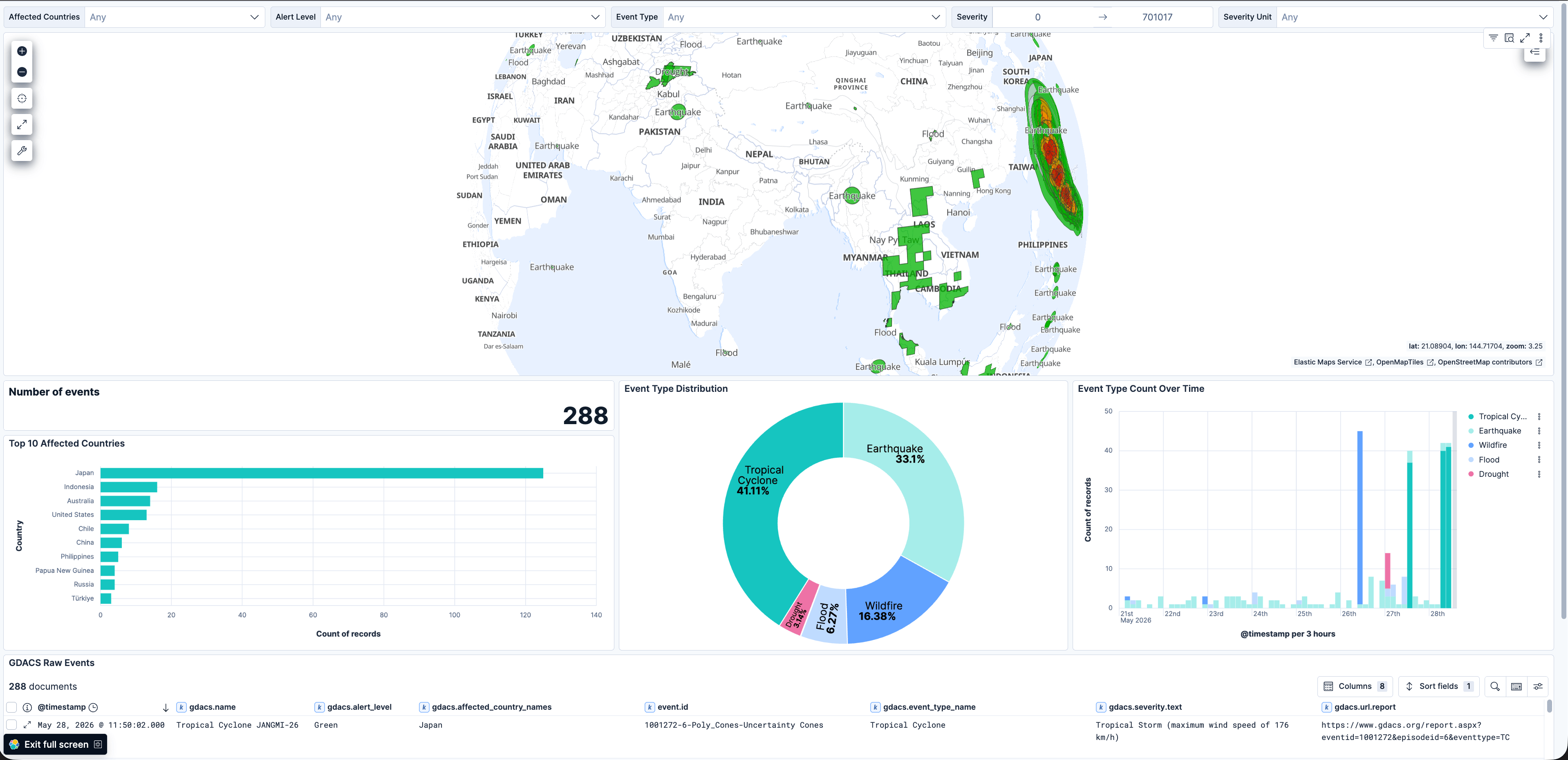

Each event includes alert level, severity data, geographic coordinates, affected-area polygons, affected countries, and links to GDACS report pages.
- Real-time situational awareness dashboards for natural disaster monitoring
- Geographic analysis of disaster impact zones using polygon overlays on maps
- Alerting on high-severity (Red/Orange) disaster events in specific regions or countries
- Correlation of disaster events with infrastructure or supply chain data
- Historical analysis of disaster patterns and trends
