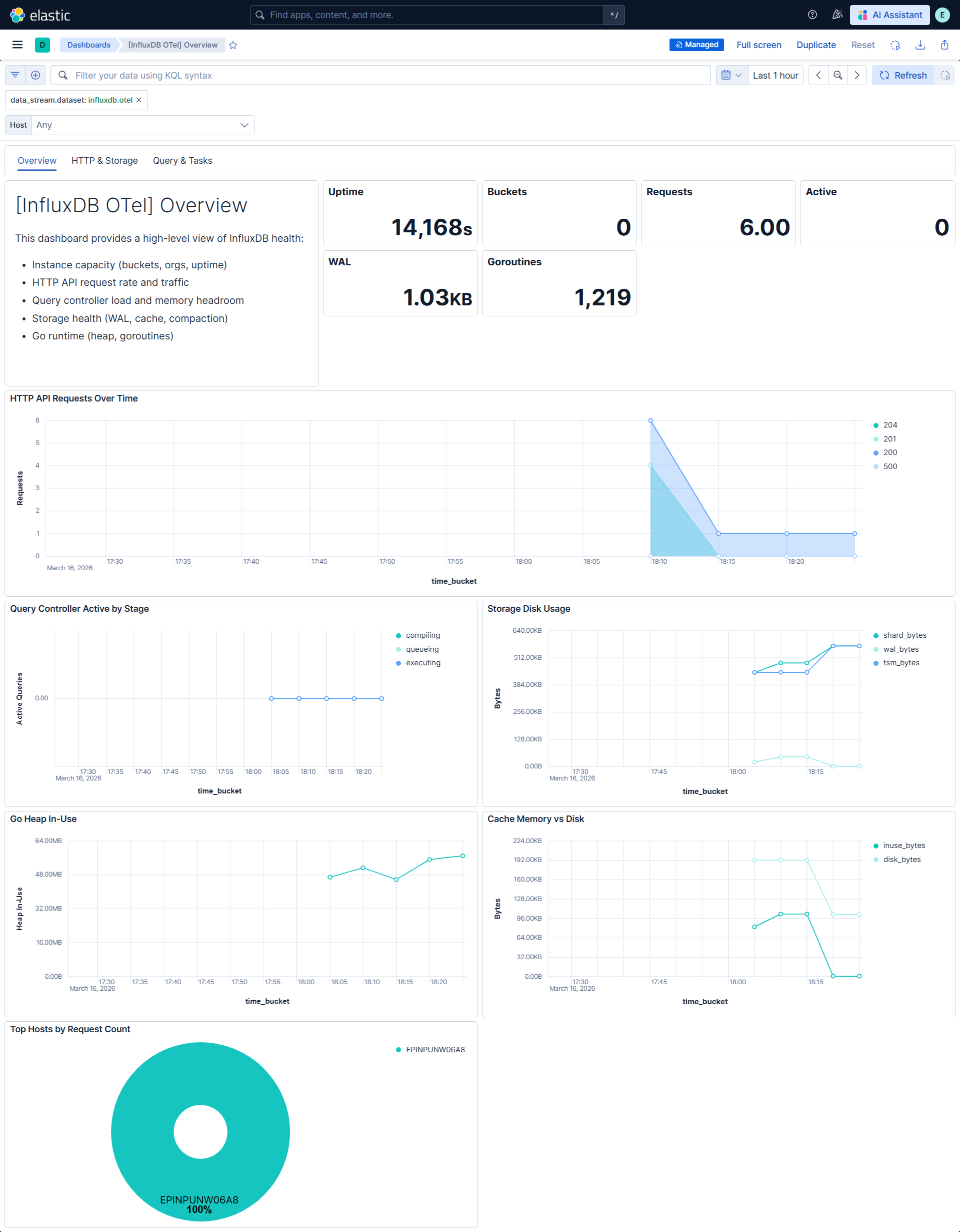

| Dashboard | Description |
| [InfluxDB OTel] Overview | High-level overview of InfluxDB health: instance capacity, HTTP traffic, query controller load, storage health, and Go runtime. |

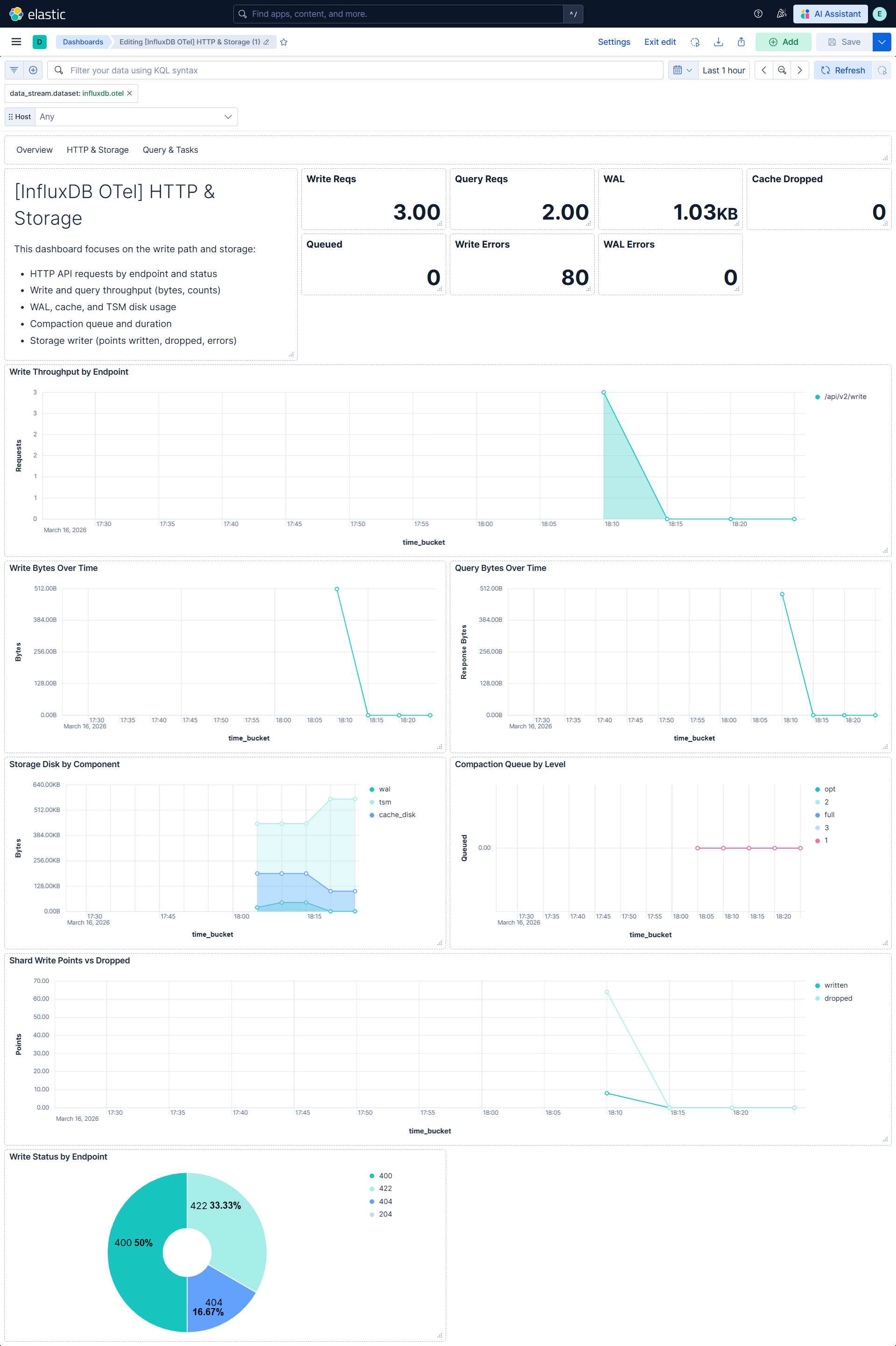

| [InfluxDB OTel] HTTP & Storage | HTTP API traffic, write/query throughput, storage health (WAL, cache, compaction), and writer metrics. |

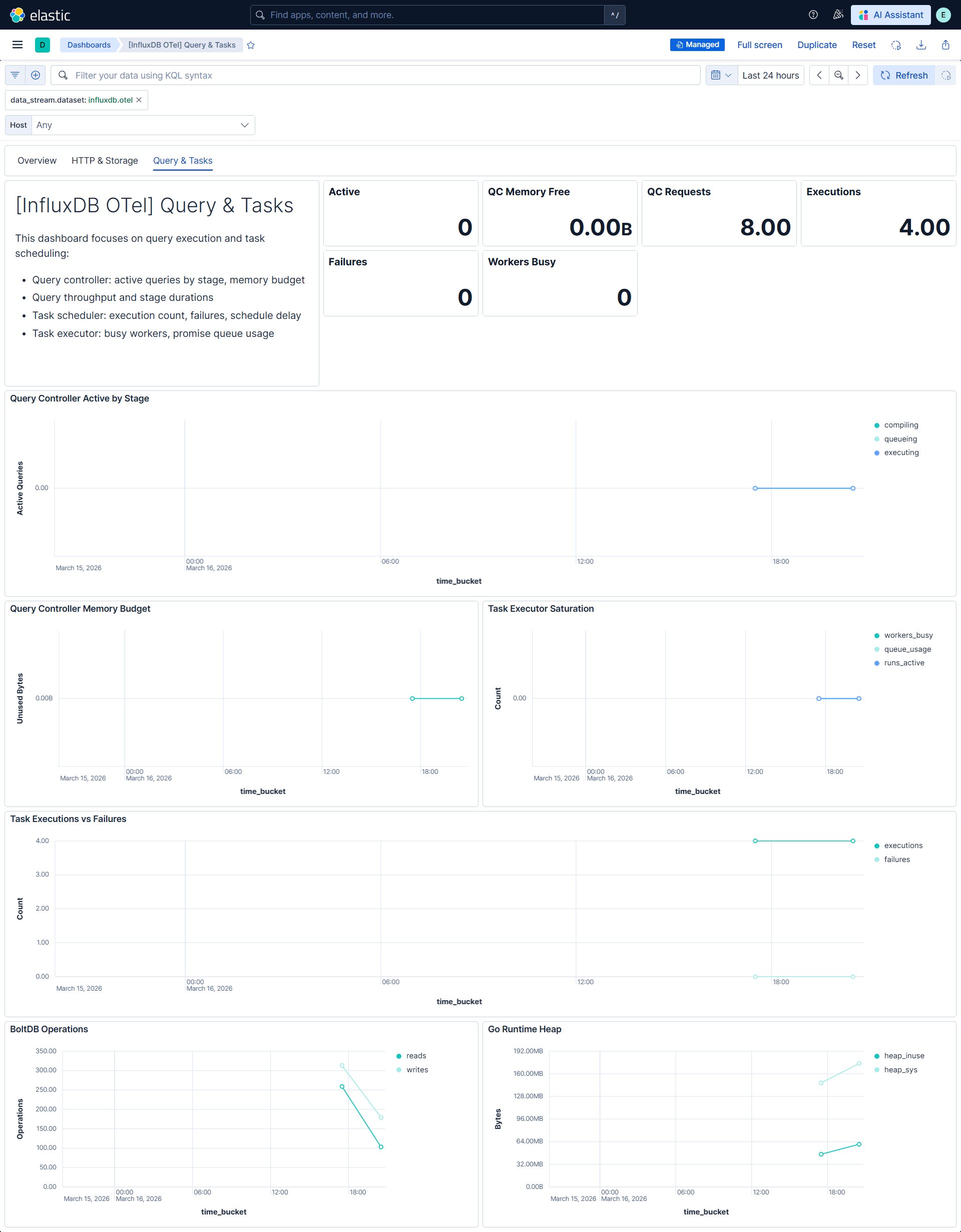

| [InfluxDB OTel] Query & Tasks | Query controller load, memory budget, stage durations, task scheduler execution, and task executor saturation. |
