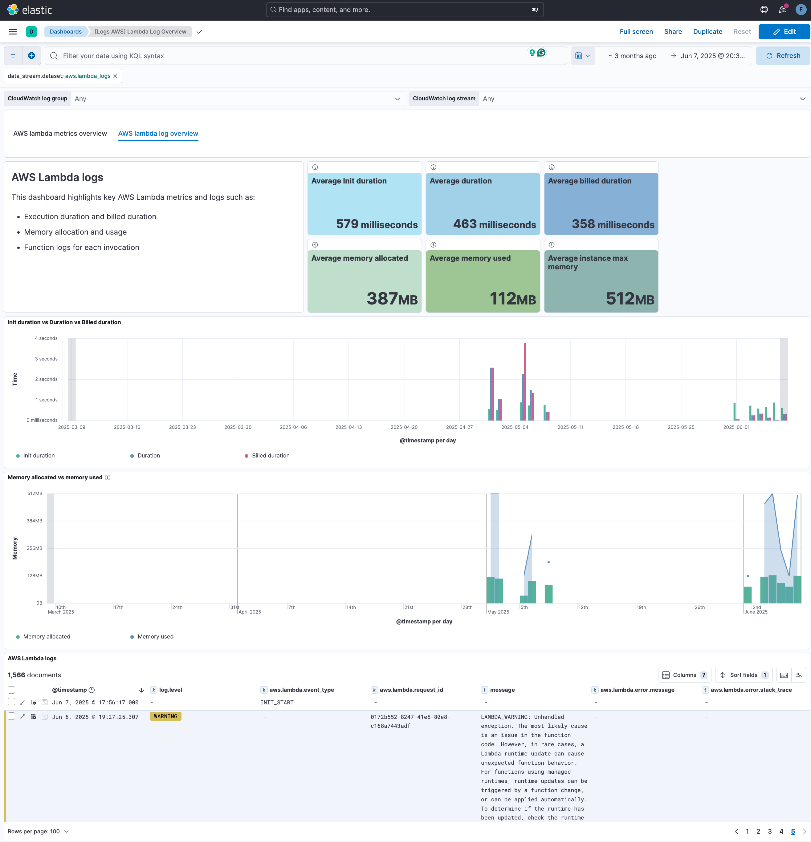

Logs provide detailed information about the execution of AWS Lambda functions. They include invocation events, function output, error messages, stack traces, initialization logs, and AWS-generated reports. These logs help you troubleshoot issues, analyze performance, and monitor the behavior of your Lambda functions during runtime.

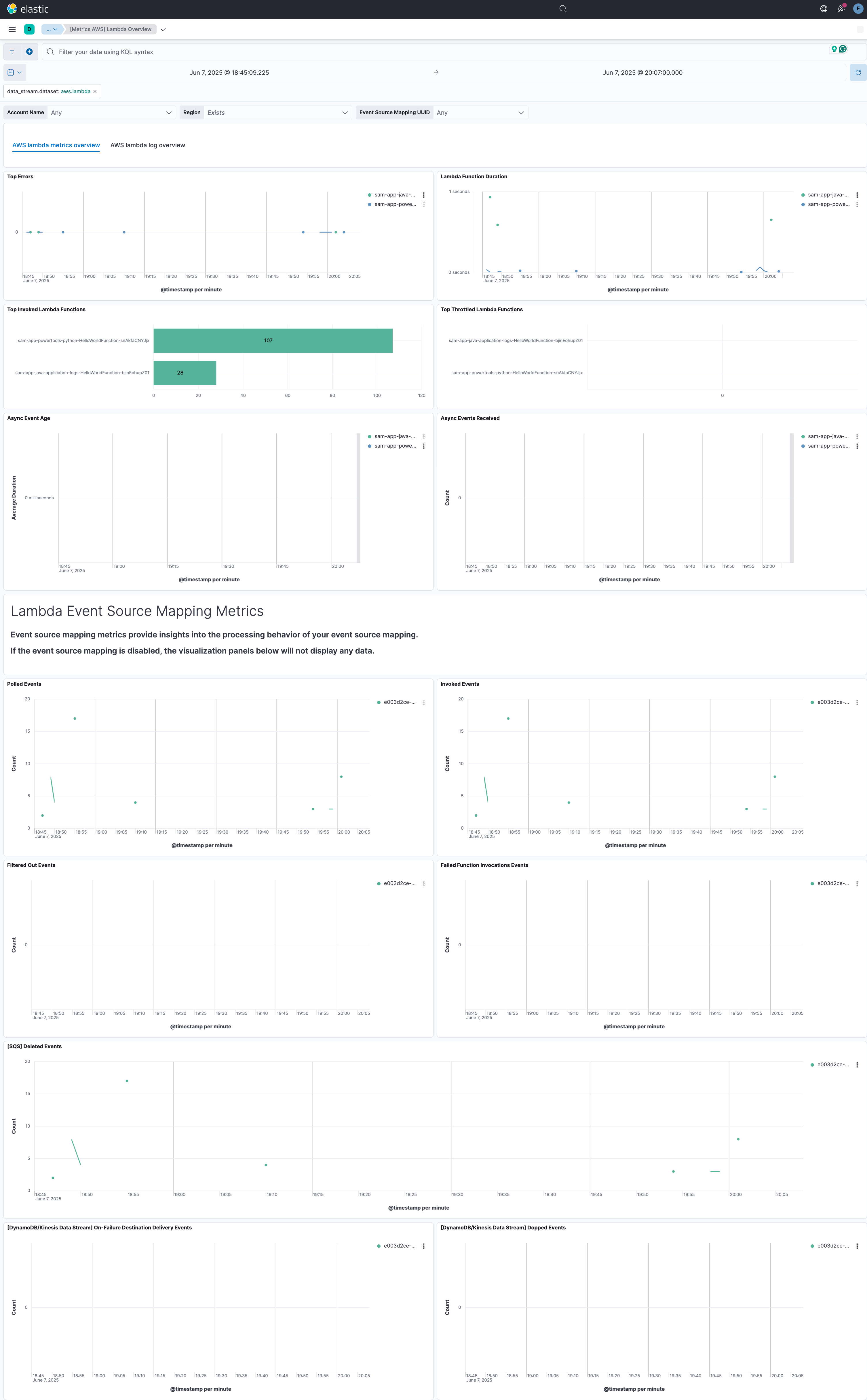

This integration can also collect Event Source Mapping (ESM) metrics, which track how your Lambda function processes records from event sources like Amazon SQS, DynamoDB, or Kinesis.
To collect these metrics, you must:
- Enable Event Source Mapping for your Lambda function by following the steps outlined in the AWS documentation.
- Enable the configuration flag
Collect Event Source Mapping metrics.
Important notes:
- Enabling this feature may incur additional costs
- Not all metrics are available for every event source type
- Metric collection may be affected by CloudWatch or Lambda service availability
See more details about Event Source Mapping Metrics.

To enable AWS Lambda logs, ensure that your function's execution role includes the necessary permissions to write to Amazon CloudWatch Logs. Specifically, the role should have the following permissions:
logs:CreateLogGrouplogs:CreateLogStreamlogs:PutLogEvents
You can grant these permissions by attaching the AWS managed policy AWSLambdaBasicExecutionRole to your function's execution role.
By default, AWS Lambda automatically streams logs to CloudWatch Logs. You can view these logs by navigating to the AWS Lambda console, selecting your function, and choosing the "Monitor" tab. From there, click on "View CloudWatch logs" to access the logs in the CloudWatch console.
For more detailed information, refer to the AWS documentation on Sending Lambda function logs to CloudWatch Logs.
