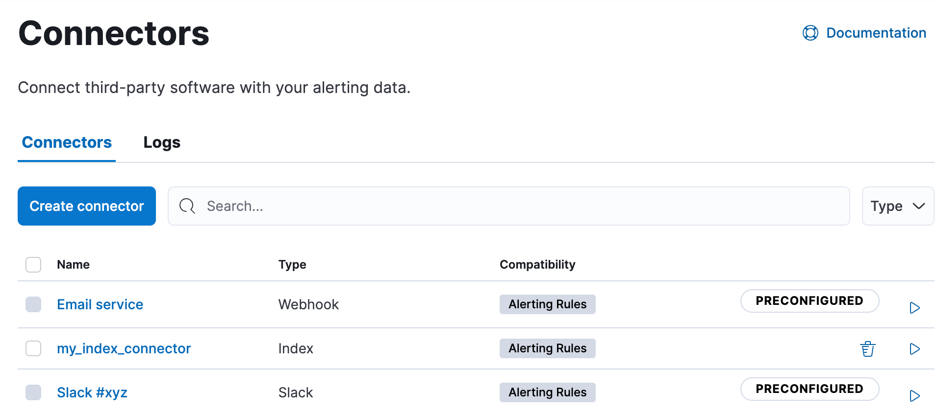

go to the Connectors page using the navigation menu or the global search field. Preconfigured connectors appear regardless of which space you are in. They are tagged as “preconfigured”, and you cannot delete them.
Connectors managing tab with pre-configured
Clicking a preconfigured connector shows the description, but not the configuration.

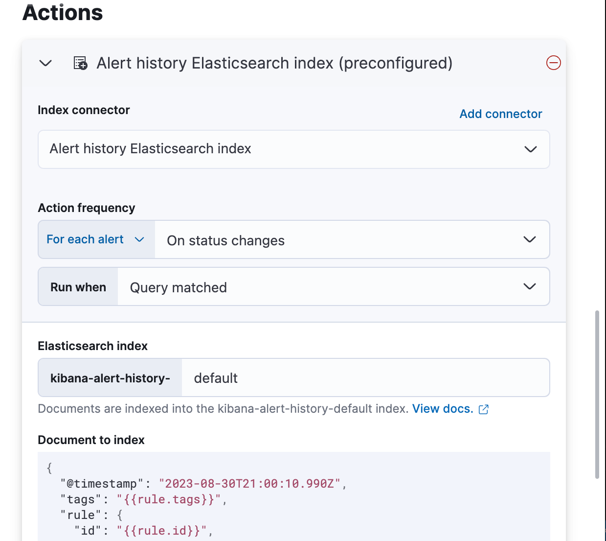

Kibana offers a preconfigured index connector to facilitate indexing active alert data into Elasticsearch. To use this connector, set xpack.actions.preconfiguredAlertHistoryEsIndex to true.
When you subsequently create rules, you can use the Alert history Elasticsearch index (preconfigured) connector.
Creating a rule action that uses the pre-configured alert history connector
Documents are indexed using a preconfigured schema that captures the action variables available for the rule. By default, these documents are indexed into the kibana-alert-history-default index, but you can specify a different index. Index names must start with kibana-alert-history- to take advantage of the preconfigured alert history index template.
