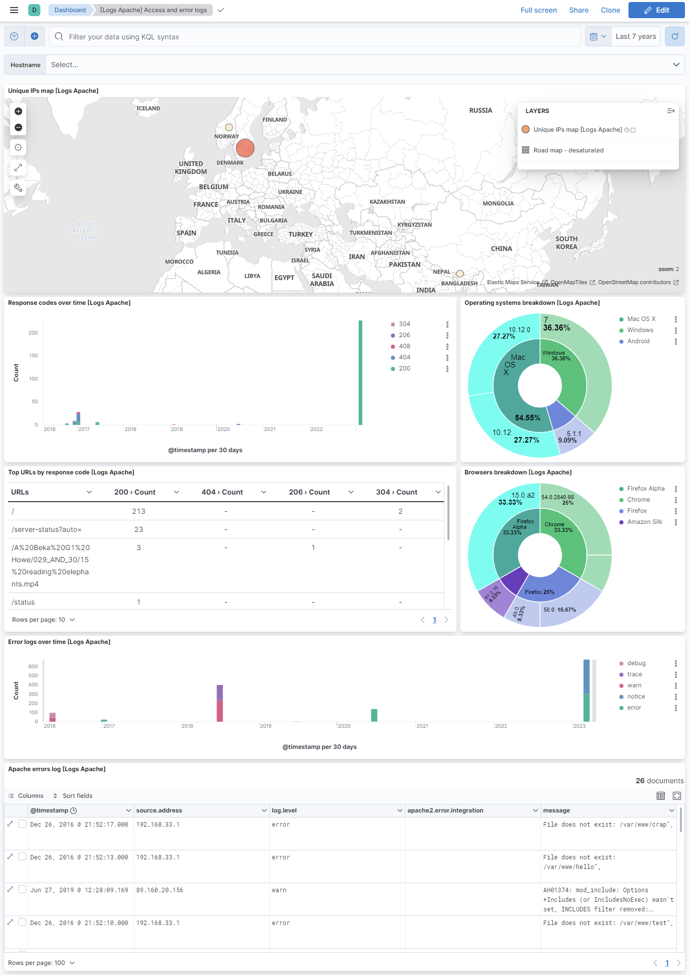

Access logs collects the Apache access logs.
ECS Field Reference
Please refer to the following document for detailed information on ECS fields.
Supported format for the access logs are:
  • Common Log Format
    • The common LogFormat can be used as follows:
      %h %l %u %t \"%r\" %>s %b
    • Example:
      127.0.0.1 user-identifier frank [10/Oct/2000:13:55:36 -0700] "GET /apache_pb.gif HTTP/1.0" 200 2326
  • Combined Log Format
    • The combined LogFormat can be used as follows:
      I. %h %l %u %t \"%r\" %>s %b \"%{Referer}i\" \"%{User-Agent}i\"
      II. %A:%p %h %l %u %t \"%r\" %>s %b \"%{Referer}i\" \"%{User-Agent}i\"
      III. %h:%p %l %u %t \"%{req}i %U %H\" %>s %b \"%{Referer}i\" \"%{User-Agent}i\"
    • Example:
      I. 127.0.0.1 user-identifier frank [10/Oct/2000:13:55:36 -0700] "GET /apache_pb.gif HTTP/1.0" 200 2326 "http://datawarehouse.us.oracle.com/datamining/contents.htm" "Mozilla/4.7 [en] (WinNT; I)"
      II. 127.0.0.1:80 127.0.0.1 - - [20/Jun/2024:16:23:43 +0530] "\x16\x03\x01" 400 226 "-" "-"
      III. 127.0.0.1:80 - - [20/Jun/2024:16:31:41 +0530] "<SCRIPT>NXSSTEST</SCRIPT> / HTTP/1.1" 403 4897 "-" "-"
  • Combined Log Format + X-Forwarded-For header
    • The combined LogFormat with x-forwarded-for header can be used as follows:
      %h %l %u %t \"%r\" %>s %b \"%{Referer}i\" \"%{User-Agent}i\" X-Forwarded-For=\"%{X-Forwarded-For}i\"
    • Example:
      127.0.0.1 user-identifier frank [10/Oct/2000:13:55:36 -0700] "GET /apache_pb.gif HTTP/1.0" 200 2326 "http://datawarehouse.us.oracle.com/datamining/contents.htm" "Mozilla/4.7 [en] (WinNT; I)" X-Forwarded-For="10.225.192.17, 10.2.2.121"

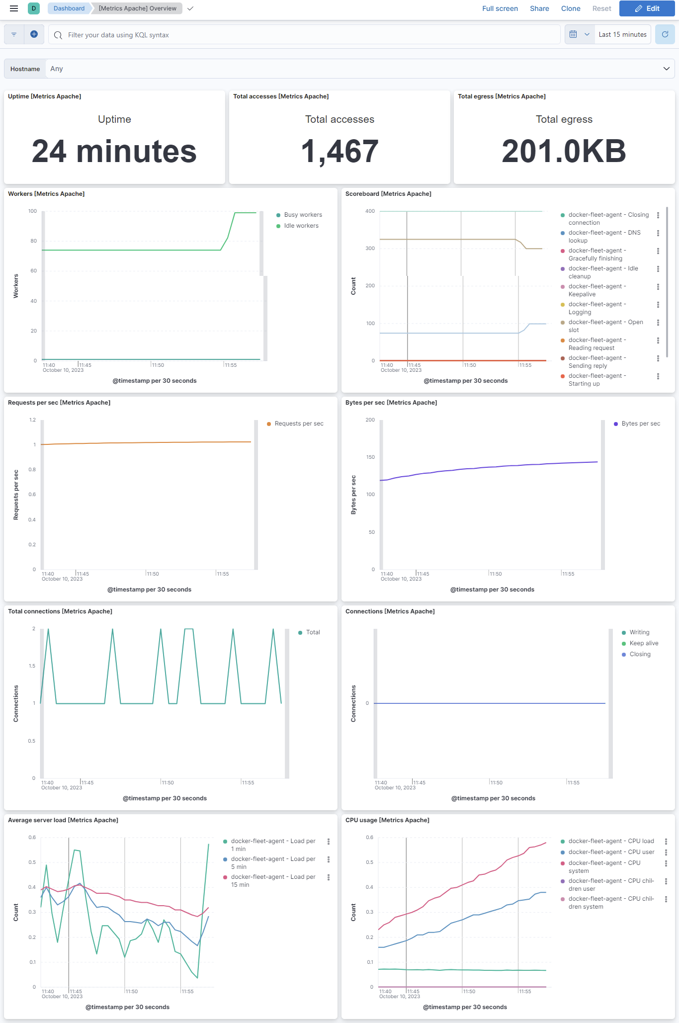

The server status stream collects data from the Apache Status module. It scrapes the status data from the web page generated by the mod_status module.
ECS Field Reference
