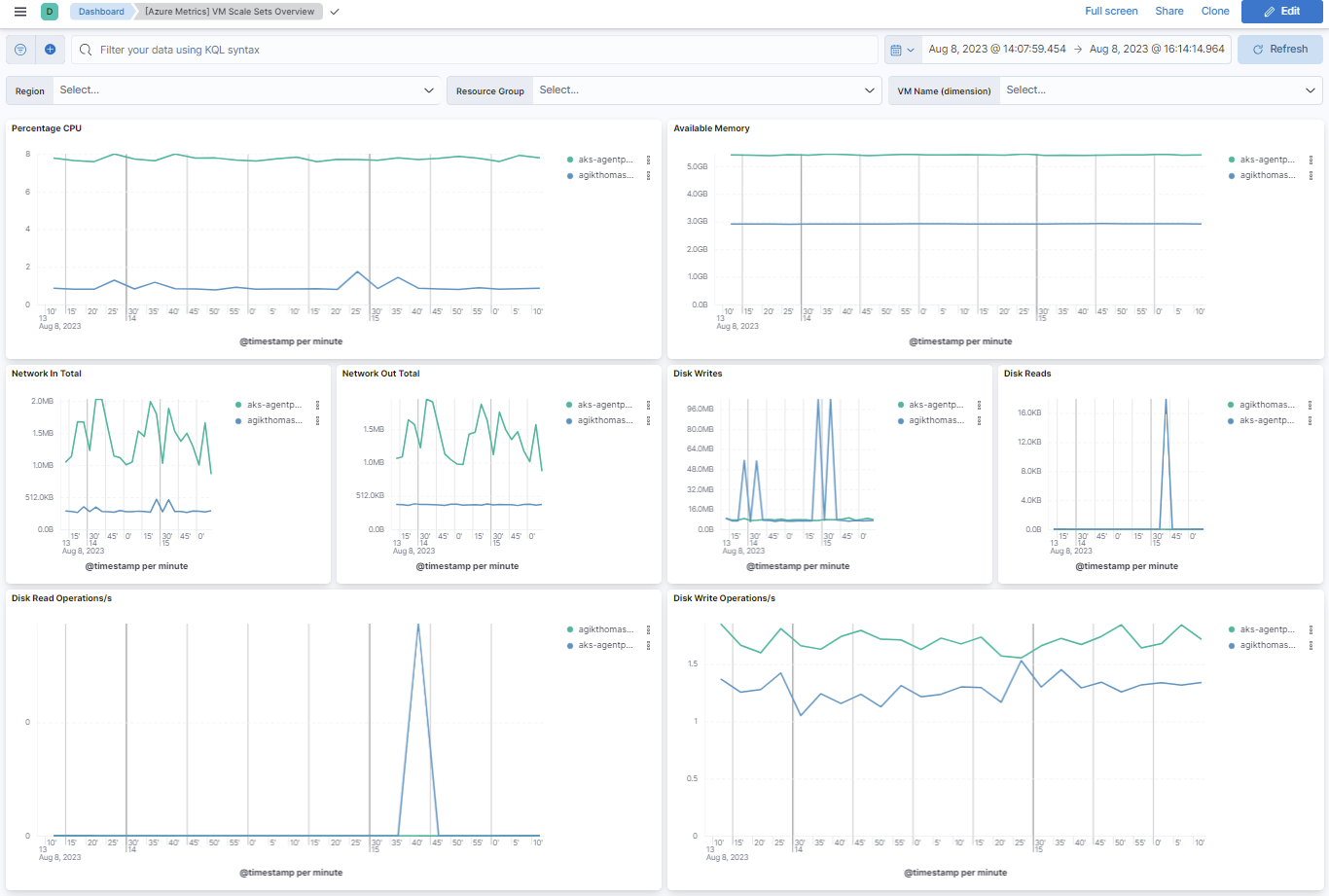

The Azure Compute Scaleset VM data stream collects and aggregates compute scaleset VM related metrics from Azure Virtual Machine scaleset type resources where it can be used for analysis, visualization, and alerting. The Azure Compute VM Scaleset will periodically retrieve the Azure Monitor metrics using the Azure REST APIs as MetricList. Additional Azure API calls will be executed to retrieve information regarding the resources targeted by the user.
