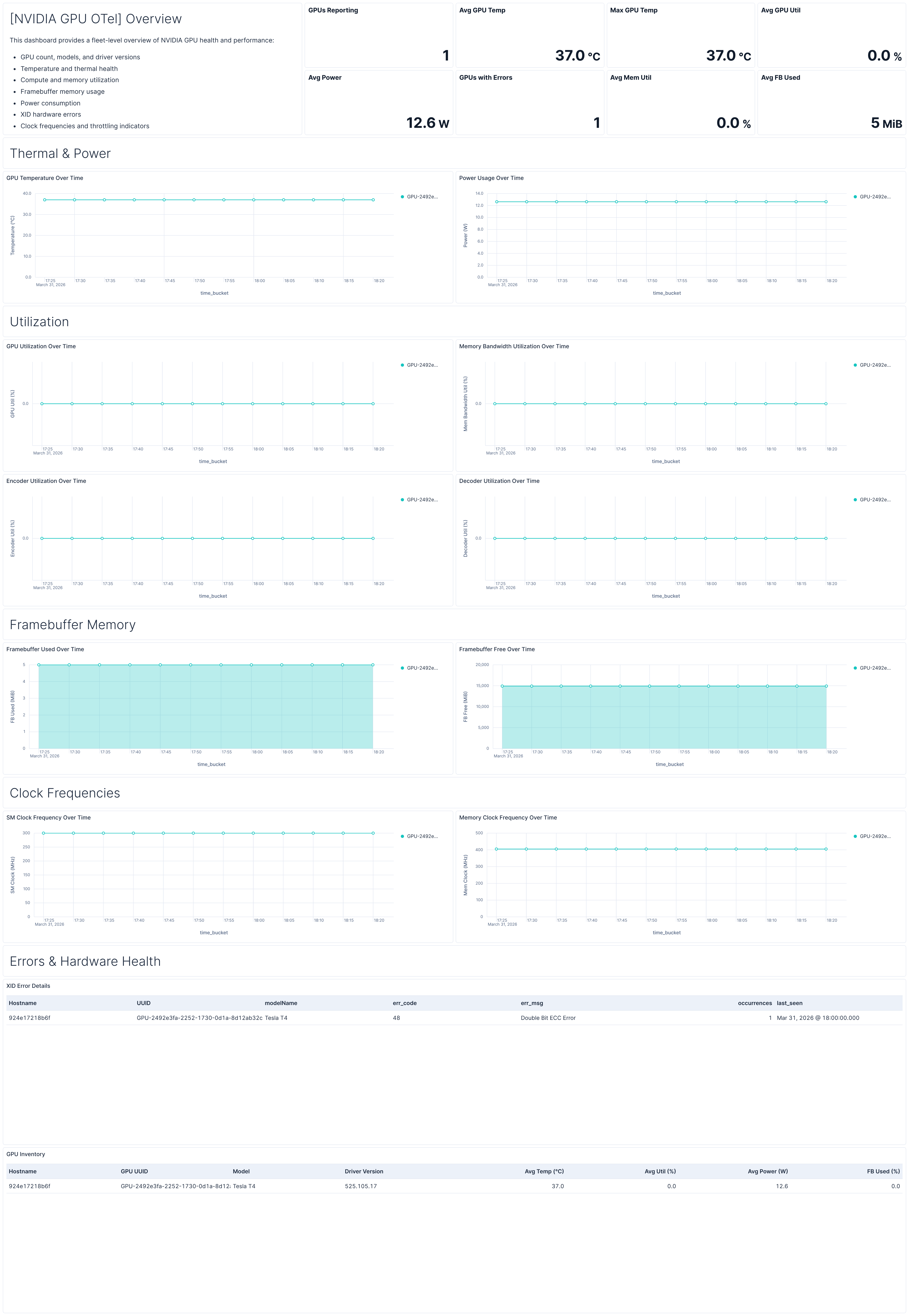

| Dashboard | Description |
| [NVIDIA GPU OTel] Overview | Fleet-level overview of GPU health covering temperature, utilization, memory, power, clocks, errors, and a per-GPU inventory table. |
