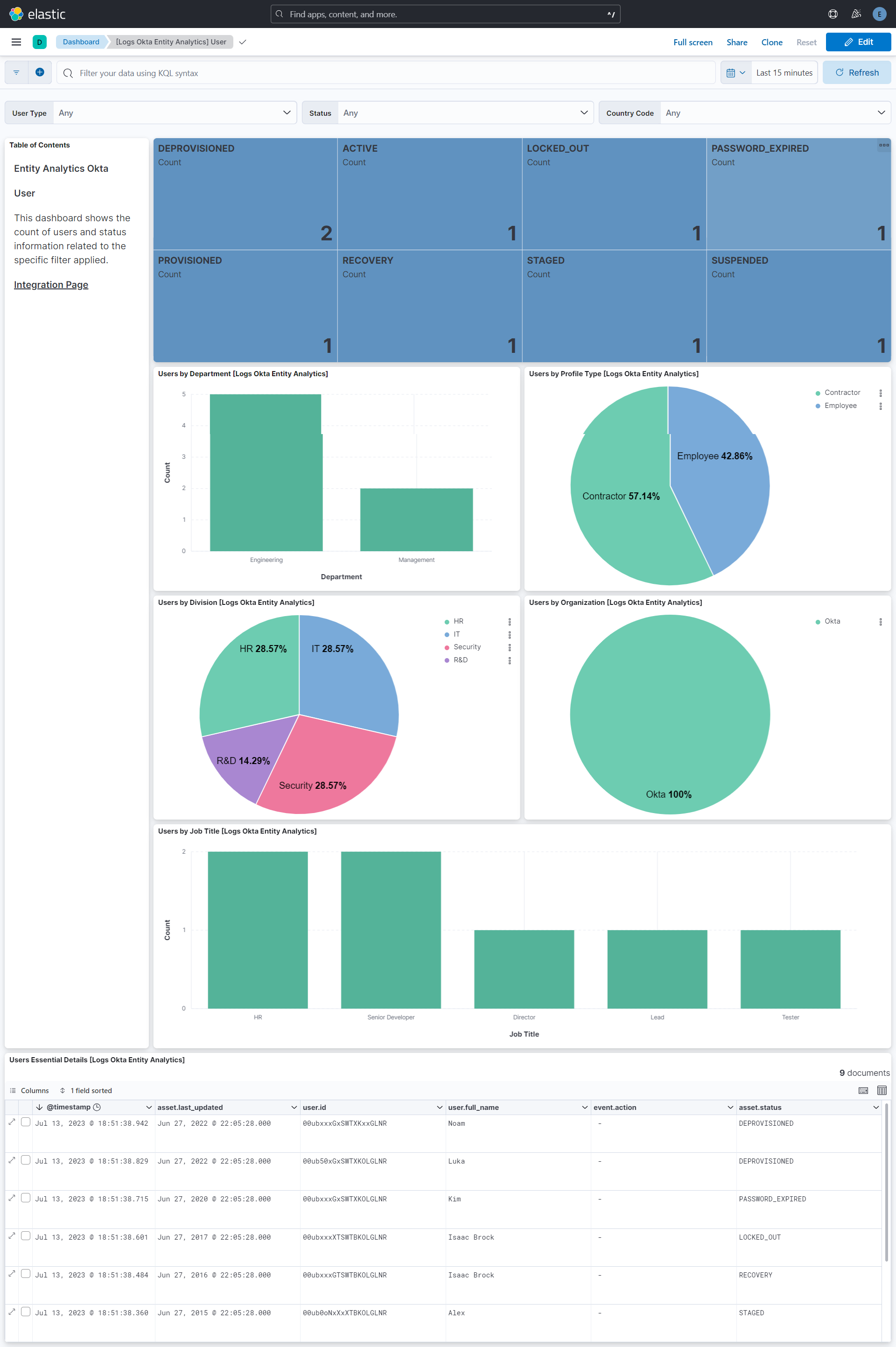

This integration provides an asset inventory, a point-in-time snapshot of which users and devices exist and their current properties. It does not provide an audit trail of who changed what, or when. If you need to track administrative changes to Okta objects, use the Okta integration's system log data stream, which collects the Okta System Log.
User documents map the Okta user to the ECS user fields as follows: user.id is the Okta user id (for example 00ub0oNGTSWTBKOLGLNR), user.name is the login (profile.login) and user.email is the primary email (profile.email). The Okta integration's System Log uses the same values for user.id and user.name. Its user.email holds the actor's login instead, because the System Log does not include the primary email. To correlate System Log events with these user documents, use user.id.
