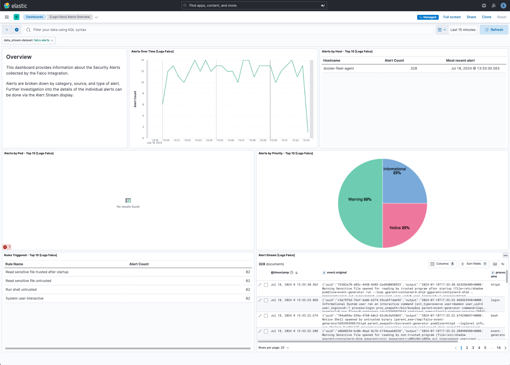

This integration allows for the shipping of Falco alerts to Elastic for observability and organizational awareness. Alerts can then be analyzed by using either the dashboard included with the integration or via the creation of a custom dashboard within Kibana.

Falco alerts can contain a multitude of various fields pertaining to the type of activity on the host machine.
