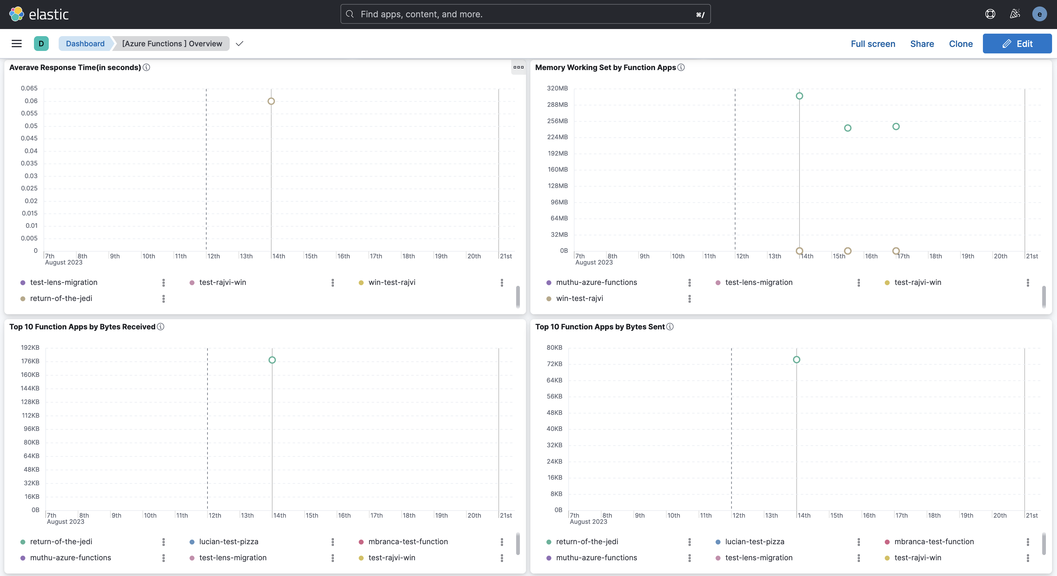

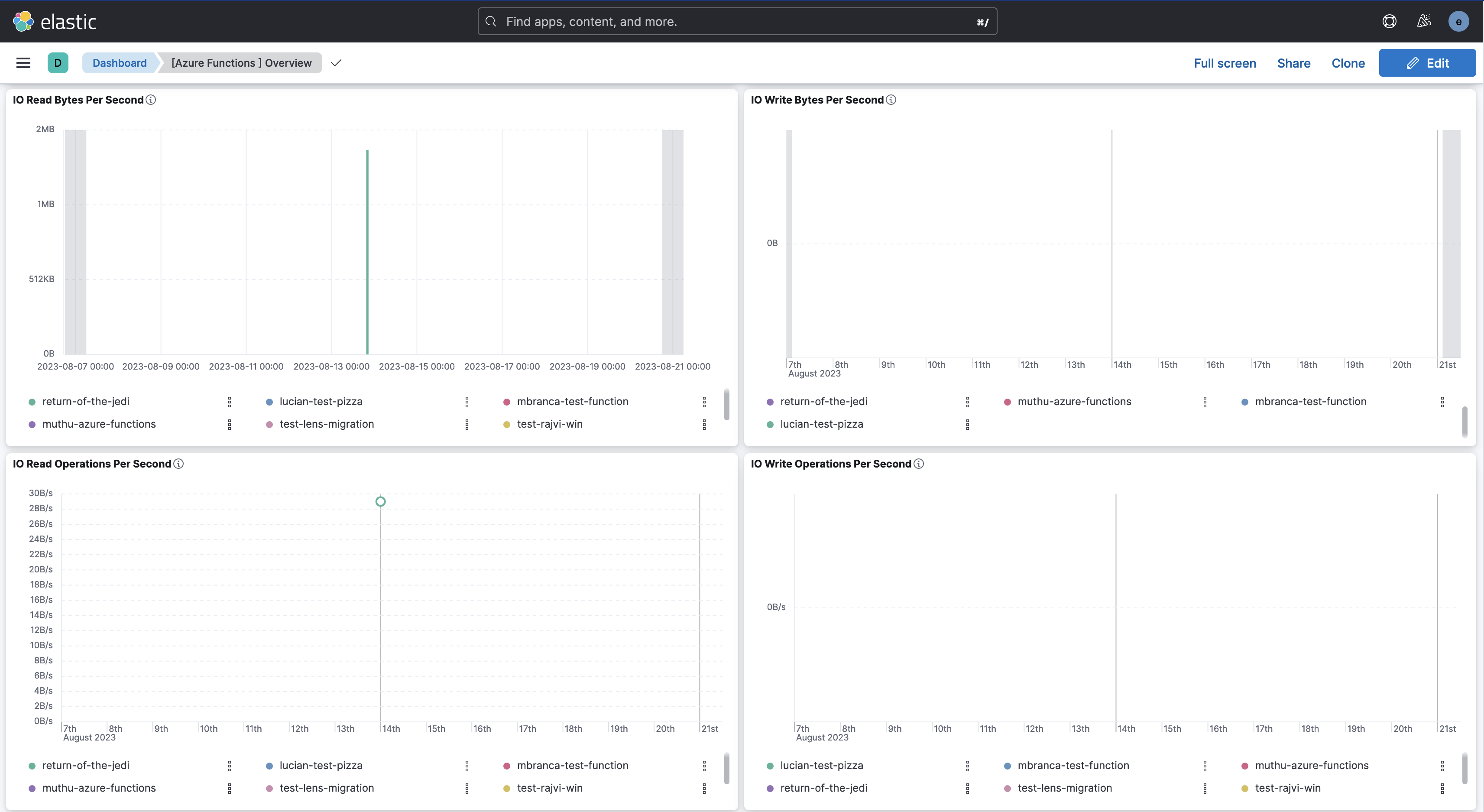

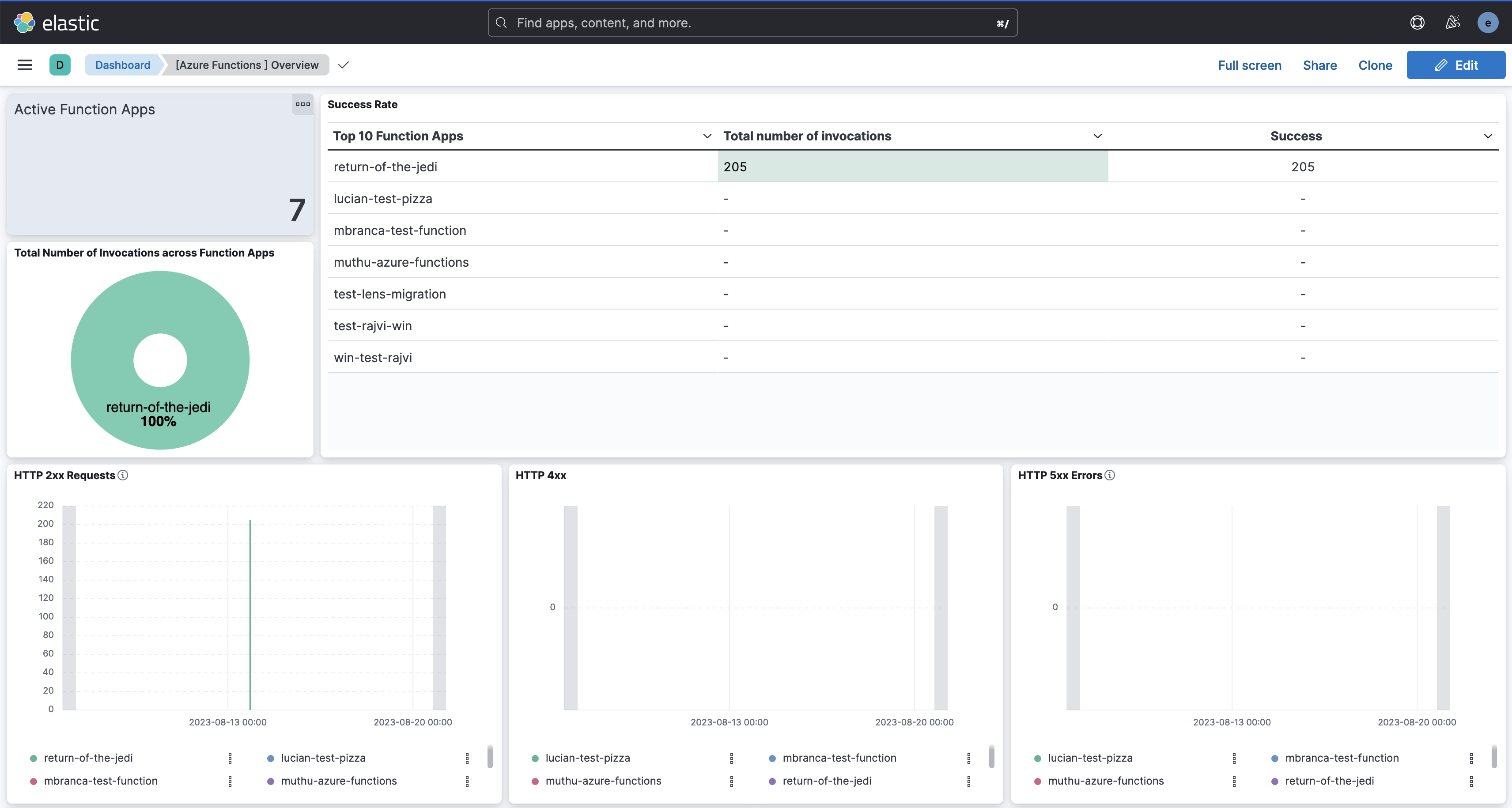

Metrics give you insight into the performance of your Azure Function Apps. The integration includes an out-of-the-box dashboard for visualising the monitoring data generated by apps hosted in Azure Functions.
