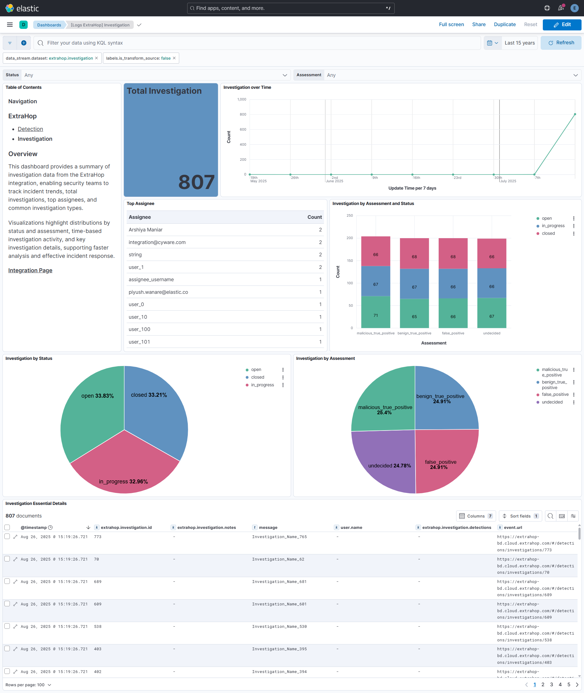

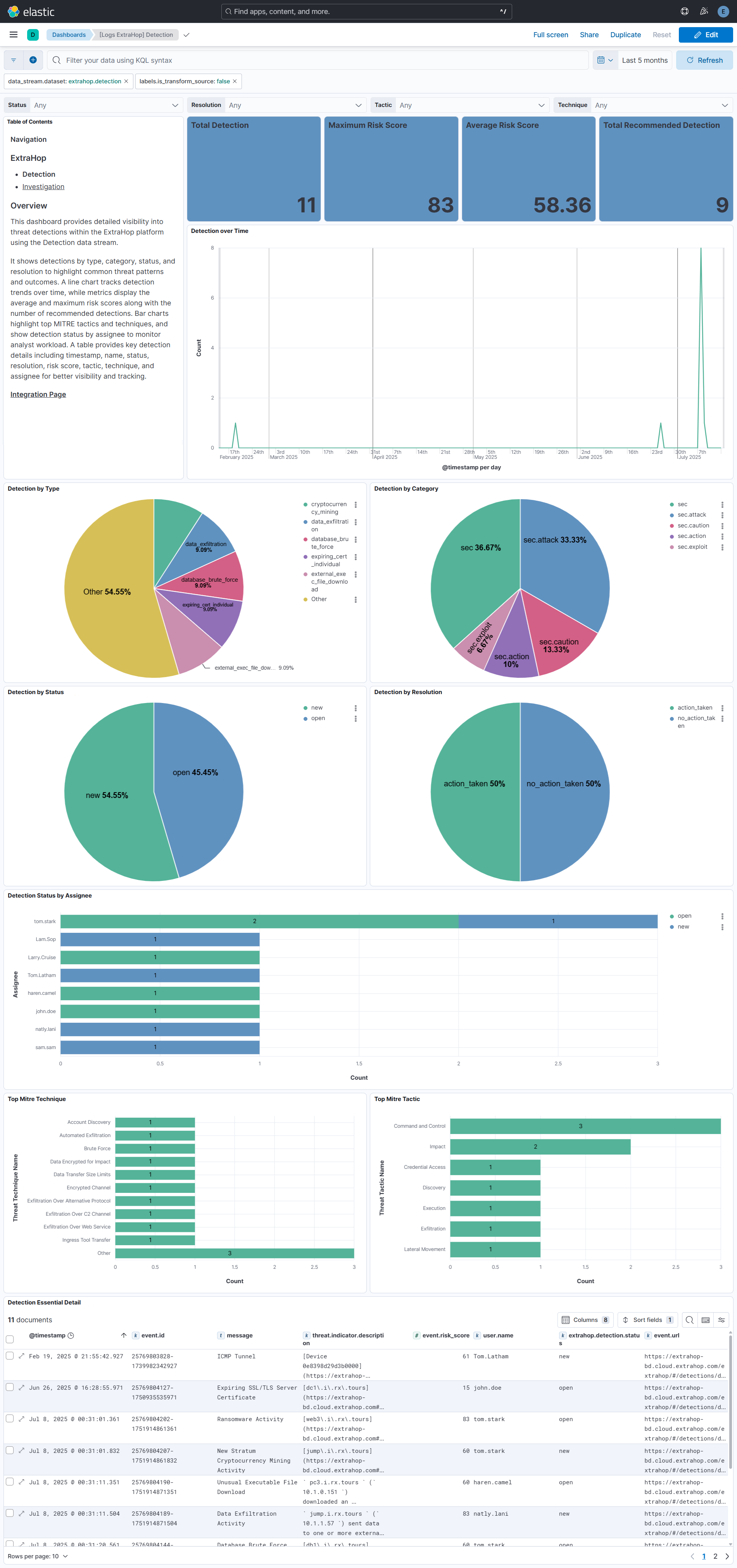

- In the top search bar in Kibana, search for Dashboards.
- In the search bar, type extrahop.
- Select a dashboard for the dataset you are collecting, and verify the dashboard information is populated.
