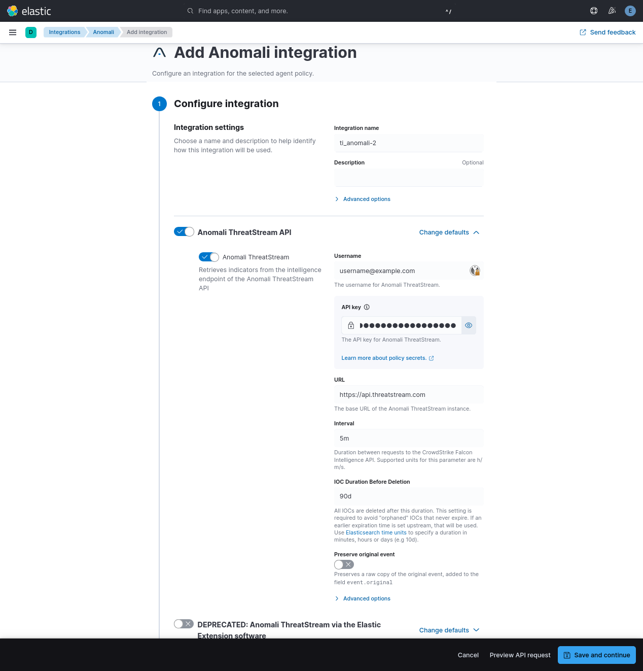

- In the top search bar in Kibana, search for Integrations.
- In the search bar, type Anomali ThreatStream.
- Select the Anomali ThreatStream integration from the search results.
- Select Add Anomali ThreatStream to add the integration.
- Enable and configure only the collection methods which you will use.
- To Collect Anomali events from ThreatStream API, you need to:
- Configure Username and API key.
- Select Save and continue to save the integration.

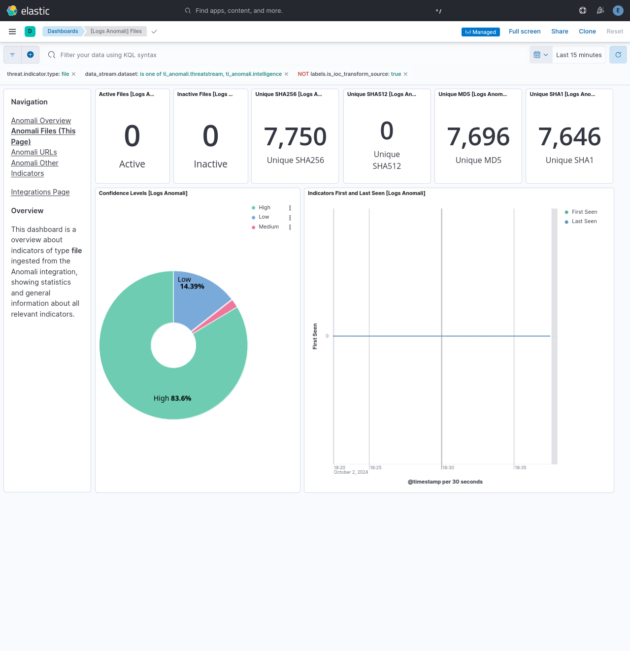

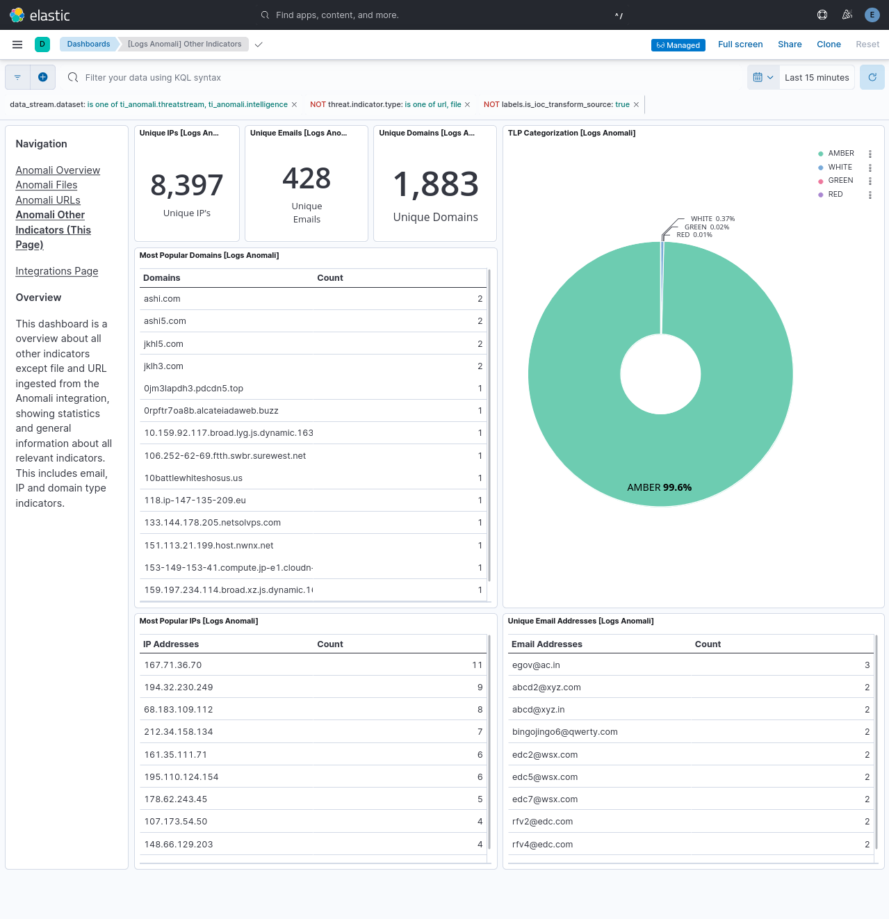

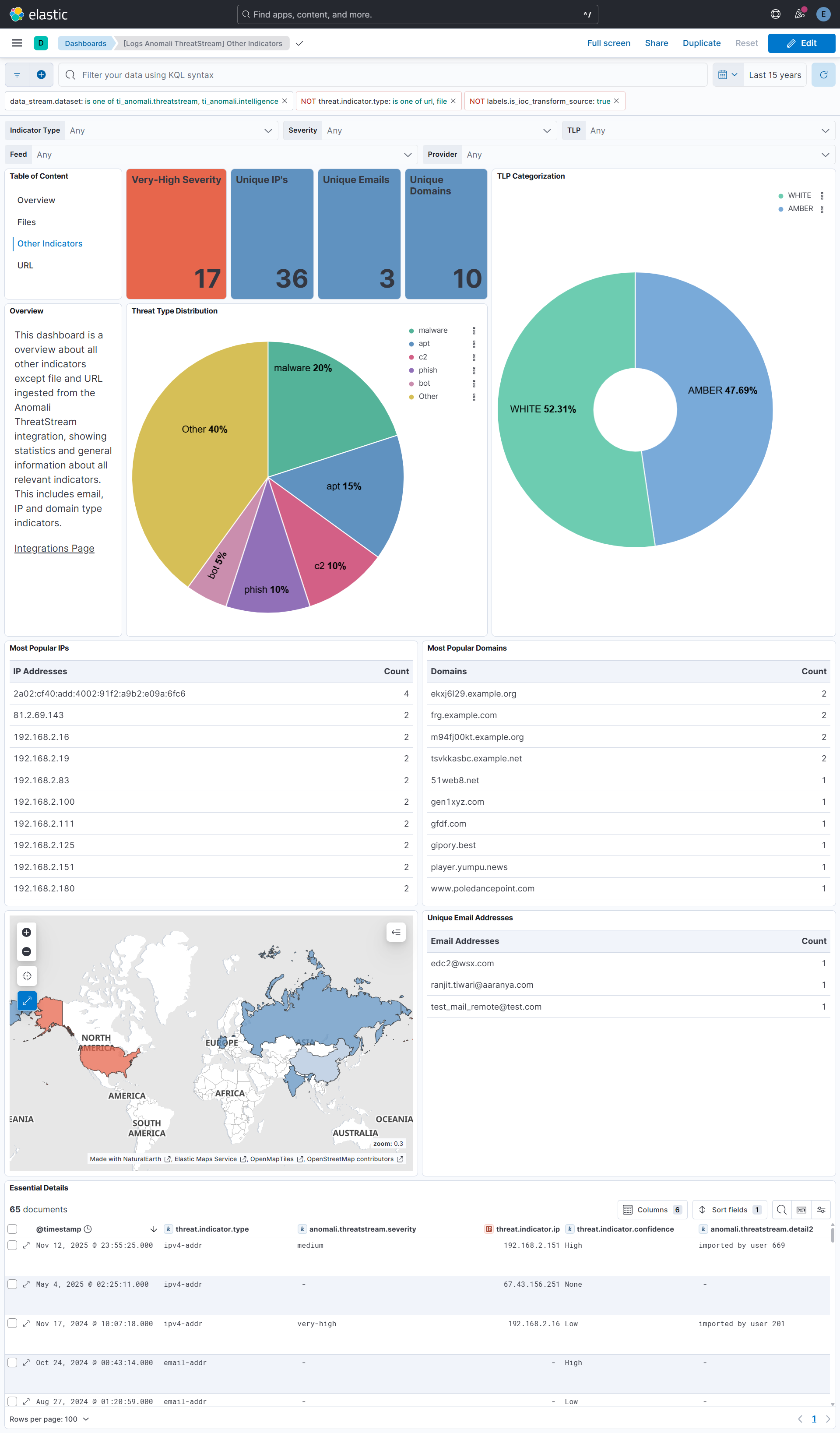

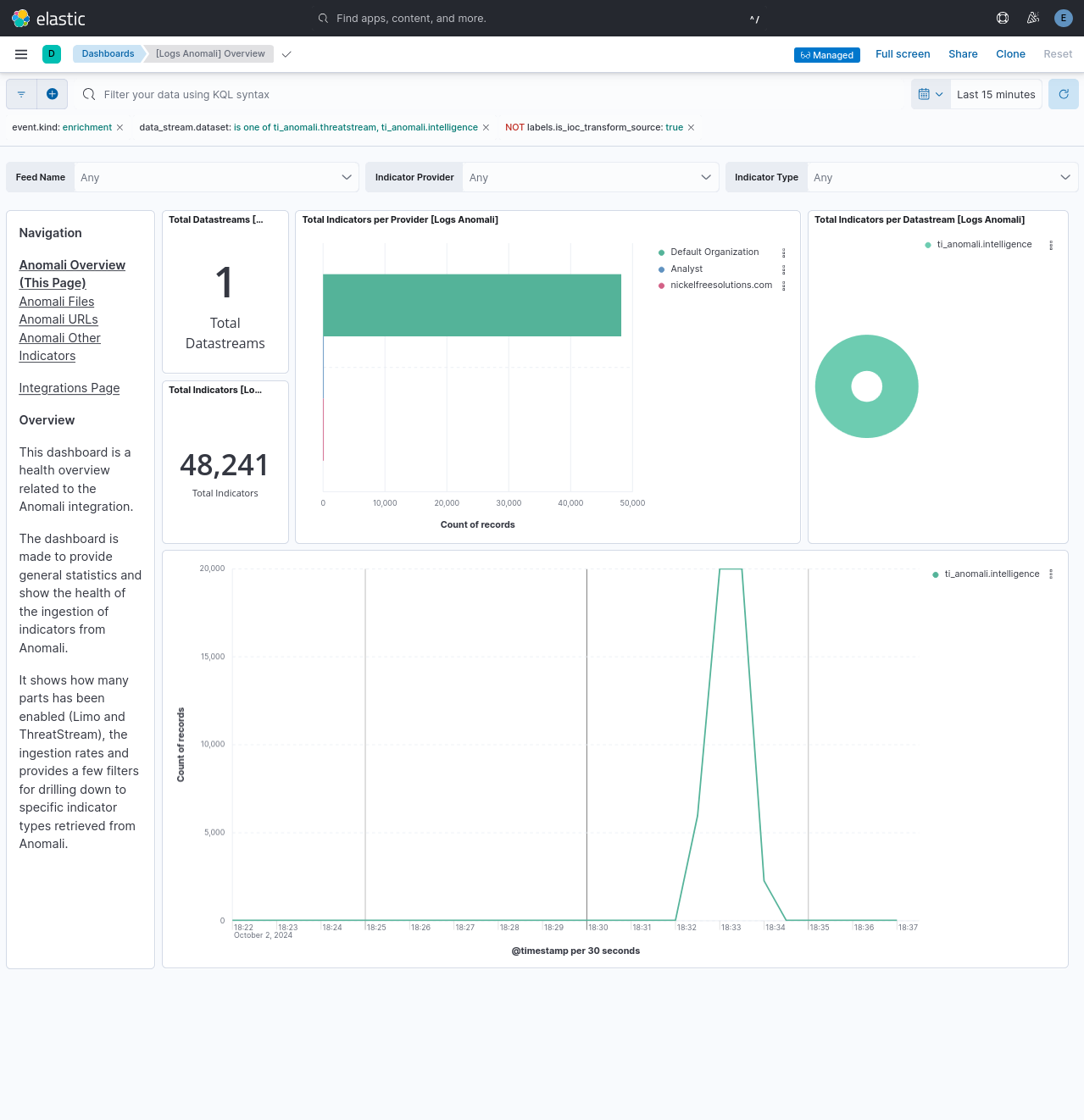

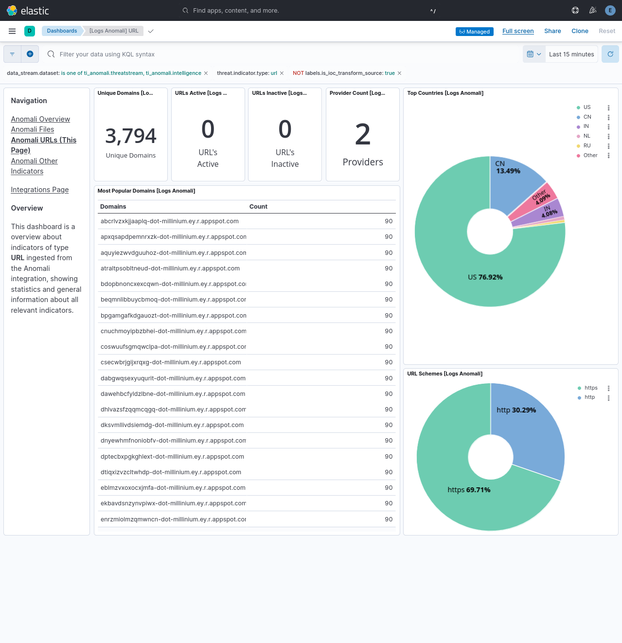

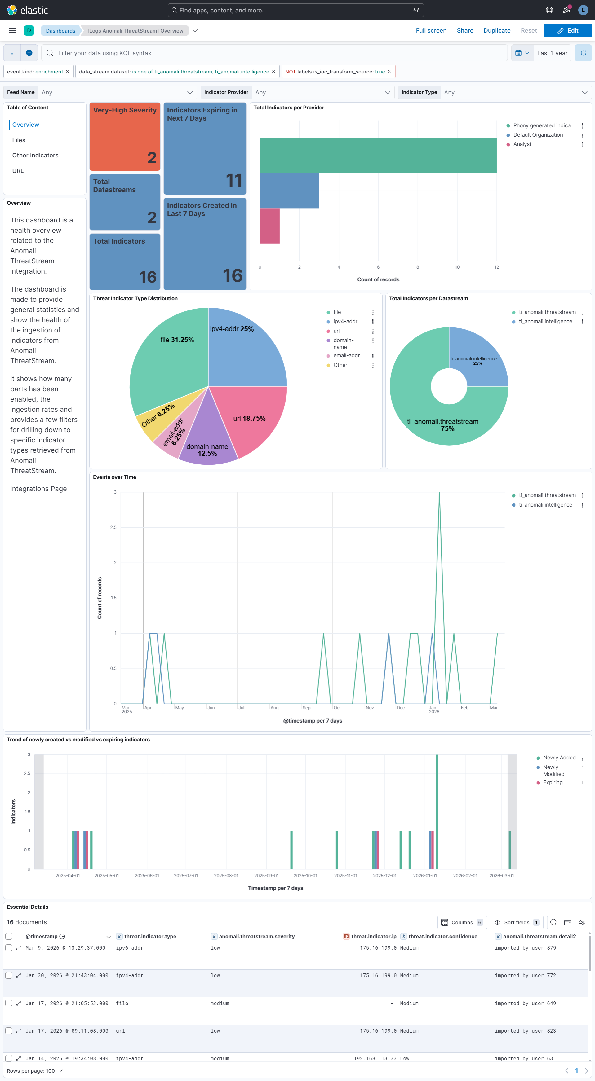

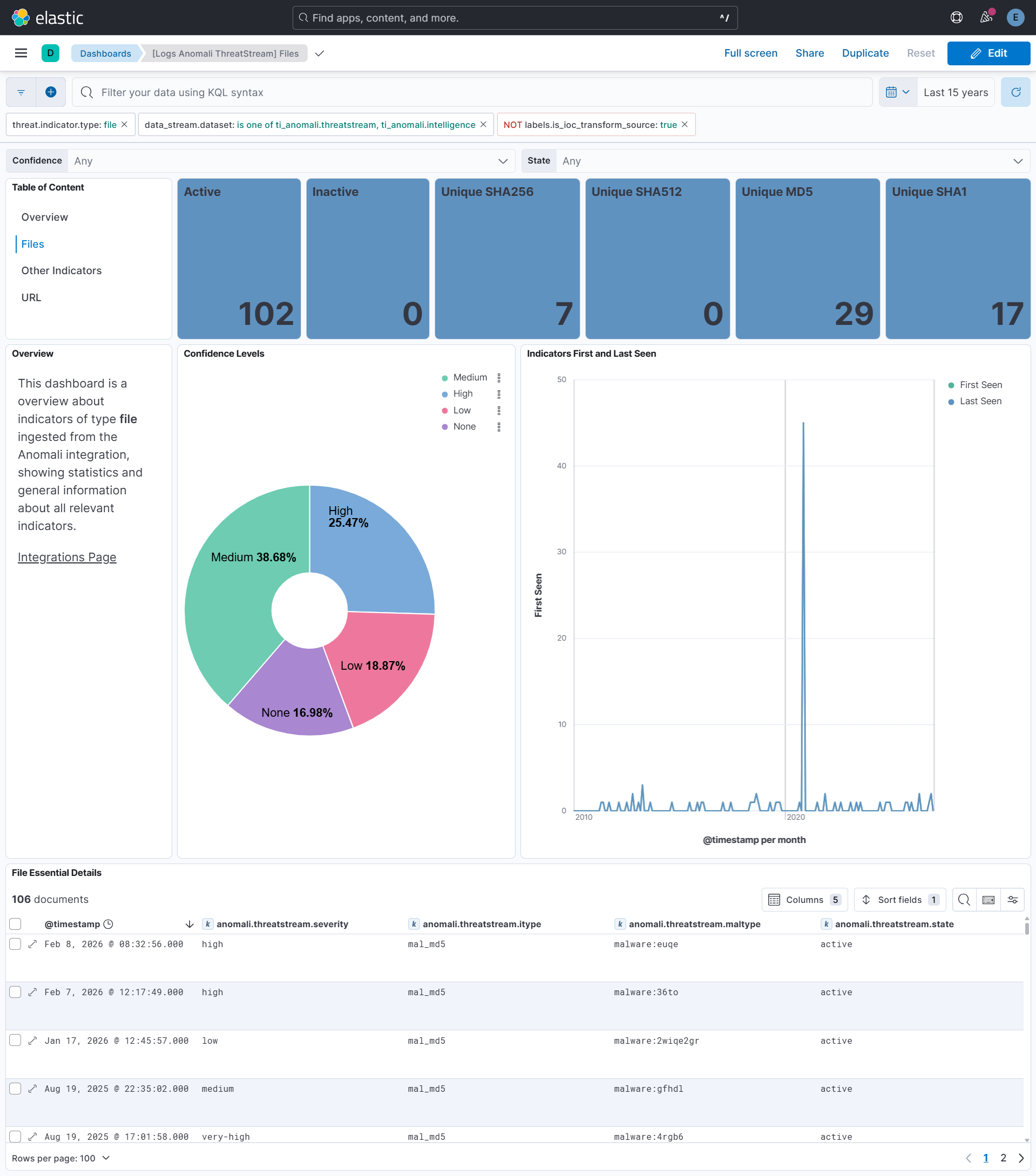

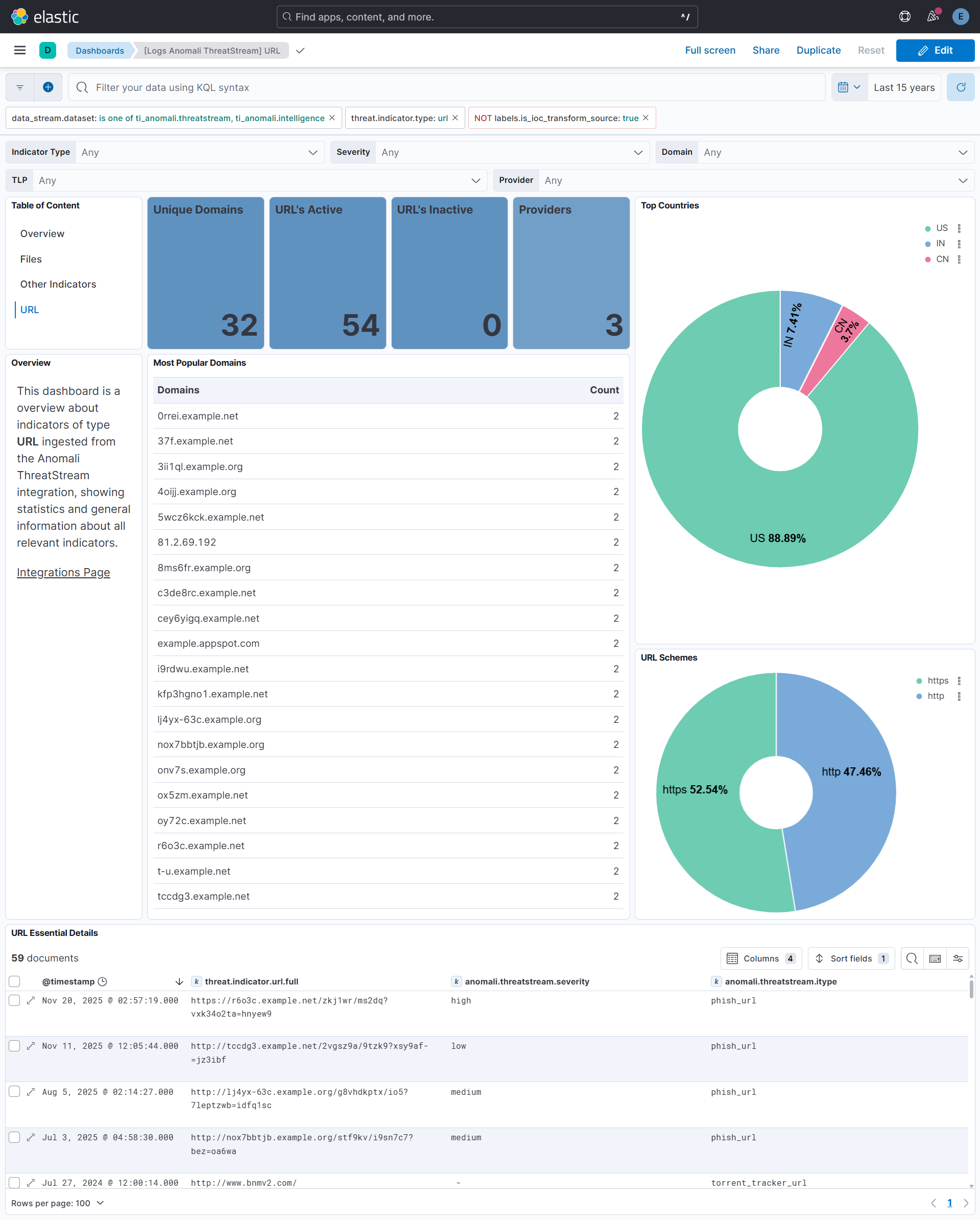

- In the top search bar in Kibana, search for Dashboards.
- In the search bar, type ti_anomali.
- Select a dashboard for the dataset you are collecting, and verify the dashboard information is populated.
Some dashboard panels use ES|QL queries. ES|QL returns at most 10,000 rows per query (1,000 by default, refer to ES|QL set size limits for details). These panels include LIMIT 10000 to request the maximum allowed, but if more rows match the query filters, results are silently truncated. Because the queries aggregate (stats) after the LIMIT, counts may be lower than the true total when more than 10,000 rows match.
