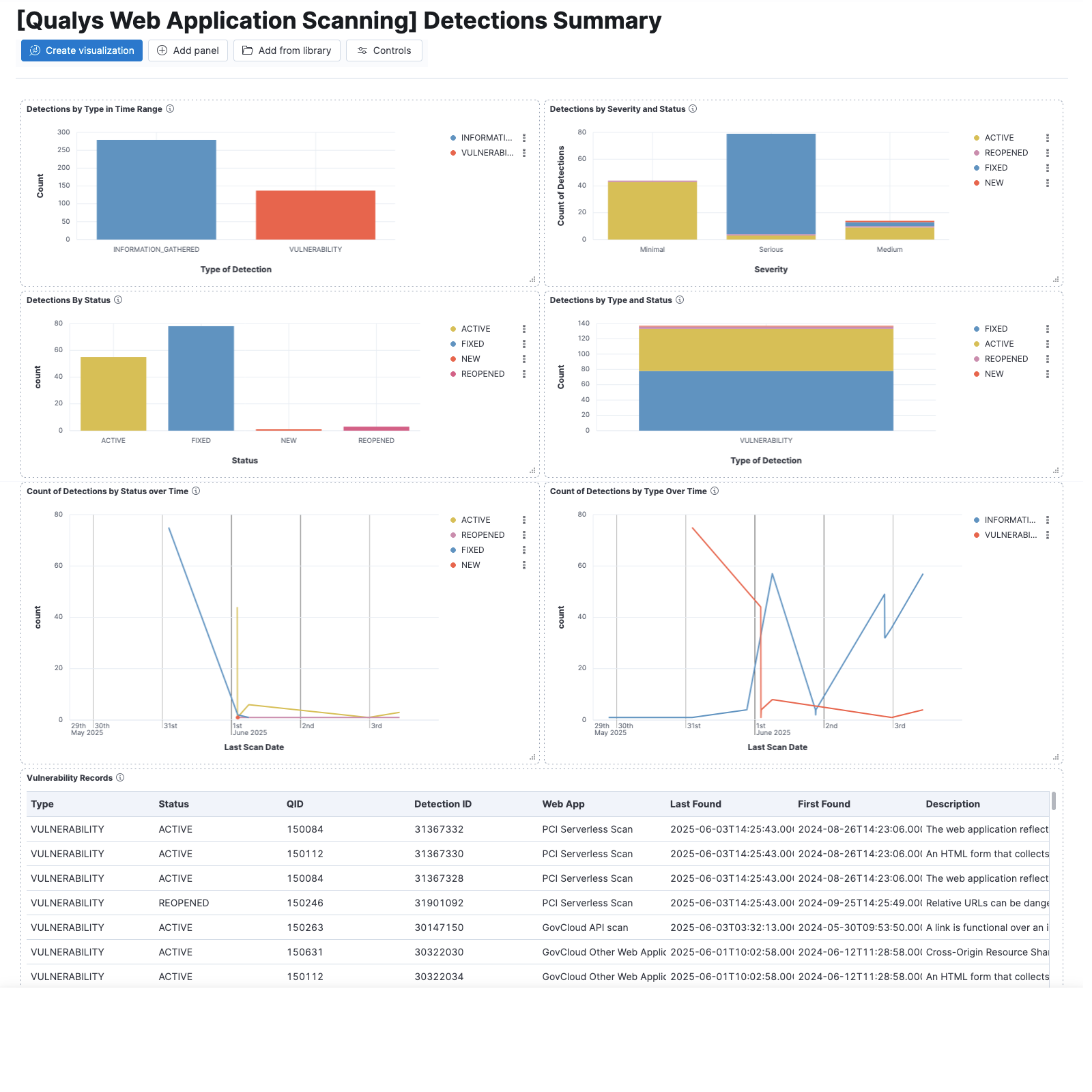

Cel scripts are used to fetch the data from Qualys endpoints and processed into events that are consumed by the pipelines. The cell script requests Findings (detection) data through the REST API using a filter for the "lastTestedDate", which is the scan datetime. The qid (qualys id) is the id the vulnerability found that maps to a knowledge base article in the qualys knowledge base. This id is used to request knowledge base data from an endpoint which augments each Finding with the knowledge base data. Findings are paginated by the qualys_was.vulnerability.id, a unique id for the finding. Knowledge base data is cached between pages to reduce the volume of data transported during a single run of the cel script. The cel script removes history data that is included in verbose mode.
An example response from the Qualys WAS API
