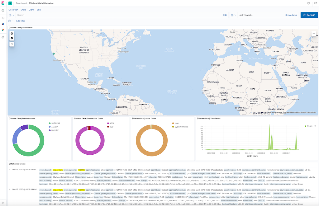

This module comes with a sample dashboard:
filebeat okta dashboard
