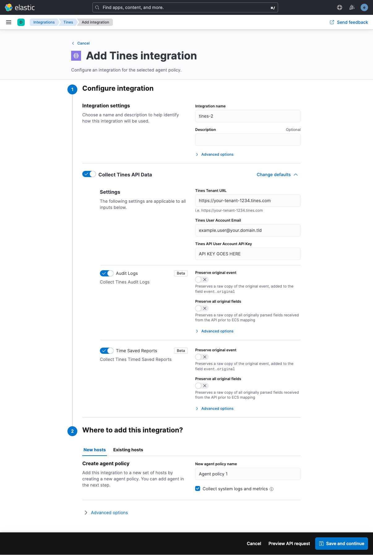

This is available within the Tines web interface via the URL bar, e.g. https://your-tenant-1234.tines.com
the trailing domain may be tines.io for your particular tenant.
Refer to this documentation from Tines regarding how to create an API key.
The API key can be either a Personal or Tenant API key.
- In Kibana go to Management > Integrations
- In "Search for integrations" search bar type Tines
- Click on "Tines" integration from the search results.
- Click on Add Tines button to add the Tines integration.
- Modify the Tines Tenant URL as appropriate
- Insert your Tines API user email address
- Insert the Tines API key created associated with the API user email address

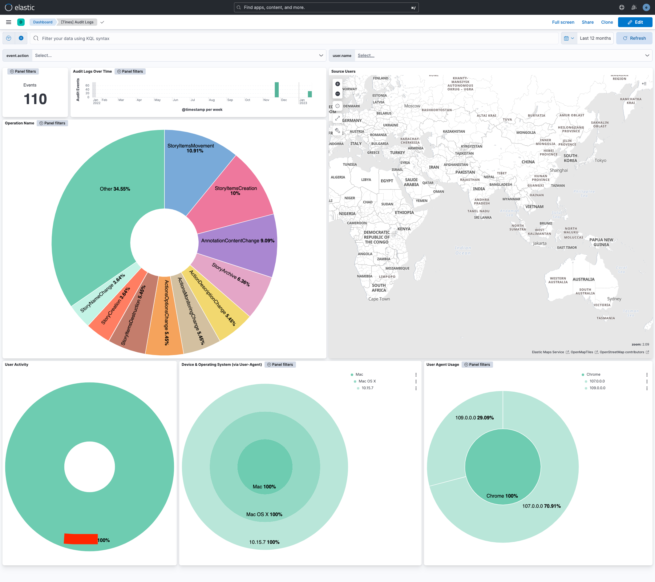

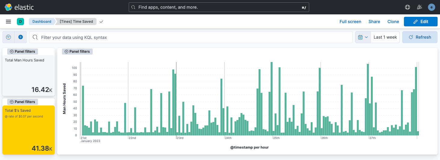

There are two dashboards immediately available as part of the integration.
The Tines Audit Logs summary dashboard,
And the Tines Time Saved dashboard,
