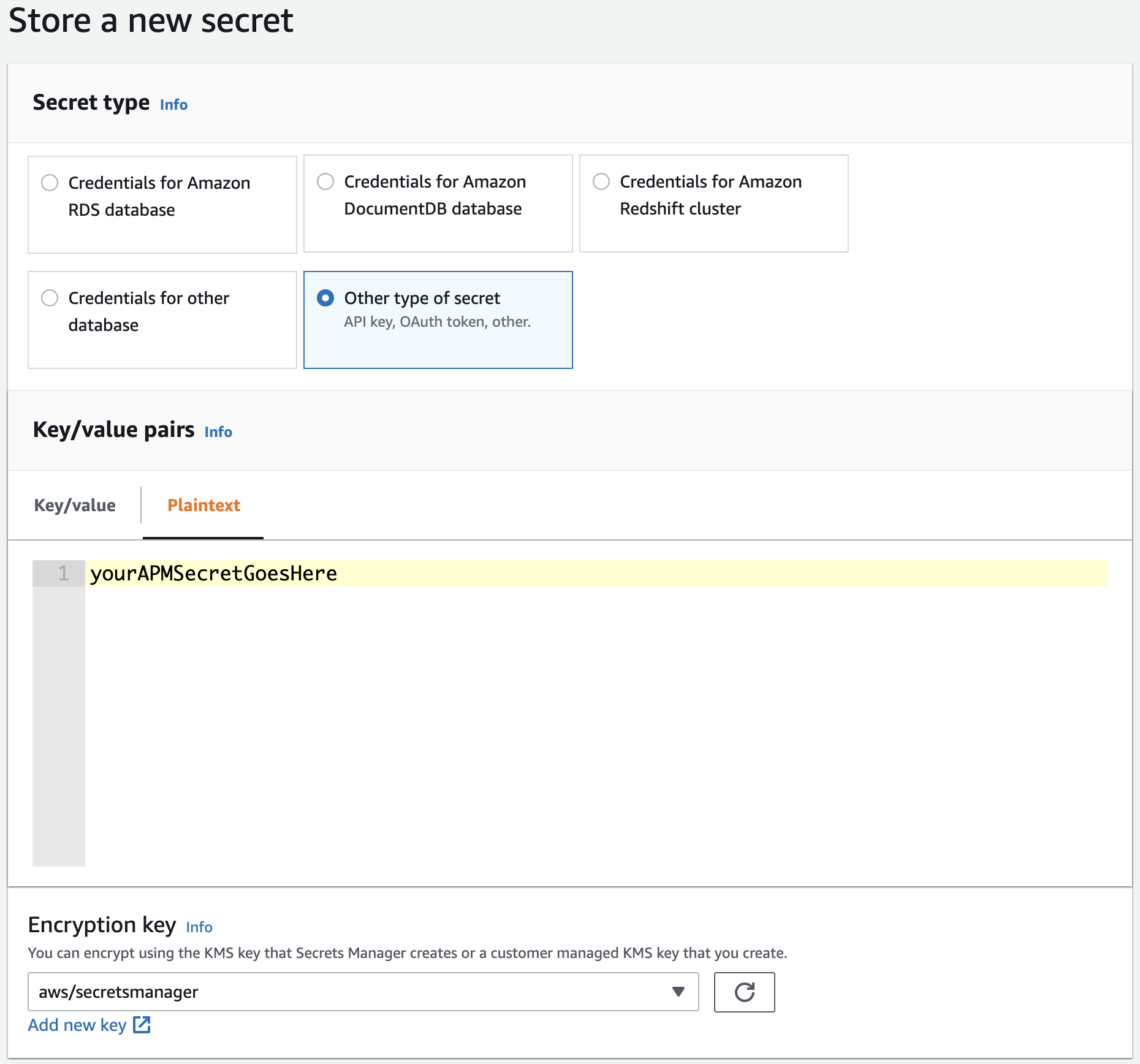

Create a secret in the AWS Secrets Manager for the APM Secret Token or the APM API key, depending on which one you prefer to use. Make sure to create the secret as a Plaintext typed secret and ensure it is created in the same AWS region as your target Lambda function that will use the secret.
We recommend using the AWS-managed encryption key aws/secretsmanager. However, you can optionally create and select a custom KMS key for encryption. Note that with a custom encryption key, you will need additional key permissions on your Lambda function (see Step 2).
In the Web Console of the AWS Secrets Manager, navigate to Store a new secret, select Other type of secret as the secret type, and choose the Plaintext tab for entering the secret value. Enter your APM secret token or APM API key value as a plain string (not as a JSON key value pair).
image showing the creation of a plaintext secret in Secrets Manager
Click Next, choose a secret name, and finalize the creation of the secret.
