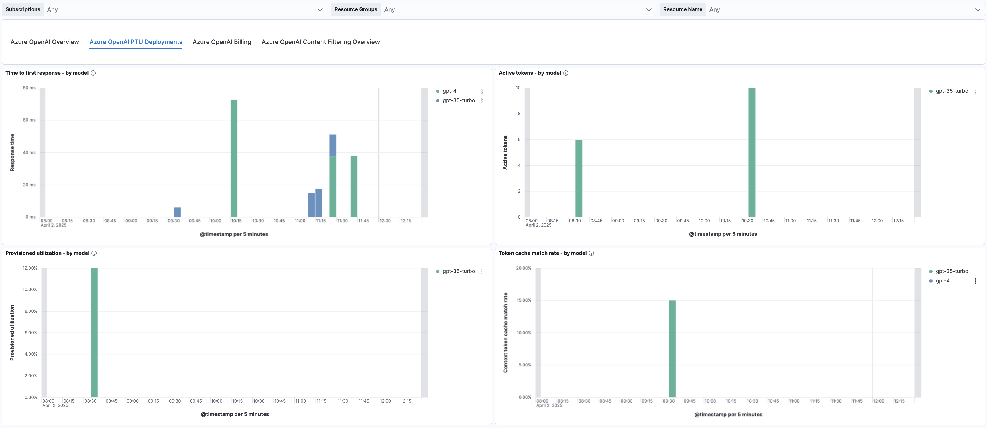

The metrics data stream collects the cognitive service metrics that is specific to the Azure OpenAI service. The metrics that are specific to PTUs will only be available with the provisioned deployments.
For more details on the metrics applicable to PTU only deployment, check the Monitor Azure OpenAI documentaiton.
