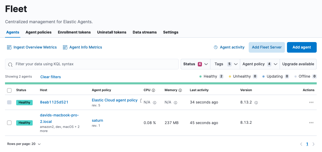

After deploying an Elastic Agent to a host, view details about the agent and inspect the data streams it creates. To learn more about the benefits of using data streams, refer to Data streams.
  1. On the Agents tab in Fleet, confirm that the Elastic Agent status is Healthy.
    Screen showing that agent status is Healthy

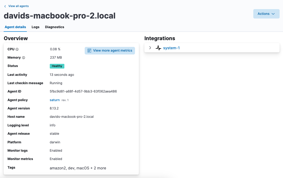

  2. Click the host name to examine the Elastic Agent details. This page shows the integrations that are currently installed, the policy the agent is enrolled in, and information about the host machine:

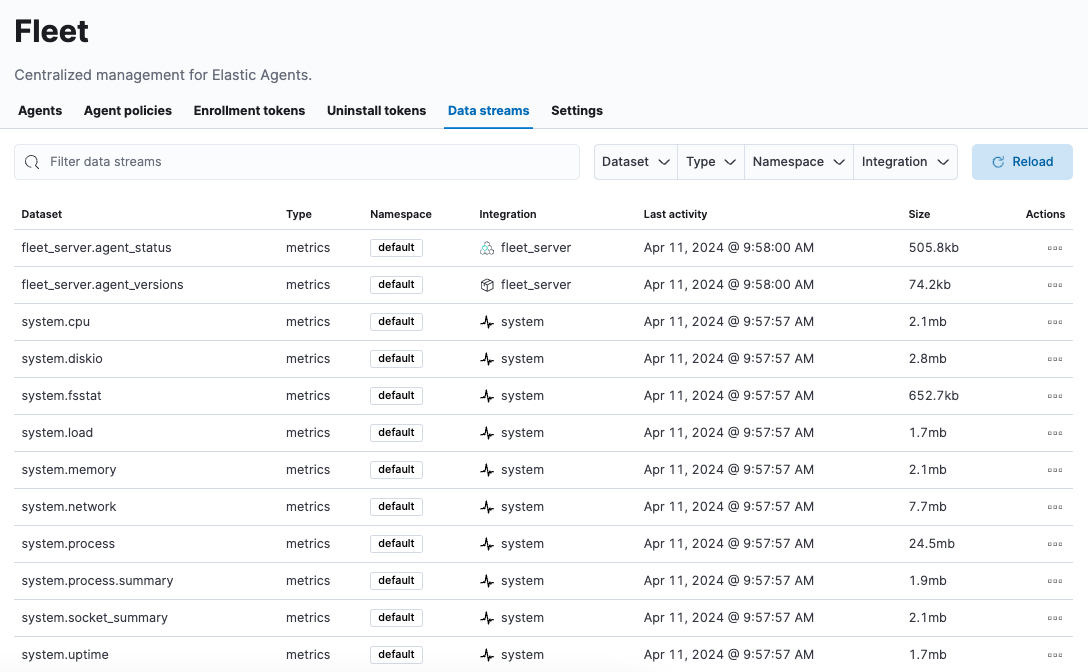

  3. Go back to the main Fleet page and click the Data streams tab. You should be able to see the data streams for various logs and metrics from the host. This is out-of-the-box without any extra configuration or dashboard creation:
    Screen showing data streams created by the {{agent}}

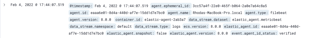

    If Beats are installed on the host machine, the data in Elasticsearch will be duplicated, with one set coming from Beats and another from Elastic Agent for the same data source.
    For example, filter on filebeat-* to see the data ingested by Filebeat.
    Screen showing event from {{filebeat}}
    Next, filter on logs-*. Notice that the document contains data_stream.* fields that come from logs ingested by the Elastic Agent.
    Screen showing event from {{agent}}

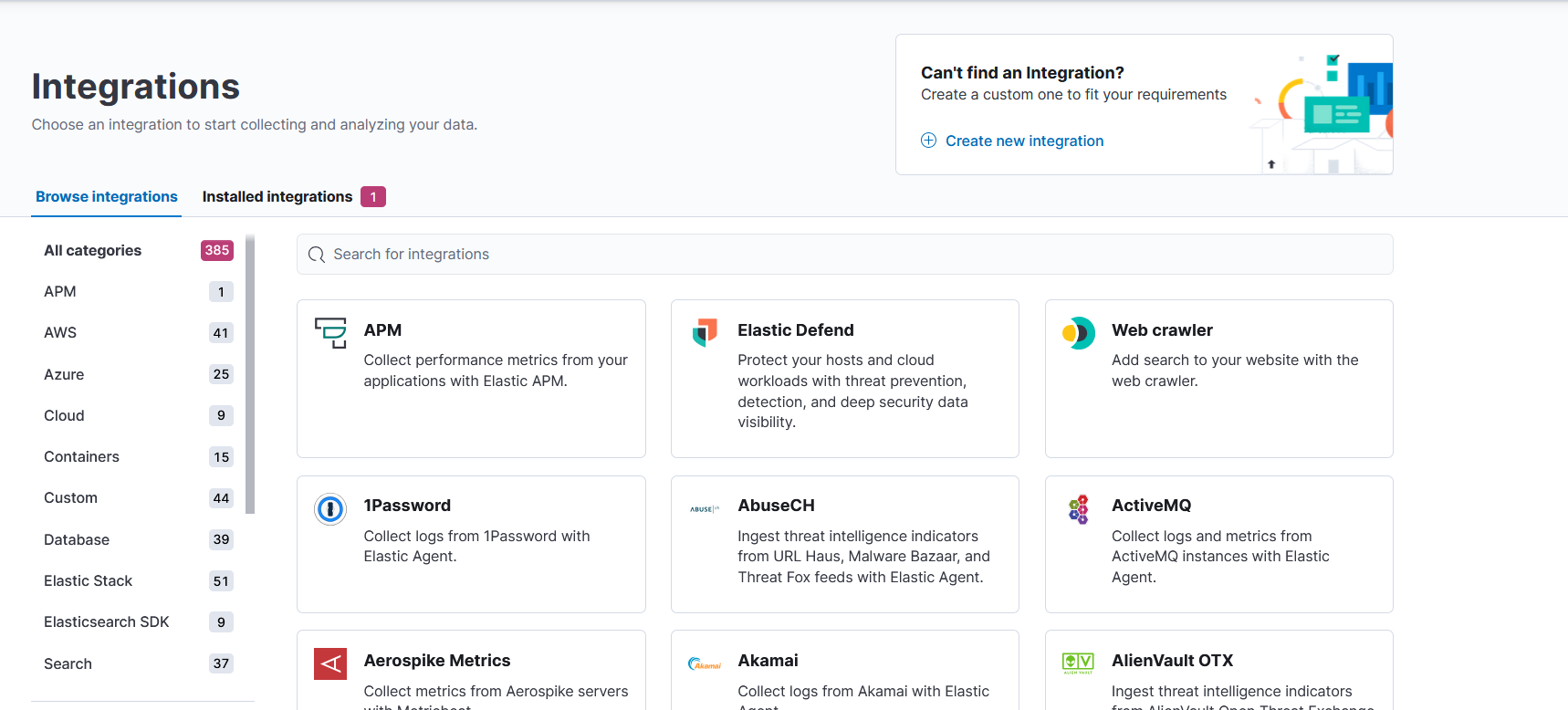

For example, if the agent policy you created earlier includes the System integration, but you also want to monitor Nginx:

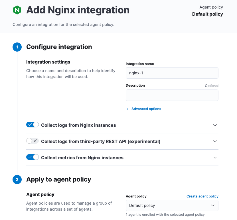

  1. From the main menu in Kibana, click Add integrations and add the Nginx integration.
    Screen showing the Nginx integration
  2. Configure the integration, then apply it to the agent policy you used earlier. Make sure you expand collapsed sections to see all the settings like log paths.
    Screen showing Nginx configuration
    When you save and deploy your changes, the agent policy is updated to include a new integration policy for Nginx. All Elastic Agents enrolled in the agent policy get the updated policy, and the Elastic Agent running on your host will begin collecting Nginx data.

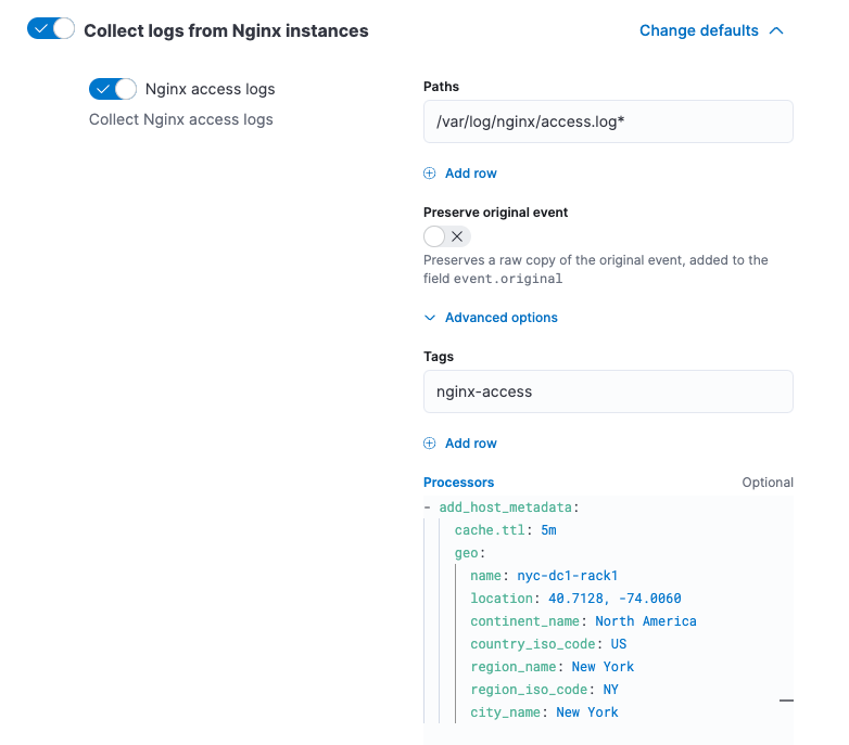

Processors enable you to filter and enhance the data before it’s sent to the output. Each processor receives an event, applies a defined action to the event, and returns the event. If you define a list of processors, they are executed in the order they are defined. Elastic provides a rich set of processors that are supported by all Beats and by Elastic Agent.
Prior to migrating from Beats, you defined processors in the configuration file for each Beat. After migrating to Elastic Agent, however, the Beats configuration files are redundant. All configuration is policy-driven from Fleet (or for advanced use cases, specified in a standalone agent policy). Any processors you defined previously in the Beats configuration need to be added to an integration policy; they cannot be defined in the Beats configuration.
Important
Globally-defined processors are not currently supported by Elastic Agent. You must define processors in each integration policy where they are required.
To add processors to an integration policy:
  1. In Fleet, open the Agent policies tab and click the policy name to view its integration policies.
  2. Click the name of the integration policy to edit it.
  3. Click the down arrow next to enabled streams, and under Advanced options, add the processor definition. The processor will be applied to the data set where it’s defined.
    Screen showing how to add a processor to an integration policy
    For example, the following processor adds geographically specific metadata to host events:

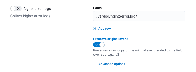

In some cases, Beats modules preserve the original, raw event, which consumes more storage space, but may be a requirement for compliance or forensic use cases.
In Elastic Agent, this behavior is optional and disabled by default.
If you must preserve the raw event, edit the integration policy, and for each enabled data stream, click the Preserve original event toggle.
Do this for every data stream with a raw event you want to preserve.

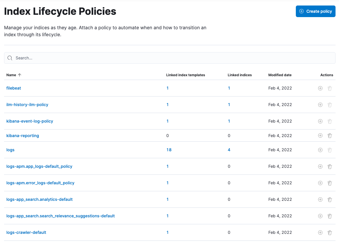

Index lifecycle management (index lifecycle management) policies in Elasticsearch enable you to manage indices according to your performance, resiliency, and retention requirements. To learn more about index lifecycle management, refer to the index lifecycle management documentation.
index lifecycle management is configured by default in Beats (version 7.0 and later) and in Elastic Agent (all versions). To view the index lifecycle policies defined in Elasticsearch, go to Management > Index Lifecycle Policies.
If you used index lifecycle management with Beats, you’ll see index lifecycle policies like filebeat and metricbeat in the list. After migrating to Elastic Agent, you’ll see polices named logs and metrics, which encapsulate the index lifecycle management policies for all logs-* and metrics-* index templates.
When you migrate from Beats to Elastic Agent, you have a couple of options for migrating index policy settings:
  • Modify the newly created index lifecycle policies (recommended). As mentioned earlier, index lifecycle management is enabled by default when the Elastic Agent is installed. Index lifecycle policies are created and added to the index templates for data streams created by integrations.
    If you have existing index lifecycle policies for Beats, it’s highly recommended that you modify the lifecycle policies for Elastic Agent to match your previous policy. To do this:
    1. In Kibana, go to Stack Management > Index Lifecycle Policies and search for a Beats policy, for example, filebeat. Under Linked indices, notice you can view indices linked to the policy. Click the policy name to see the settings.
    2. Click the logs policy and, if necessary, edit the settings to match the old policy.
    3. Under Index Lifecycle Policies, search for another Beats policy, for example, metricbeat.
    4. Click the metrics policy and edit the settings to match the old policy.
    Optionally delete the Beats index lifecycle policies when they are no longer used by an index.
  • Keep the Beats policy and apply it to the index templates created for data streams. To preserve an existing policy, modify it, as needed, and apply it to all the index templates created for data streams:
    1. Under Index Lifecycle Policies, find the Beats policy, for example, filebeat.
    2. In the Actions column, click the Add policy to index template icon.
    3. Under Index template, choose a data stream index template, then add the policy.
    4. Repeat this procedure, as required, to apply the policy to other data stream index templates.
