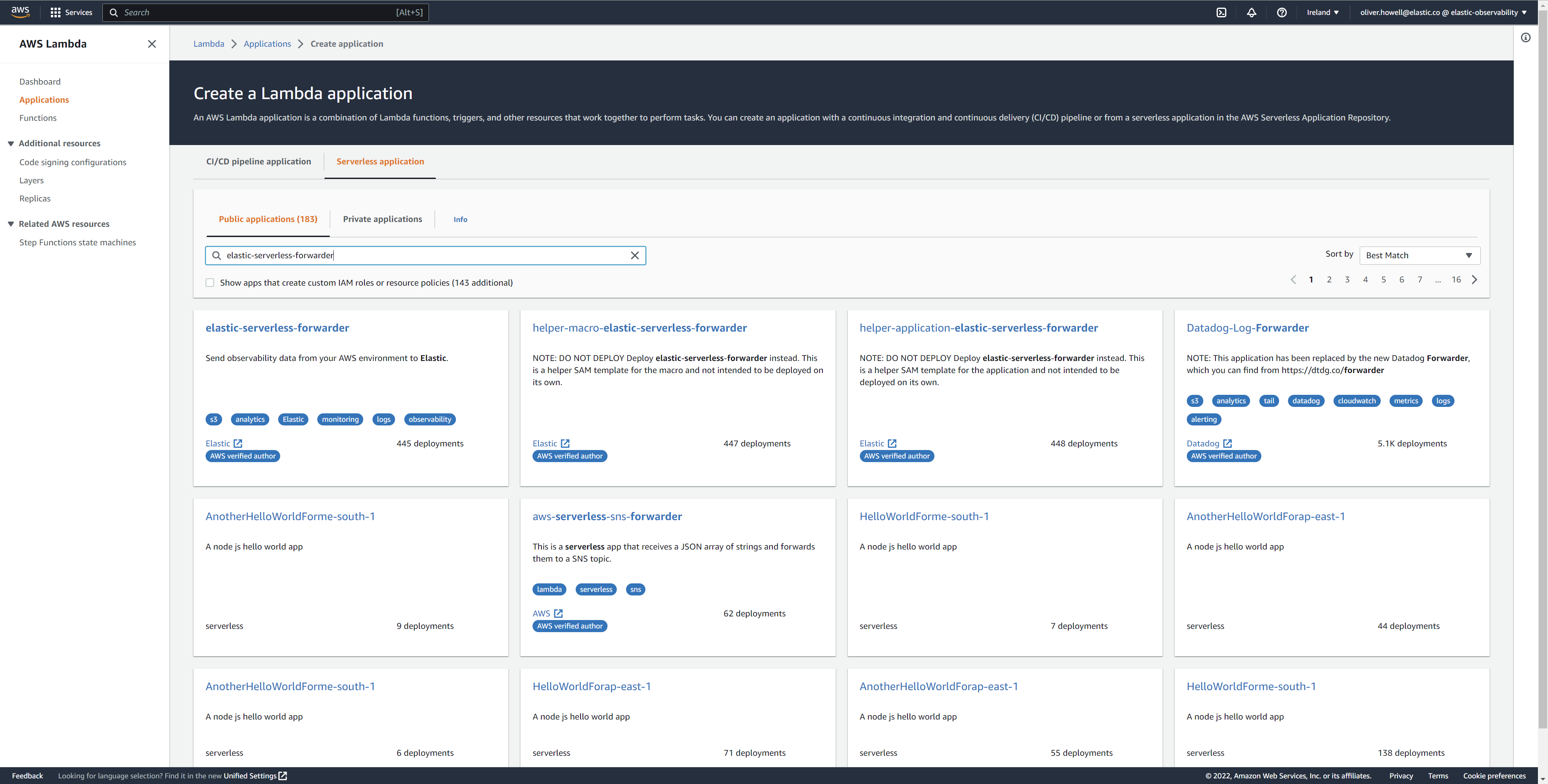

Whichever SAR deployment method you choose, you must define the following parameters correctly for your setup. This section explains the types of parameters and provides guidance on how to set them to match your deployment(s).
These parameters define the general configuration and behaviour for the forwarder.
  • ElasticServerlessForwarderS3ConfigFile: Set this value to the location of your config.yaml in S3 URL format: s3://<YOUR-BUCKET-NAME>/<YOUR-CONFIG-FILE>. This will populate the S3_CONFIG_FILE environment variable for the forwarder.

  1. Log in to AWS console and open Lambda.
  2. Click Applications and then Create application.
  3. Click Serverless application and search for elastic-serverless-forwarder.
  4. Select elastic-serverless-forwarder from the search results (ignoring any application beginning helper-).
    Create Elastic Serverless Forwarder Lambda function within SAR
  5. Complete the Application settings according to Define deployment parameters. You must specify the parameters even if they already exist in the config.yaml file. Depends on the input type, at least one if the parameters ElasticServerlessForwarderSQSEvents, ElasticServerlessForwarderS3SQSEvents, ElasticServerlessForwarderKinesisEvents, ElasticServerlessForwarderCloudWatchLogsEvents should de defined.
  6. After your settings have been added, click Deploy.
