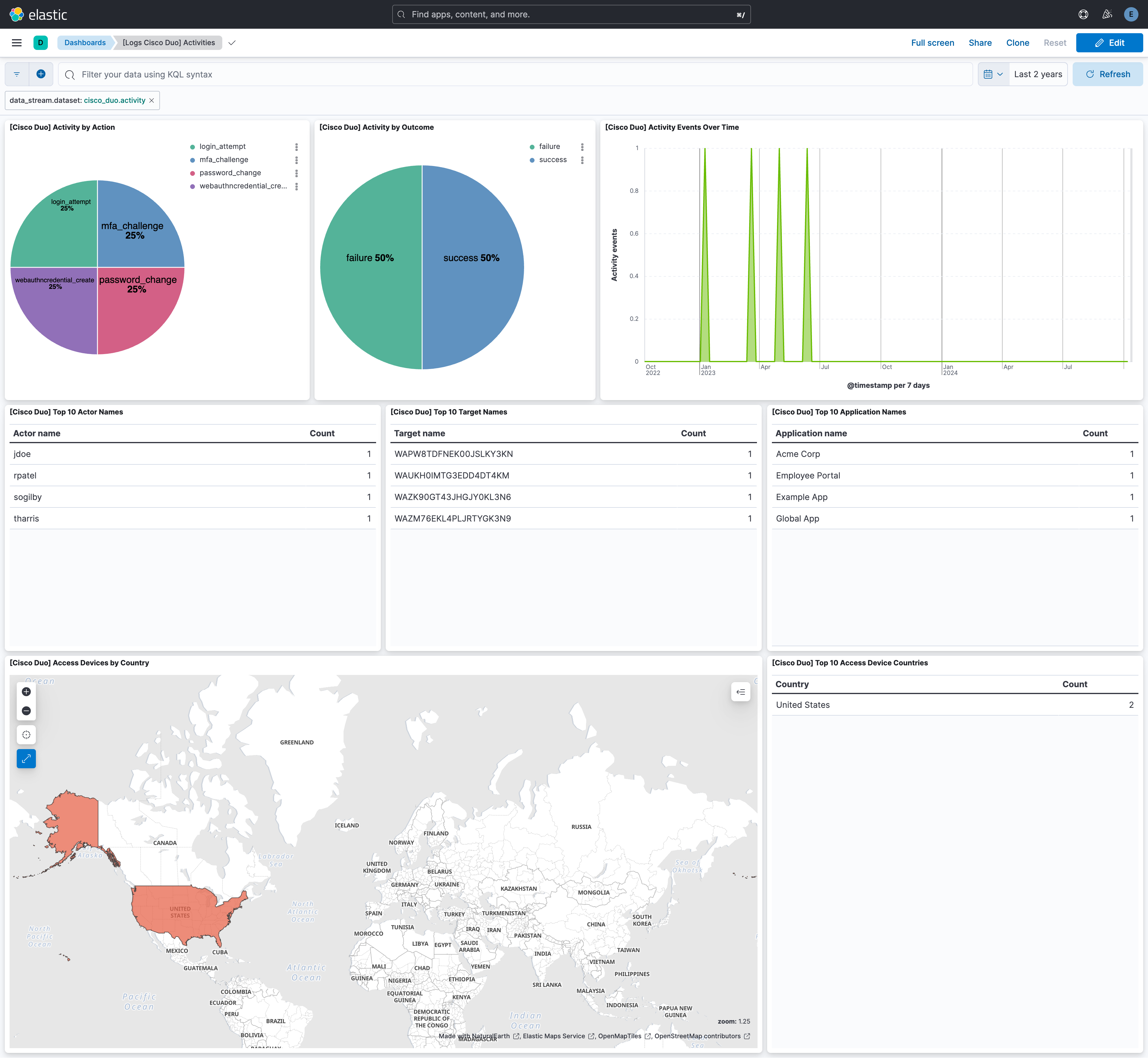

This is the activity dataset.
Example

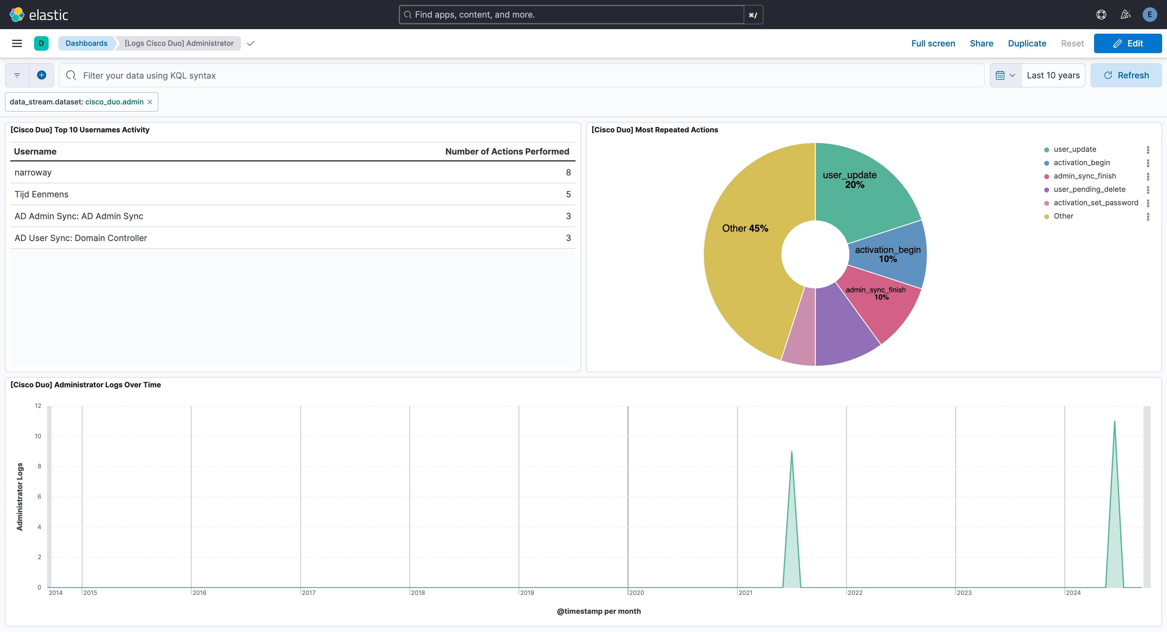

This is the admin dataset.
Example
