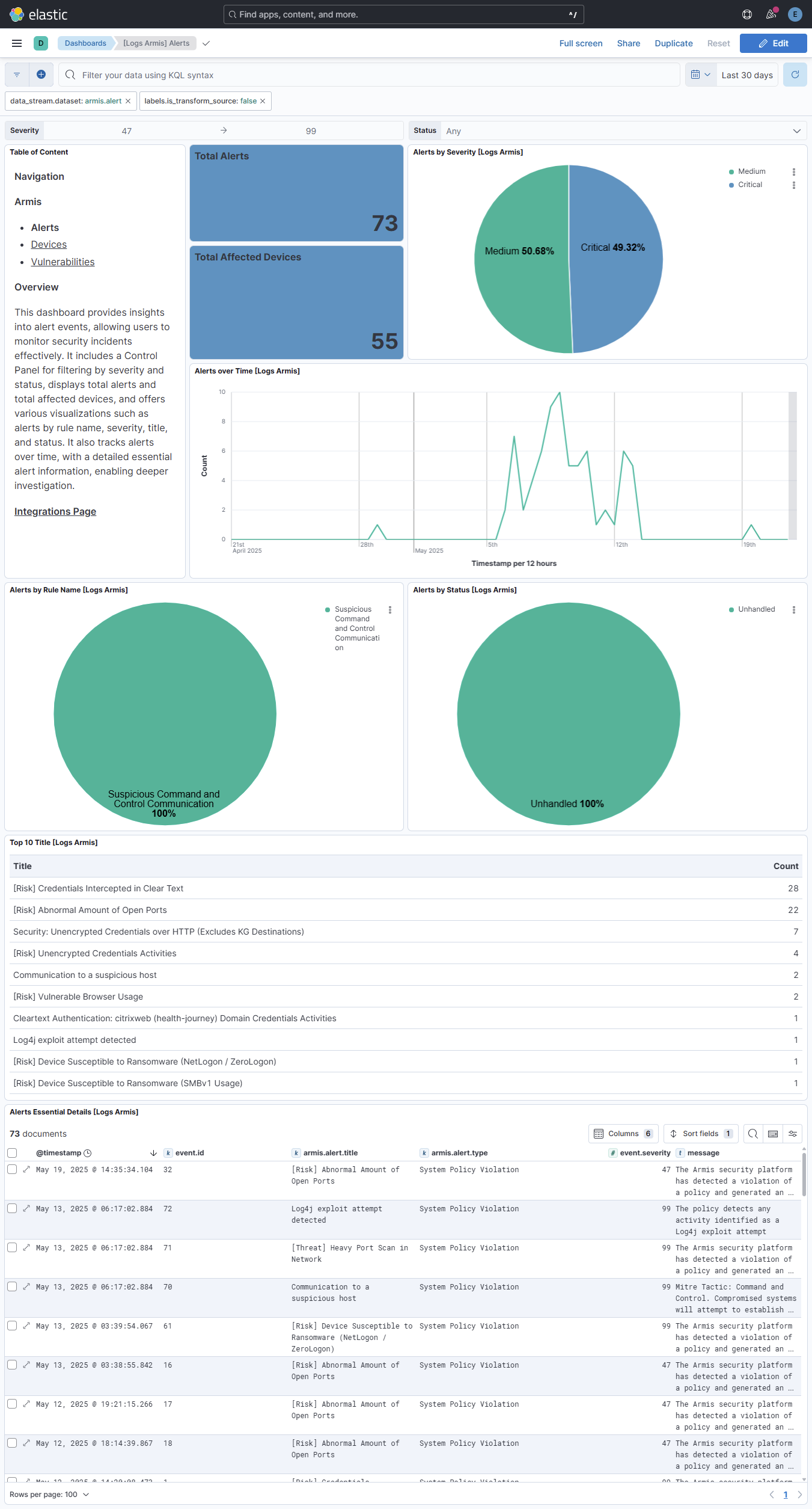

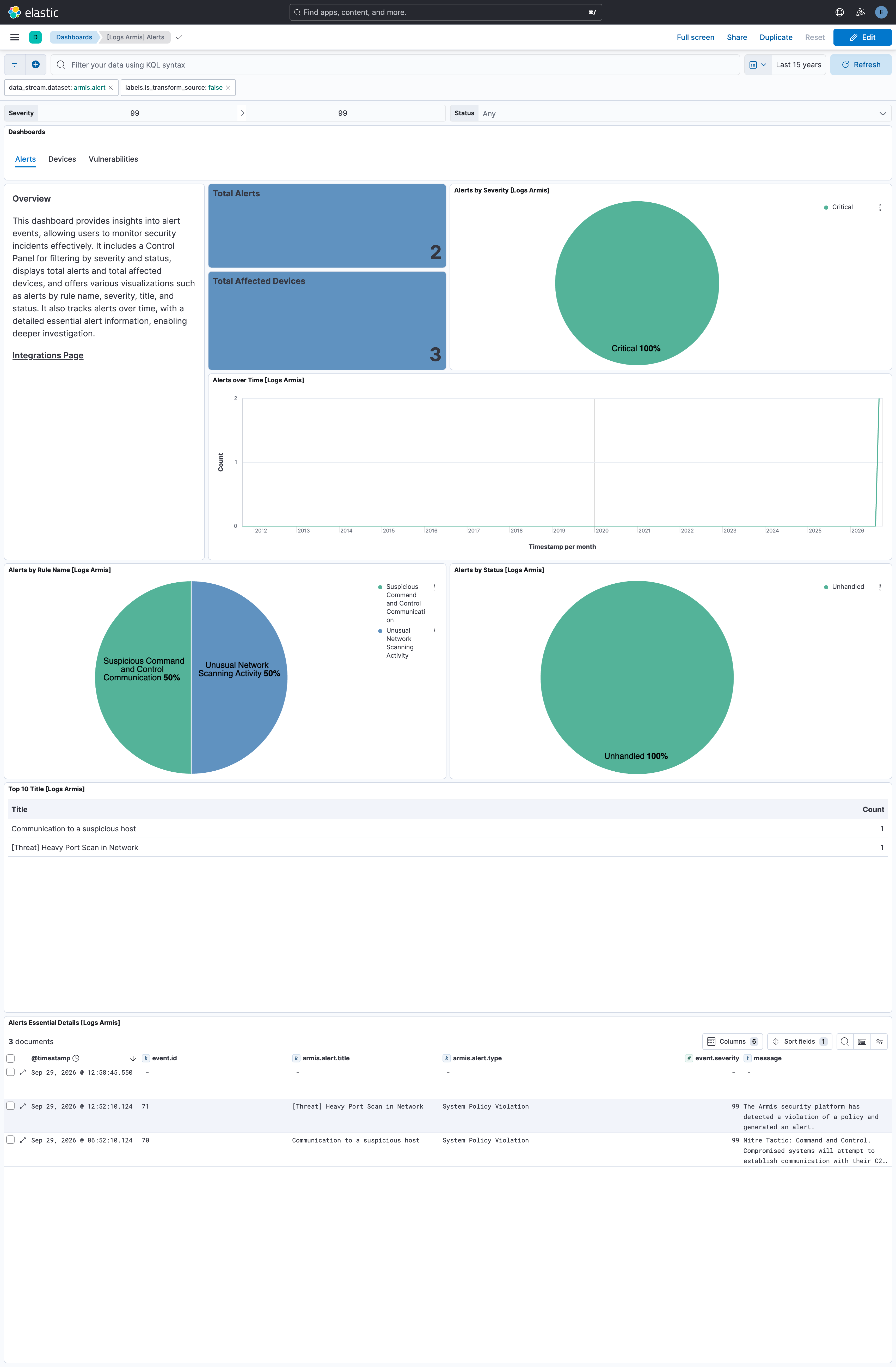

This is the alert dataset.
An example event for alert looks as following:
Example
"@timestamp": "2025-03-29T00:12:57.306Z",
"agent": {
"ephemeral_id": "b8961f6d-527f-4e75-a54e-4440c07d7ff7",
"id": "6e0e7fed-f6da-48e7-aa1c-3ae3eb605196",
"name": "elastic-agent-41603",
"type": "filebeat",
"version": "8.18.0"
"armis": {
"alert": {
"activity_uuids": [
"6f3d6d3a-6732-44cc-9d63-10a38277fb15"
"affected_devices_count": 1,
"alert_id": "61",
"classification": "Security - Other",
"description": "The Armis security platform has detected a violation of a policy and generated an alert.",
"device_ids": [
"854"
"severity": "Critical",
"status": "Unhandled",
"status_change_time": "2025-03-29T00:12:57.306Z",
"time": "2025-03-29T00:12:57.306Z",
"title": "[Risk] Device Susceptible to Ransomware",
"type": "System Policy Violation"
"data_stream": {
"dataset": "armis.alert",
"namespace": "53950",
"type": "logs"
"ecs": {
"version": "8.17.0"
"elastic_agent": {
"snapshot": false,
"version": "8.18.0"
"event": {
"category": [
"intrusion_detection"
"id": "61",
"ingested": "2025-05-23T09:34:03Z",
"kind": "alert",
"original": "{\"activityUUIDs\":[\"6f3d6d3a-6732-44cc-9d63-10a38277fb15\"],\"affectedDevicesCount\":1,\"alertId\":61,\"classification\":\"Security - Other\",\"connectionIds\":[],\"description\":\"The Armis security platform has detected a violation of a policy and generated an alert.\",\"destinationEndpoints\":[],\"deviceIds\":[854],\"lastAlertUpdateTime\":null,\"mitreAttackLabels\":null,\"policyId\":null,\"policyLabels\":null,\"policyTitle\":null,\"severity\":\"Critical\",\"sourceEndpoints\":[],\"status\":\"Unhandled\",\"statusChangeTime\":\"2025-03-29T00:12:57.306928+00:00\",\"time\":\"2025-03-29T00:12:57.306928+00:00\",\"title\":\"[Risk] Device Susceptible to Ransomware\",\"type\":\"System Policy Violation\"}",
"severity": 99,
"type": [
"info"
"host": {
"id": [
"854"
"input": {
"type": "cel"
"message": "The Armis security platform has detected a violation of a policy and generated an alert.",
"observer": {
"product": "Asset Management and Security",
"vendor": "Armis"
"related": {
"hosts": [
"854"
"tags": [
"preserve_original_event",
"preserve_duplicate_custom_fields",
"forwarded",
"armis-alert"
Exported fields

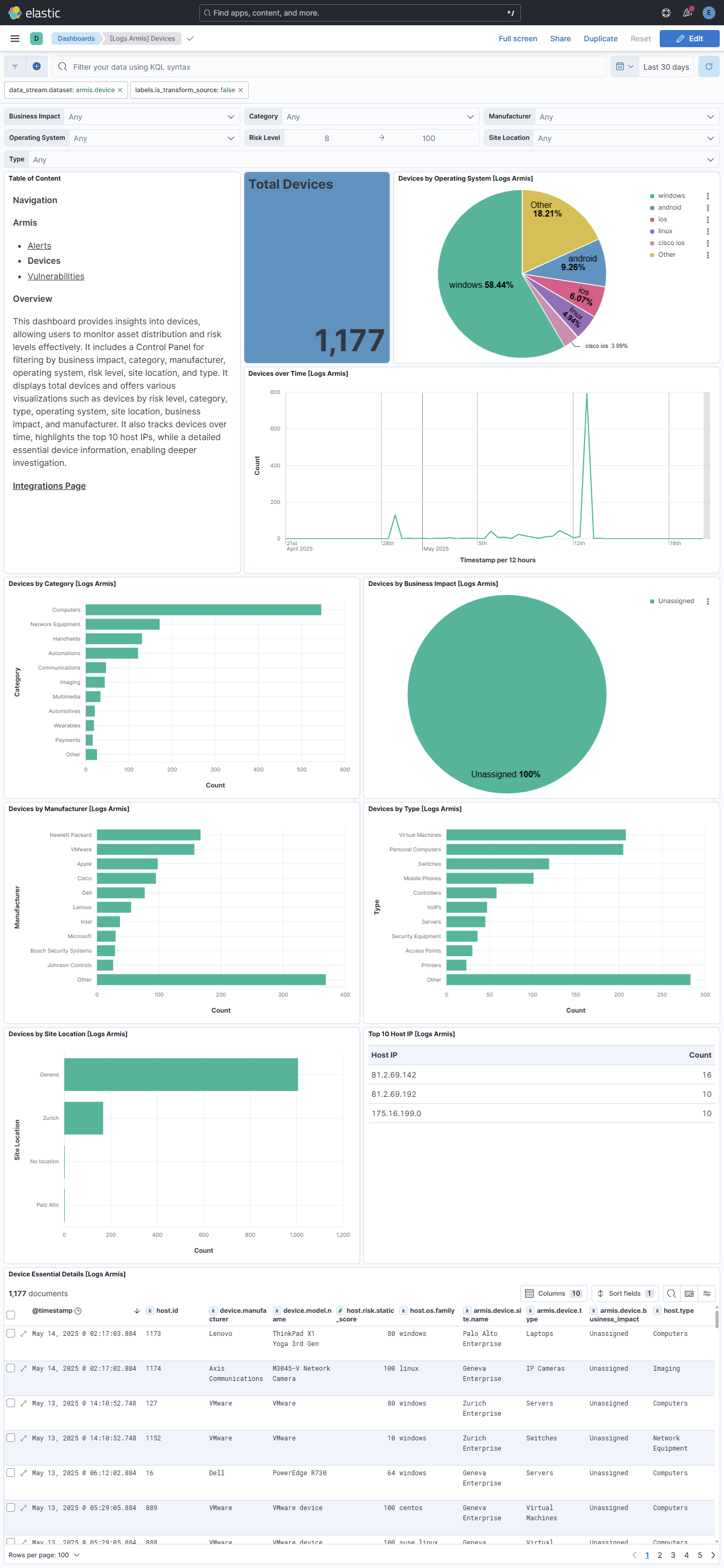

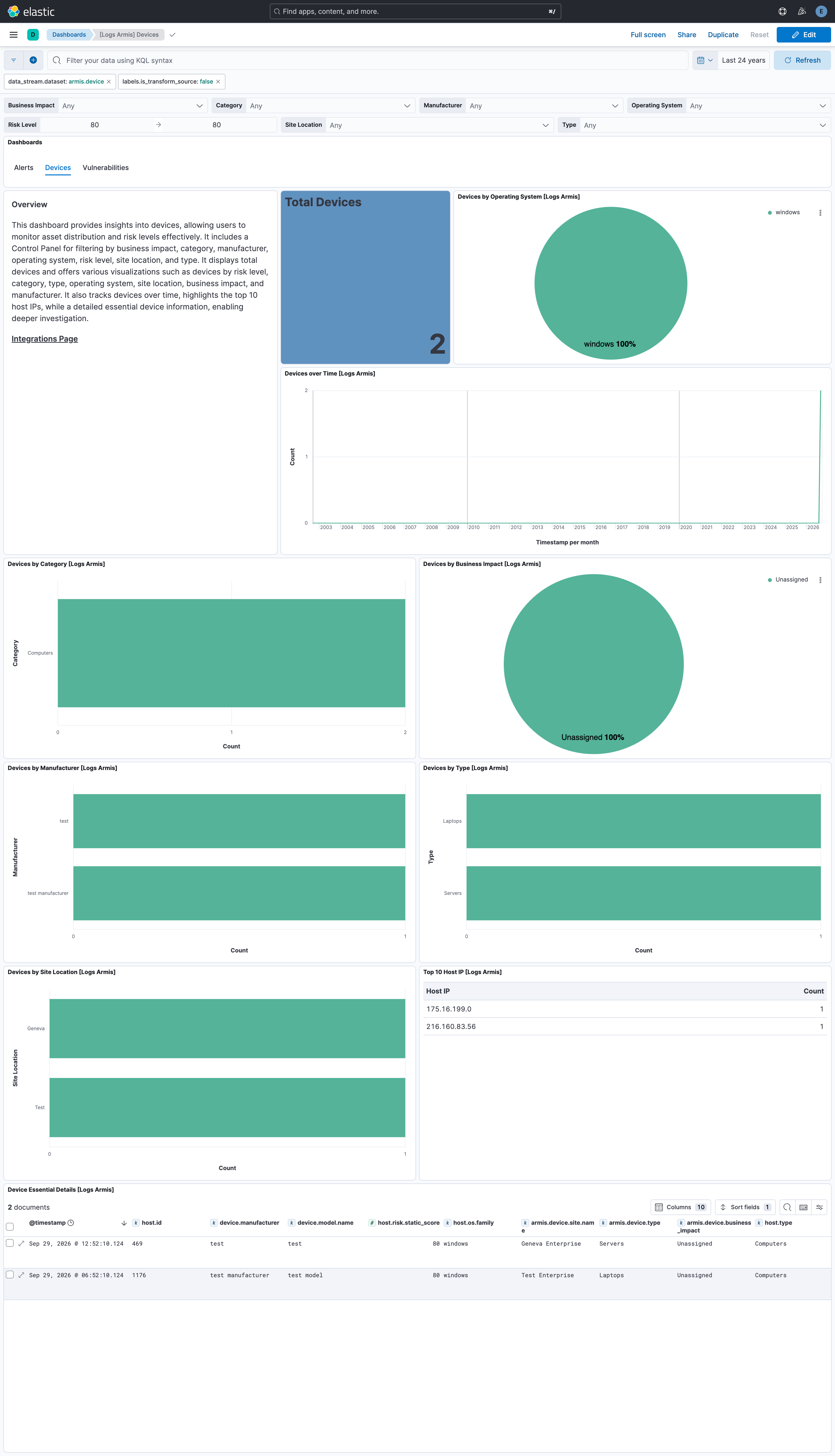

This is the device dataset.
An example event for device looks as following:
Example
"@timestamp": "2025-03-29T10:43:55.988Z",
"agent": {
"ephemeral_id": "79a5a547-4482-4565-8d97-c4beaef9ec06",
"id": "6c6c935d-c274-485e-9f33-edc5f6e46f26",
"name": "elastic-agent-72754",
"type": "filebeat",
"version": "8.18.0"
"armis": {
"device": {
"boundaries": "Corporate",
"business_impact": "Unassigned",
"category": "Network Equipment",
"data_sources": [
"first_seen": "2024-10-09T05:09:02.988Z",
"last_seen": "2025-03-29T10:43:55.988Z",
"name": "Knowledge Base",
"types": [
"Traffic Inspection",
"Data Analysis"
"display_title": "Test",
"id": "1154",
"ip_address": [
"89.160.20.128"
"mac_address": [
"50:76:AF:D3:3F:AB"
"manufacturer": "Test Manufacturer",
"model": "Test Model",
"name": "Test Name",
"names": [
"Test Names"
"operating_system": "Windows",
"operating_system_version": "Server 2016",
"purdue_level": 4,
"risk_level": 10,
"sensor": {
"name": "test Enterprise",
"type": "test LAN Controller"
"site": {
"location": "Zurich",
"name": "Zurich Enterprise"
"tags": [
"Misconfigurations"
"type": "Switches",
"type_enum": "SWITCH",
"visibility": "Full"
"data_stream": {
"dataset": "armis.device",
"namespace": "69402",
"type": "logs"
"device": {
"model": {
"name": "Test Model"
"ecs": {
"version": "8.17.0"
"elastic_agent": {
"snapshot": false,
"version": "8.18.0"
"event": {
"category": [
"host"
"ingested": "2025-05-23T09:34:53Z",
"kind": "event",
"original": "{\"accessSwitch\":null,\"boundaries\":\"Corporate\",\"businessImpact\":\"Unassigned\",\"category\":\"Network Equipment\",\"customProperties\":{},\"dataSources\":[{\"firstSeen\":\"2024-10-09T05:09:02.988081+00:00\",\"instances\":[],\"lastSeen\":\"2025-03-29T10:43:55.988081+00:00\",\"name\":\"Knowledge Base\",\"types\":[\"Traffic Inspection\",\"Data Analysis\"]}],\"displayTitle\":\"Test\",\"firstSeen\":\"2024-10-09T05:09:02.988081+00:00\",\"id\":1154,\"ipAddress\":\"89.160.20.128\",\"ipv6\":[],\"lastSeen\":\"2025-03-29T10:43:55.988081+00:00\",\"macAddress\":\"50:76:AF:D3:3F:AB\",\"manufacturer\":\"Test Manufacturer\",\"model\":\"Test Model\",\"name\":\"Test Name\",\"names\":\"Test Names\",\"operatingSystem\":\"Windows\",\"operatingSystemVersion\":\"Server 2016\",\"protections\":[],\"purdueLevel\":4,\"riskLevel\":10,\"sensor\":{\"name\":\"test Enterprise\",\"type\":\"test LAN Controller\"},\"site\":{\"location\":\"Zurich\",\"name\":\"Zurich Enterprise\"},\"tags\":[\"Misconfigurations\"],\"type\":\"Switches\",\"typeEnum\":\"SWITCH\",\"userIds\":[],\"visibility\":\"Full\"}",
"start": "2024-10-09T05:09:02.988Z",
"type": [
"info"
"host": {
"id": "1154",
"ip": [
"89.160.20.128"
"mac": [
"50-76-AF-D3-3F-AB"
"name": [
"test names"
"os": {
"family": "windows",
"type": "windows",
"version": "Server 2016"
"risk": {
"static_score": 10
"type": "Network Equipment"
"input": {
"type": "cel"
"observer": {
"vendor": "Armis"
"related": {
"hosts": [
