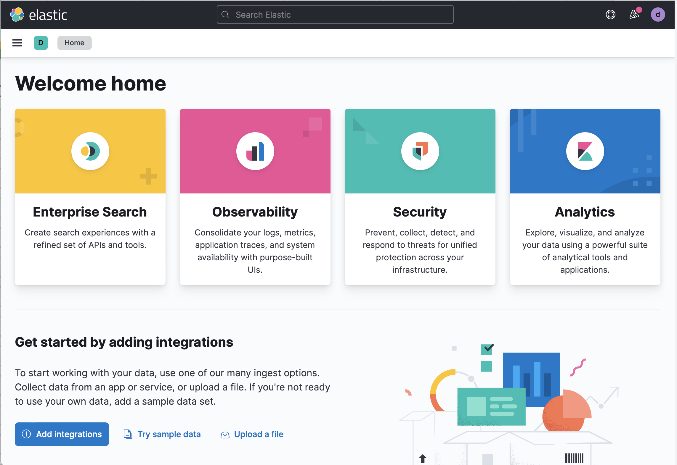

  1. Go to the Kibana home page, and click Add integrations.
    Kibana home page

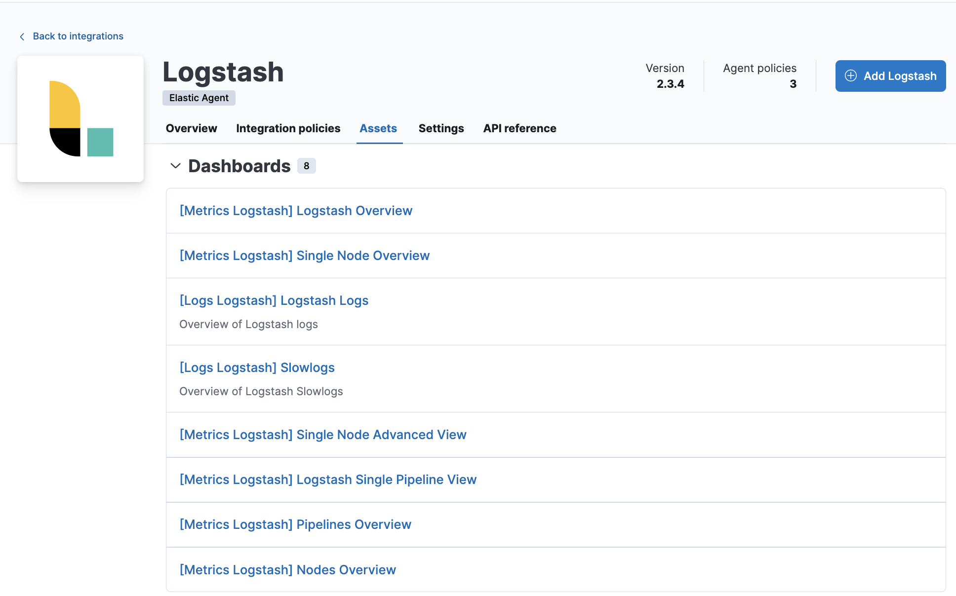

After you have confirmed enrollment and data is coming in, click View assets to access dashboards related to the Logstash integration.
For traditional Stack Monitoring UI, the dashboards marked [Logs Logstash] are used to visualize the logs produced by your Logstash instances, with those marked [Metrics Logstash] for metrics dashboards. These are populated with data only if you selected the Metrics (Elastic Agent) checkbox.
Integration assets
A number of dashboards are included to view Logstash as a whole, and dashboards that allow you to drill-down into how Logstash is performing on a node, pipeline and plugin basis.
