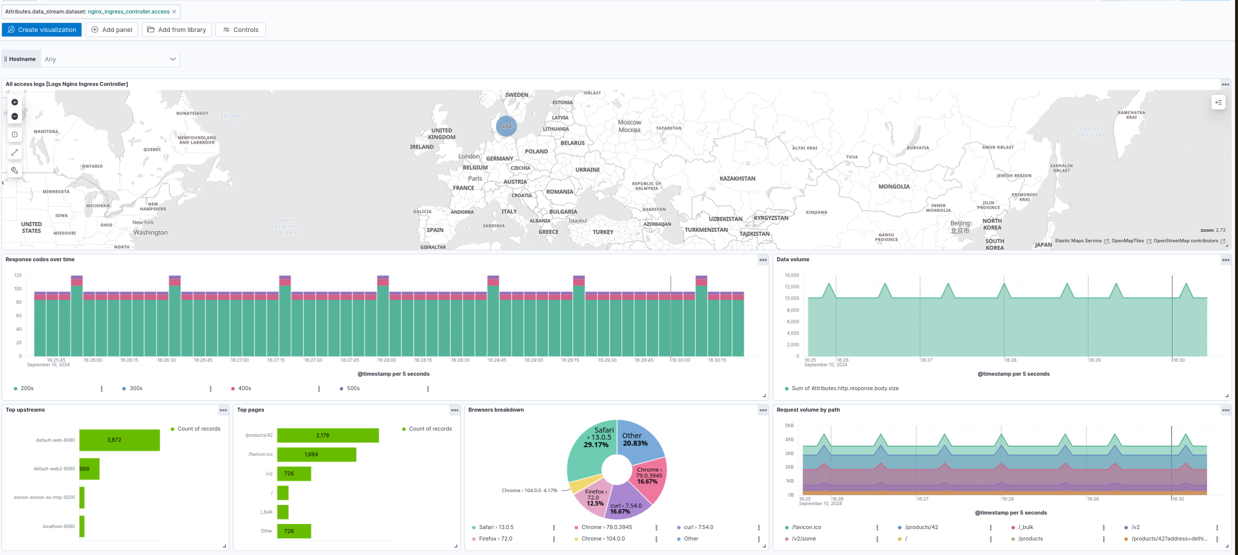

The Geographical IP metadata for incoming Nginx Ingress controller requests is disabled by default. To enable it, you need to provide a local GeoIP database path in the processors' configuration:
  1. Uncomment the GeoIP processors configuration:
geoip:
 context: record
 providers:
   maxmind:
     database_path: /tmp/GeoLite2-City.mmdb
  1. Include the processors in the logs pipeline:
processors: [transform/parse_nginx_ingress_access/log, transform/parse_nginx_ingress_error/log, geoip, resourcedetection/system]

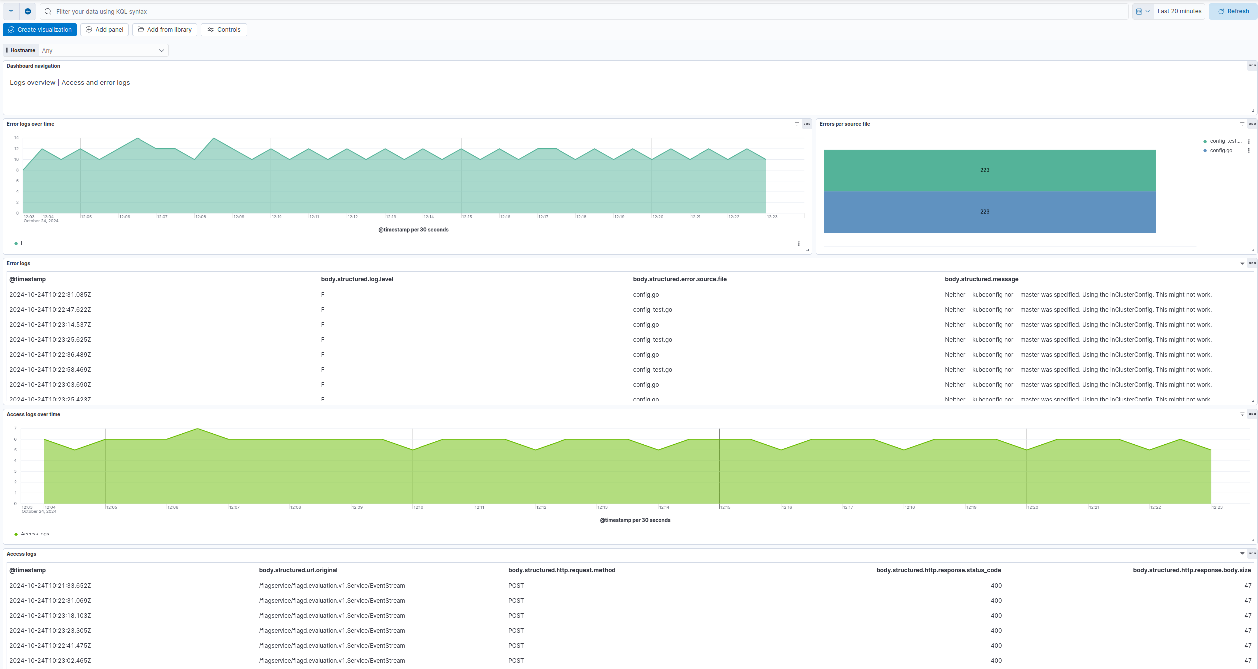

The access data stream collects the Nginx Ingress Controller access logs.
The error data stream collects the Nginx Ingress Controller error logs.
