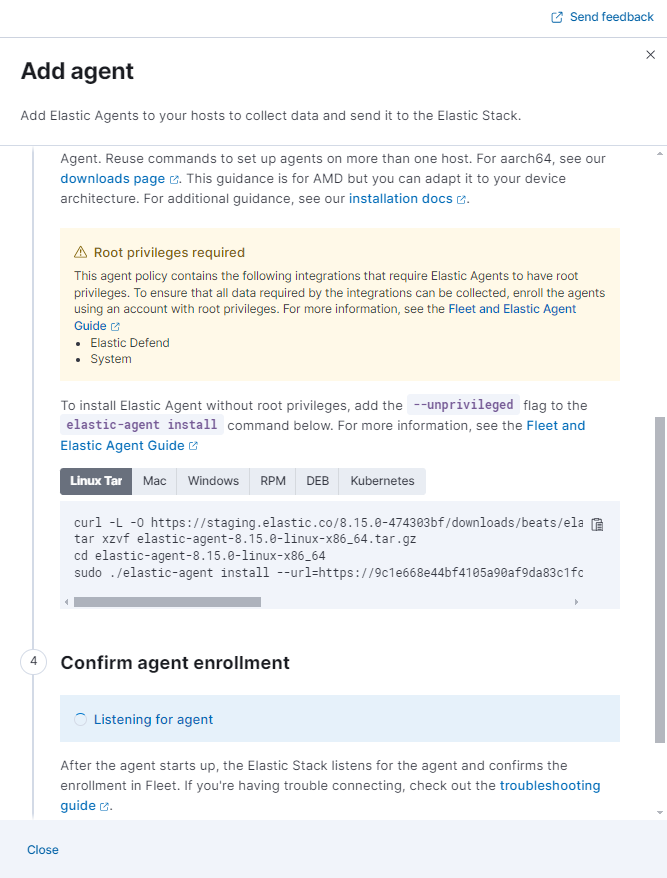

Make sure Enroll in Fleet is selected.
Download, install, and enroll the Elastic Agent on your host by selecting your host operating system and following the Install Elastic Agent on your host step. The commands shown are for AMD platforms, but ARM packages are also available. Refer to the Elastic Agent downloads page for the full list of available packages.
If you are enrolling the agent in a Fleet Server that uses your organization’s certificate you must add the
--certificate-authoritiesoption to the command provided in the in-product instructions. If you do not include the certificate, you will see the following error: "x509: certificate signed by unknown authority".Beginning with version 9.0, Elastic Agent packages are available in multiple flavors. The default, "basic" flavor contains the components required for most use data collection use cases. A "servers" flavor is also available with additional components. You can adjust the
elastic-agent installcommand as required to choose a different flavor. Refer to Elastic Agent installation flavors for details.
After about a minute, the agent will enroll in Fleet, download the configuration specified in the agent policy, and start collecting data.

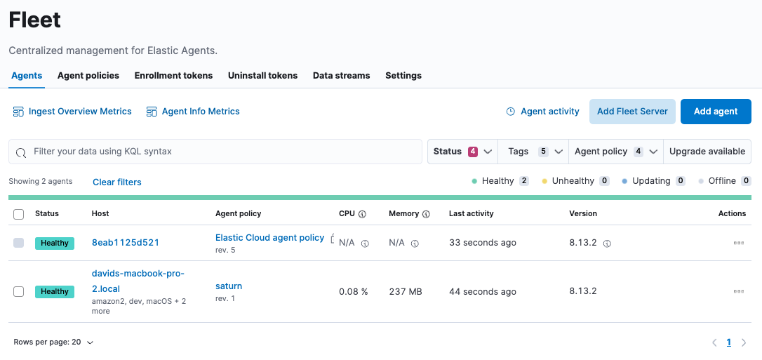

To confirm that Elastic Agent is installed and running, open the Agents tab in Fleet.
If the status hangs at Enrolling, make sure the elastic-agent process is running.
