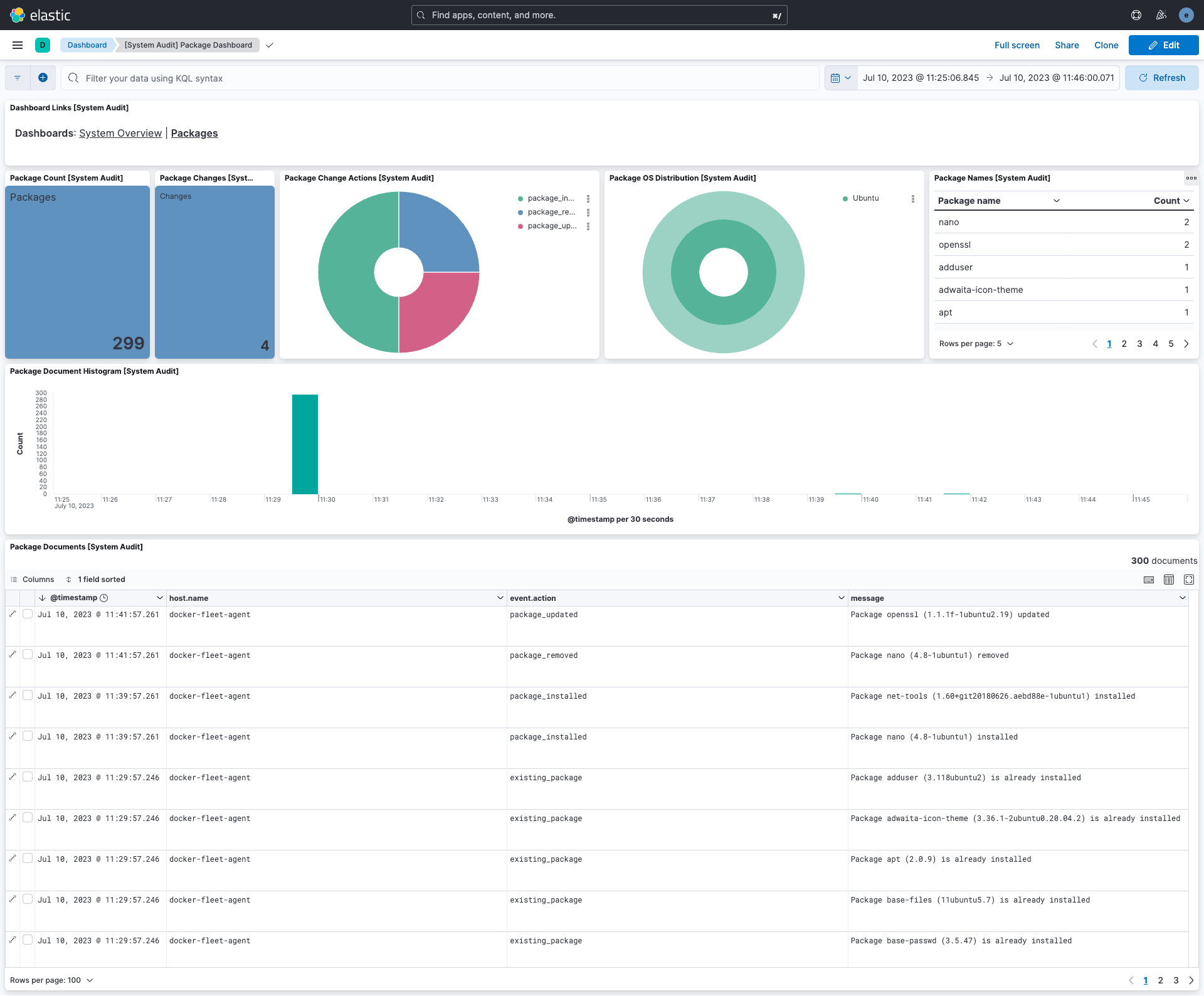

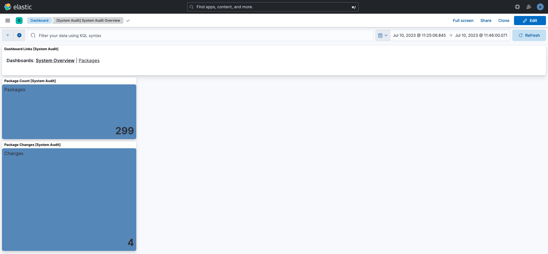

The integration comes with a package & audit system dashboard for easy identification of events and data overview :
Package Dashboard:
System Audit Dashboard:
