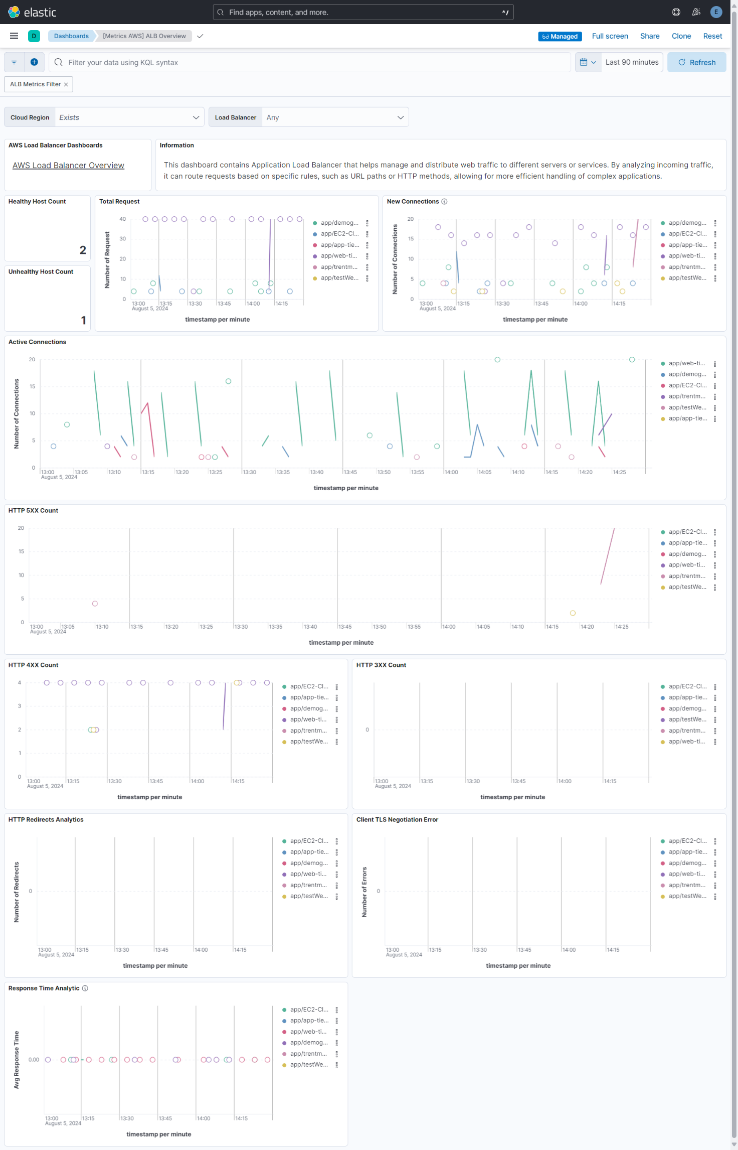

The Amazon ELB integration allows you to monitor Amazon Elastic Load Balancing (ELB)—a tool that distributes application traffic to multiple targets.
Use the Amazon ELB integration to collect logs and metrics with detailed information about requests sent to the load balancer. Then visualize that data in Kibana, create alerts to notify you if something goes wrong, and reference those logs and metrics when troubleshooting an issue.
For example, you could use this data to analyze traffic patterns, view healthy and unhealthy hosts, and track connection and backend errors.

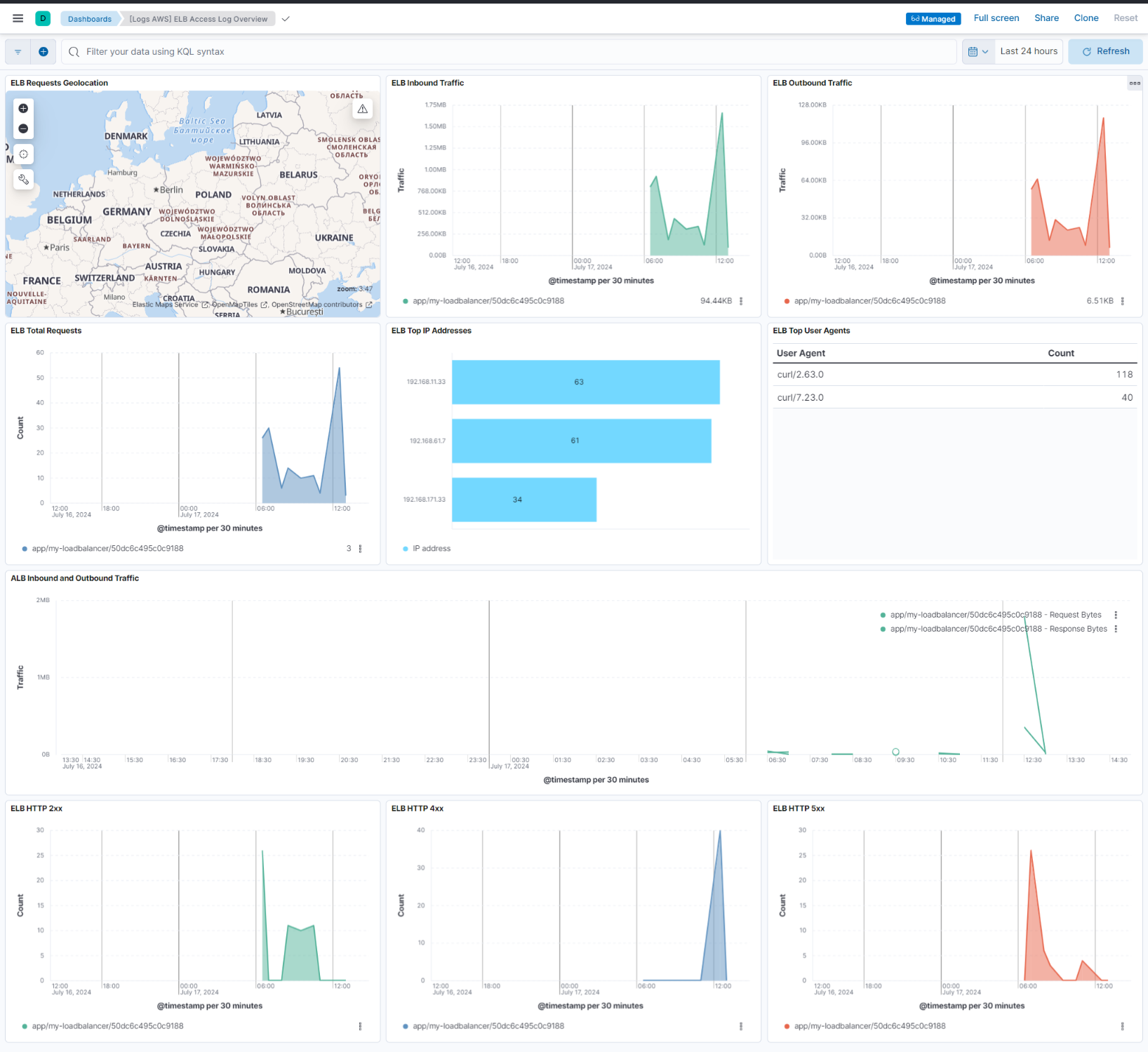

Logs help you keep a record of events happening in Amazon ELB. Logs collected by the Amazon ELB integration include the time a request was received, the client's IP address, latencies, request paths, server responses, and more. See more details in the Logs reference.

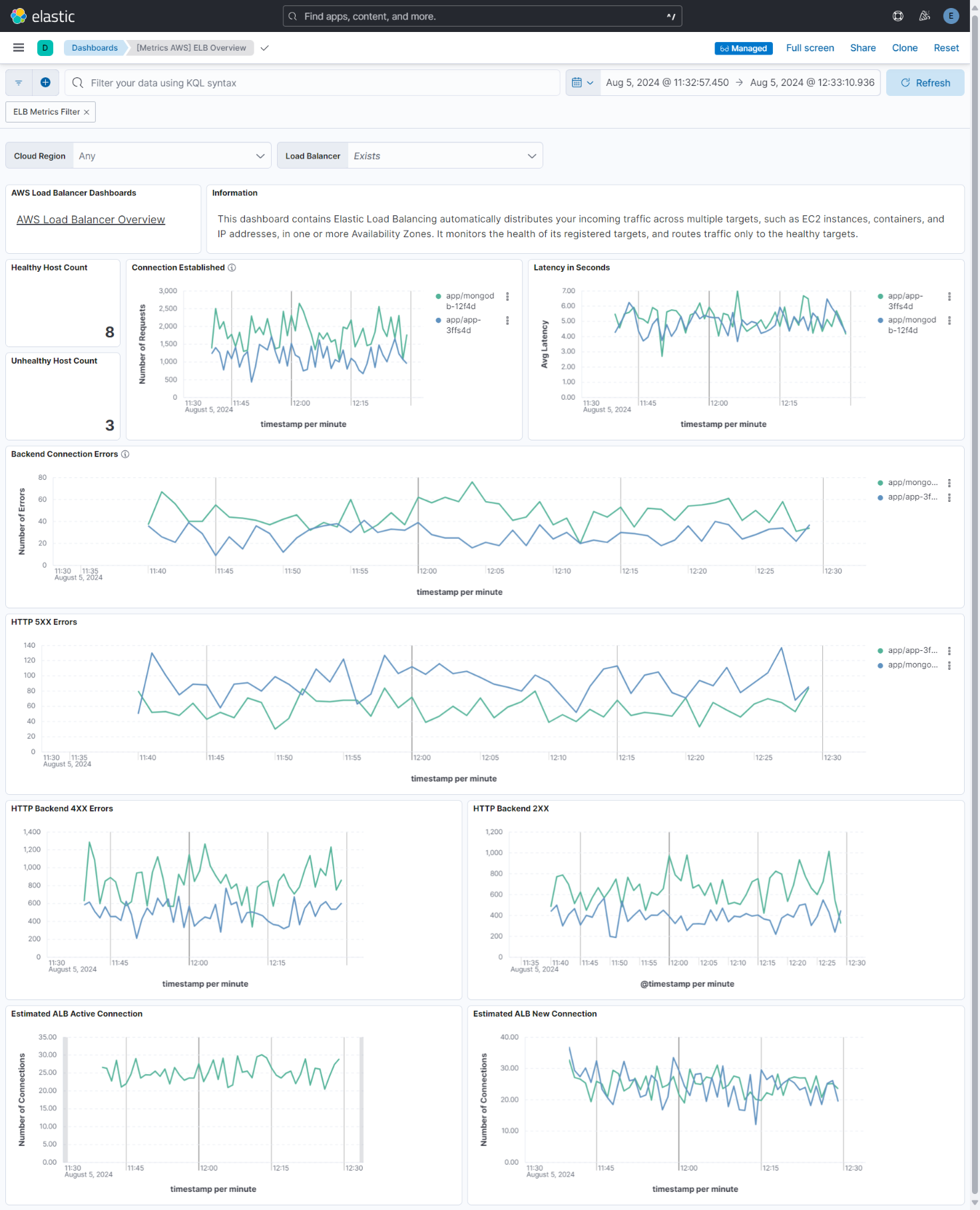

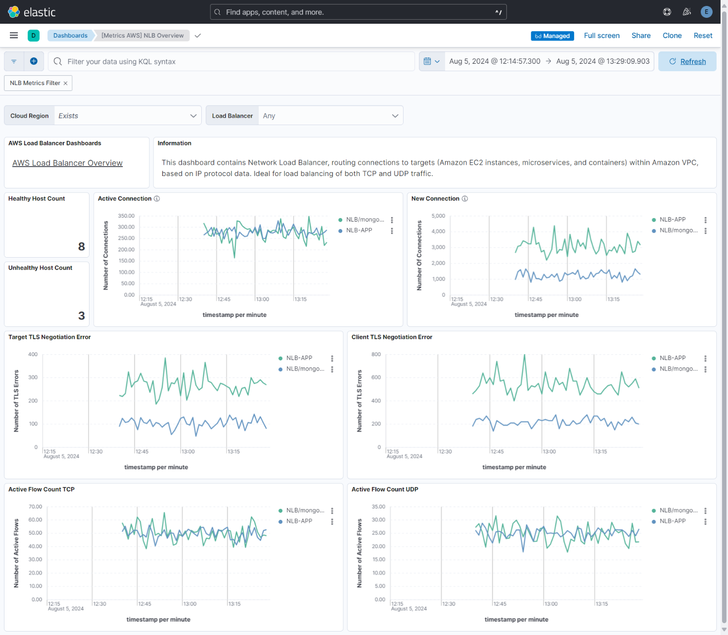

Metrics give you insight into the state of Amazon ELB. Metrics collected by the Amazon ELB integration include the host name, IP address, average latency, and more. See more details in the Metrics reference.

To send classic ELB access logs to an S3 bucket, see enable access logs for classic load balancer.
For an application load balancer, see enable access log for application load balancer and enable connection log for application load balancer.
For a network load balancer, see enable access log for network load balancer.

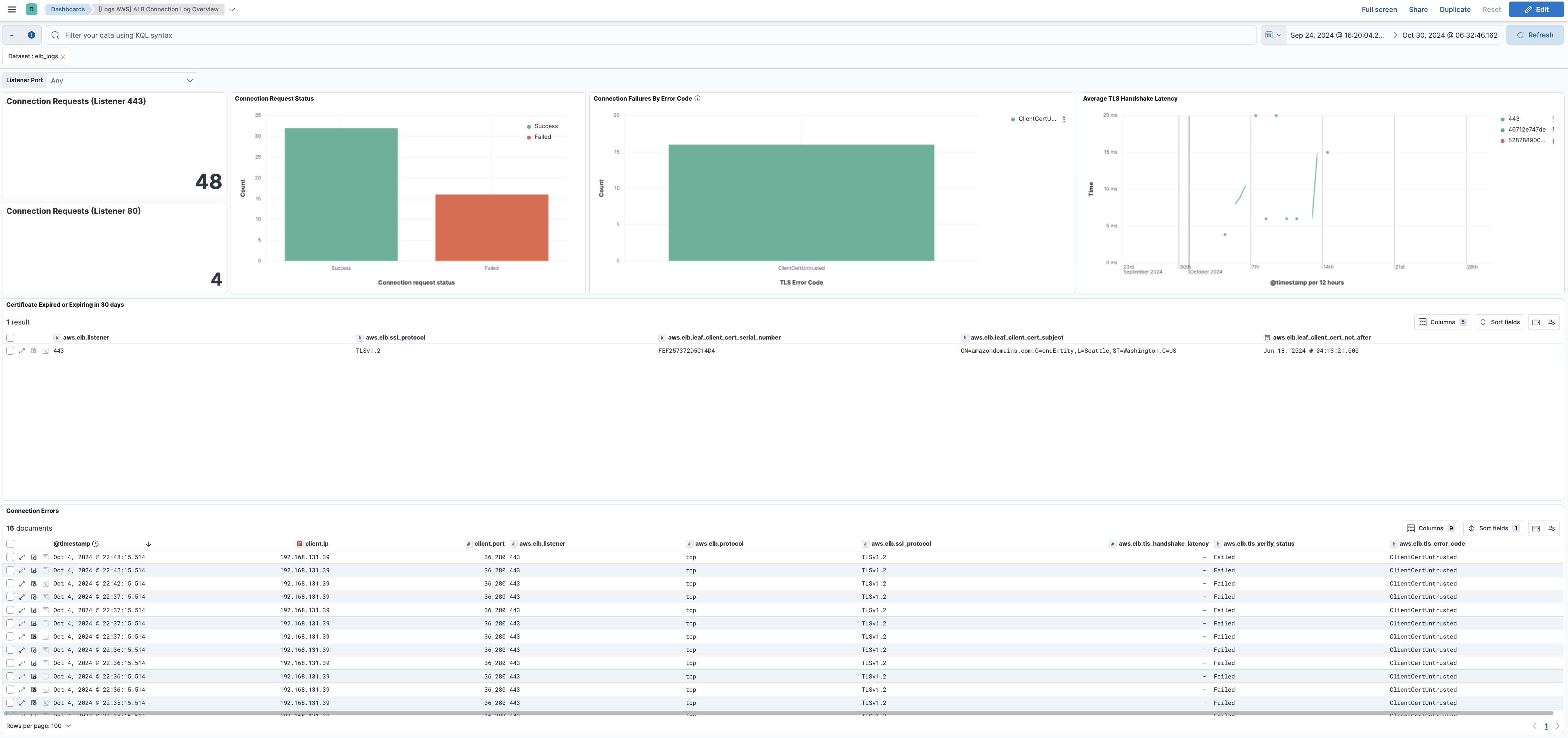

| aws.elb.error.reason | The error reason if the executed action failed. | keyword |
| aws.elb.incoming_tls_alert | The integer value of TLS alerts received by the load balancer from the client, if present. | keyword |

| aws.elb.tls_connection_creation_time | The time recorded at the beginning of the TLS connection. | date |
| aws.elb.tls_error_code | The reason recorded when the load balancer fails to establish a connection, stored as a code in the connection log. | keyword |
| aws.elb.tls_handshake_latency | The total time in seconds, with a millisecond precision, elapsed while establishing a successful handshake. | long |
| aws.elb.tls_handshake_time.ms | The total time for the TLS handshake to complete in milliseconds once the connection has been established. | long |
| aws.elb.tls_named_group | The TLS named group. | keyword |
| aws.elb.tls_verify_status | The status of the connection request. This value is Success if the connection is established successfully. On an unsuccessful connection the value is Failed. | keyword |
