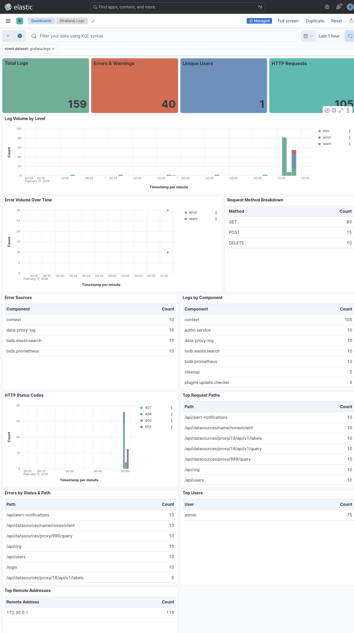

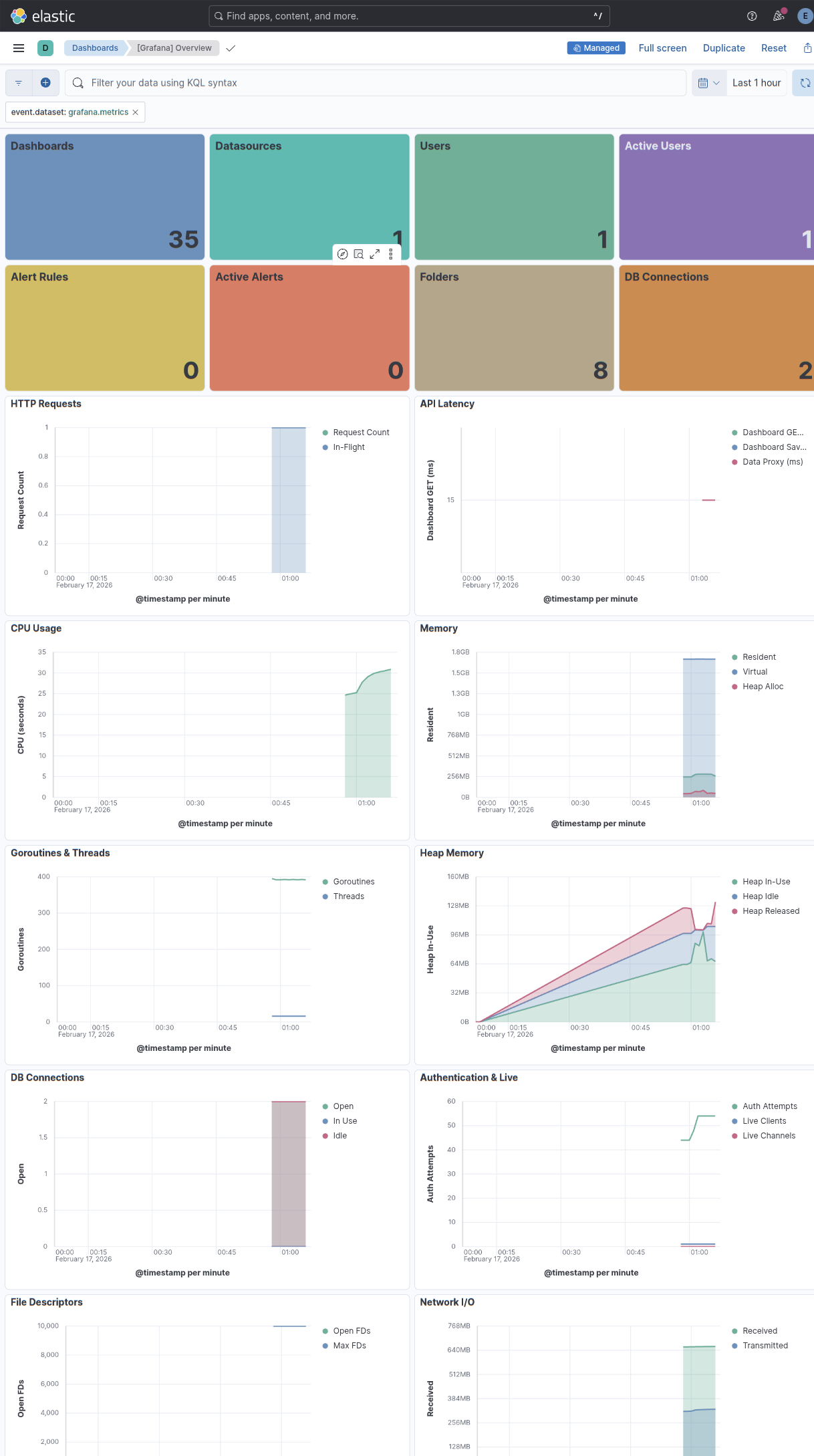

- Add the Grafana integration in Fleet.
- Configure the Grafana Hosts to point at your Grafana instance(s), for example
http://grafana:3000. - For logs, set the Log Paths to the location of your Grafana log file(s), for example
/var/log/grafana/grafana.log. - If your
/metricsendpoint requires authentication, provide the Username and Password.
The integration includes two dashboards:
- [Grafana] Overview — Instance stats, CPU, memory, goroutines, file descriptors, database connections, and alerting status.
- [Grafana] Logs — Log volume by level, top error messages, component breakdown, HTTP status codes, and request paths.
