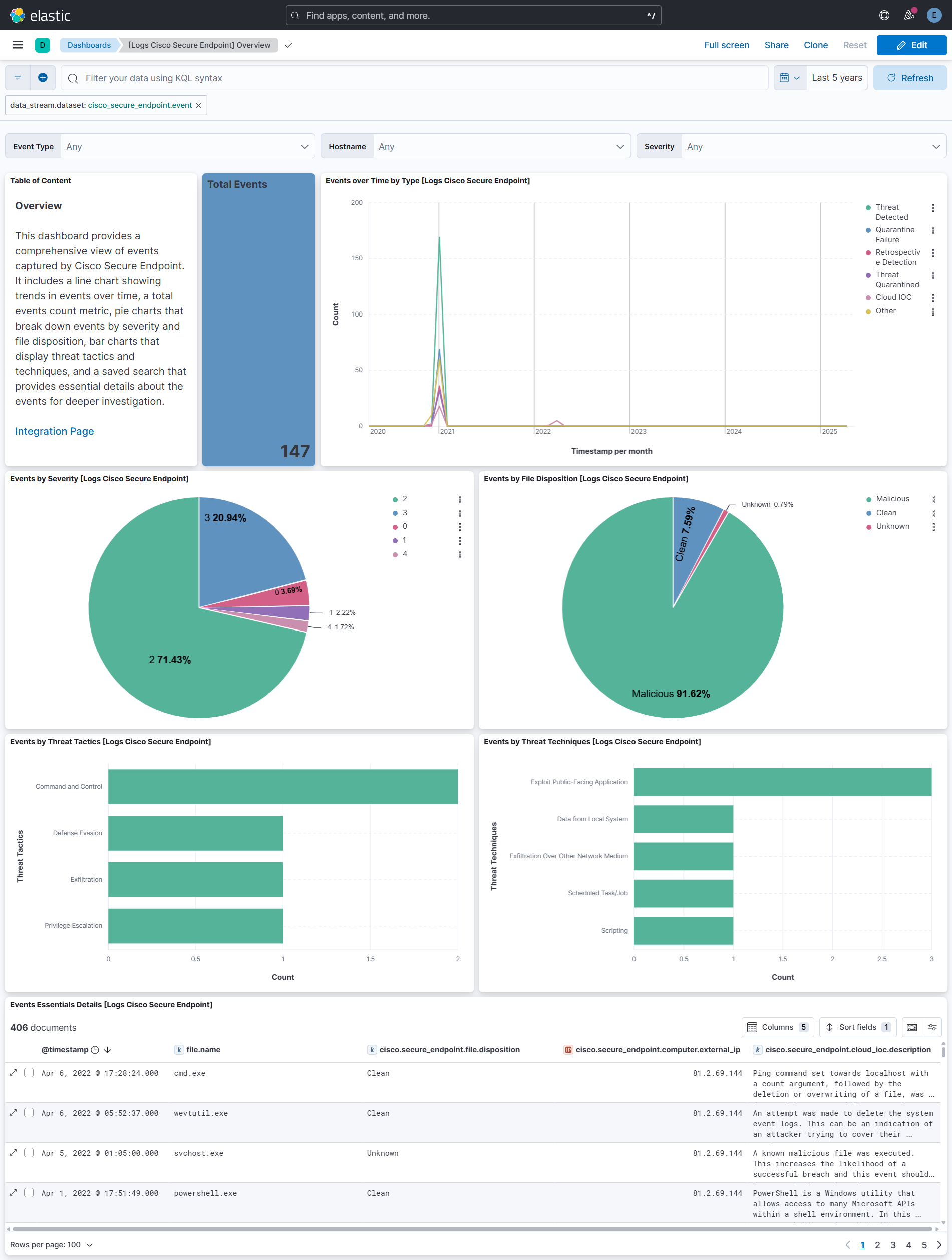

| 2.30.0 | Enhancement (View pull request) Add dashboard. |
